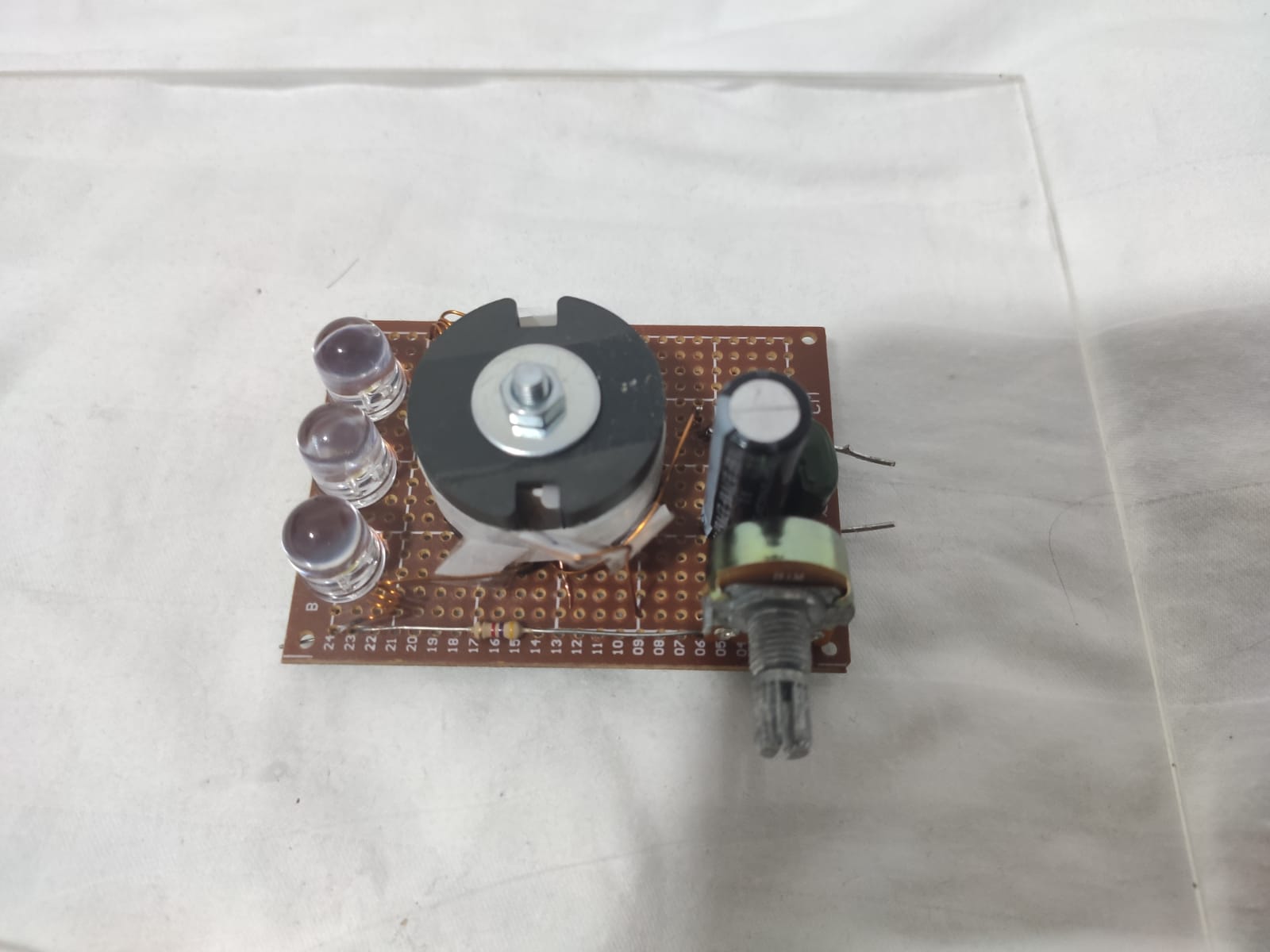

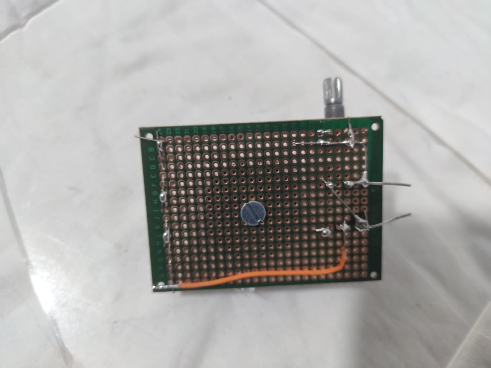

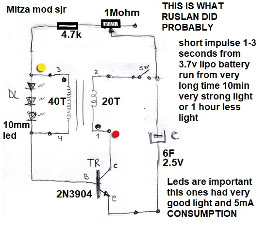

I hope you find it usefull this is most probably what ruslan did . if you have questions i am here guys so lets go to work . i was busy lately with my job so i diid not post much i am working also on kapanadze akula device but is going slowly .i will open another thread for kapagen akula with new infos. . but this is very interesting little device.

Hello guys i am happy you find it usefull and that maybe it helps for forther projects is not a complicated device and still is amazing . my opinion is that ruslan dose this but on akula i am sure his device use uA CONSUMPTION because this device at minimum setings the light is still prety visible and it take some hundreds of uA . SO this goes from 150 uA-10mA maybe 20 mA AT Maximum so it takes a while to finish the capacitor . so keep up the good work and lets improve more.

Now about the device that you have showed, as far as I know based on the internet schematics that akula posted, it doesn't resemble what akula did, because of one important component: the main capacitor. You used a 6 Farad cap versus akula who used at maximum a 2.2 mF cap. That is 2727 times more capacitance used in your device which is not fair, in my opinion, to judge and reduce his device to just that (an energy acumulator). At most we can say your device resembles lasersabers device
which also has nothing to do with akula or ruslan for that matter. Just as a funfact, Lasersaber uses a 1F cap. More research needs to be done.
Hi Vasile salut , first i did not present the device as free energy or something just as eficient ,i speak also with ruslan on facebook but he vas very ambigous , ruslan was an answer to akula , what akula did lantern no 4 he used ferosresonance there and he used 1000 uF capacitors in his device where one was above 50 or 60v is very important cose is not seen as load by the supply and charge very fast from the back impulses , but his light is very small and with time the core get hot a little and changes the frequency and go out of resonance because of that . but in akula lantern the power is minimal even my flashlight at that light akula used i can do it also with 1000 uF capacitor i think he have uA there consuming with the leds . so about ruslan he cheated alot with some of his videos . specialy his flashlight the one with 3 leds you can see the light dimming slowly so he have a supercap for sure ,akula was genuine but ruslan i don think so..

I think the best thing we can do in this case is to use small incandescent lights, because leds can be very deceiving. You can power up an led with uA as you said and also when showing light output, the camera you use for filming can distort the light in a "favourable" way and the viewer sees an intensity completly different than what you would see with your own eyes face-to-face with the device.
I also have a vibe of distrust from ruslan but he makes some interesting points. The general idea that I got from him relating to how his devices might work is that he created an unbalance in his circuit and the environment, somehow, thru the phisical ground wire, balanced the circuit and that is where the "free" energy came from. If I where to make an educated guess I would say he "grabes" electrostatic charges from the ground.
