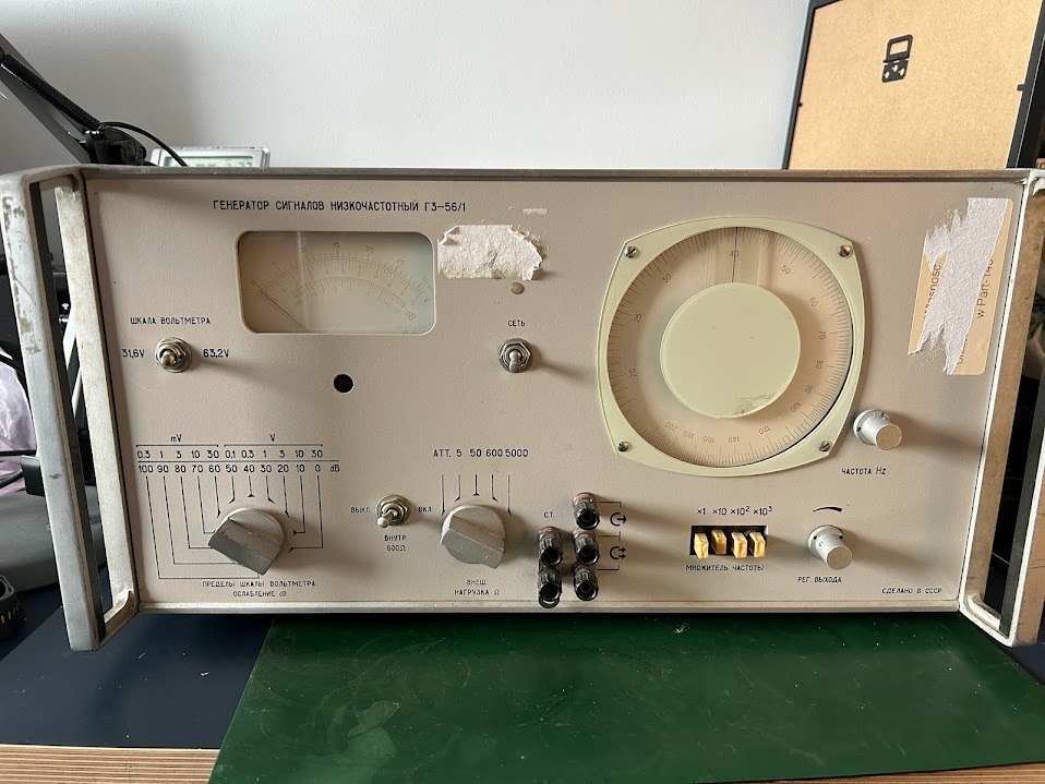

Jagau,
The article is very interesting. To cut to the chase, I focused on the Measurement section.
Avramenko's "AC voltage source is a sound generator G3-56/1". The total frequency range is 20 Hz to 200 kHz.
The D208 refers to a Soviet-era general-purpose silicon alloy diode: Д208
Peak Reverse Voltage: 300 V.
Average Forward Current: 100 mA.
Operating Frequency: Up to 1 kHz for standard operation, though it can operate at higher frequencies with increased reverse current (up to 500 µA).
Avramenko’s forks often operate at high frequencies (kilohertz to megahertz range) to capture displacement currents. Modern equivalents should prioritize higher speed (fast recovery) and appropriate voltage ratings:
Standard Rectifiers (General Use):
1N4004: Rated for 400V / 1A.  Slow recovery times, limiting performance in high-frequency setups.
UF4004: An "Ultra Fast" version of the 1N4004, better suited for the high-frequency pulses often found in Avramenko's experiments.
High-Speed/High-Frequency Equivalents:
HER104 or HER208: The HER208 specifically handles up to 1000V / 2A with a very fast recovery time of 75ns.
1N4937: Fast recovery rectifier rated for 600V / 1A.
BAV21: A high-speed switching diode (250V / 200mA) suitable if the current requirements are low but frequency is high.
Russian Alternatives:
KD208A (КД208А): A later Soviet/Russian equivalent rated for 150V / 0.5A.
D209, D210, D211: Direct members of the same family as the D208 but with higher voltage ratings (400V, 500V, and 600V respectively).
Avramenko's measurements were done at low frequencies, using electronics available in the 80's.
This highlights two points:
1) Tests can be done by any experimenter, with basic audio equipment and inefficient components, to demonstrate the principle of single-wire power transmission.
2) Using high-speed/high-frequency components, with modern signal and measurement equipment, the results should reveal greater efficiency.
