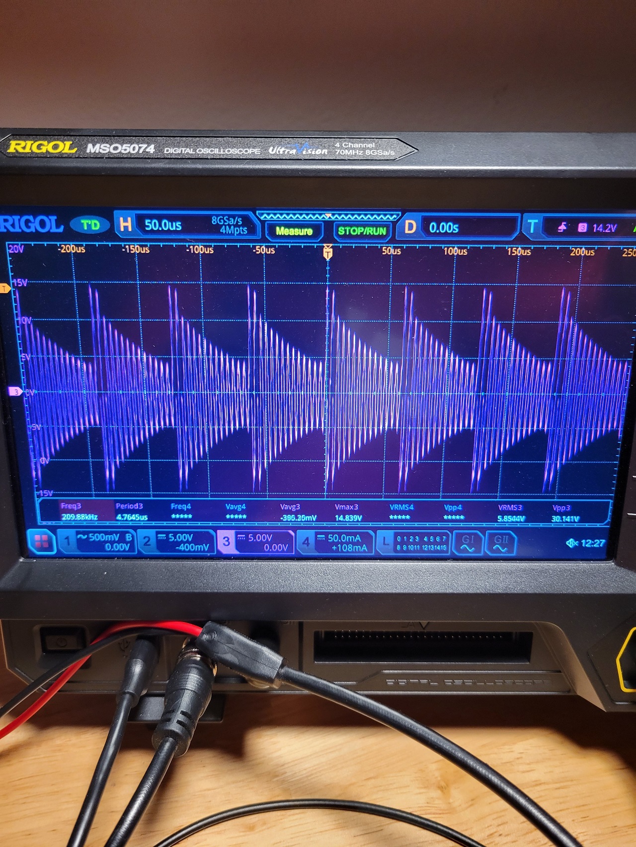

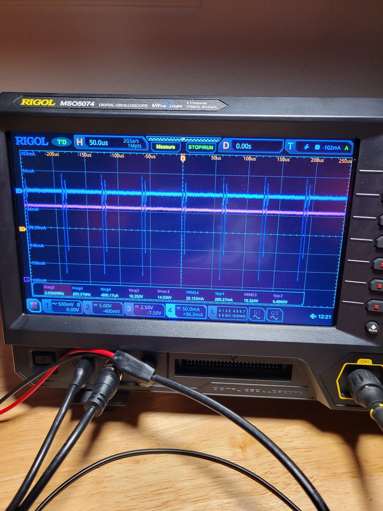

Made changes based on the circuit in Jagau's last post minus the two extra dioes going from the bridge rectifier, performance seems to have increased even more. Without receiving battery attached the circuit is consuming .5 amps, though once I placed battery on output its only using 5ma, and the output looks pretty great.
After bridge rectifier:
Voltage waveform on output wires before bridge rectifier:
Only had a few mins after work to implement that, so I still cant comment on its charging performance, though with last circuit it did bring battery back to life and was able to run a small load. I still plan on making adjustments when time permits. The ringing waveform without a load connected is over 600volts
