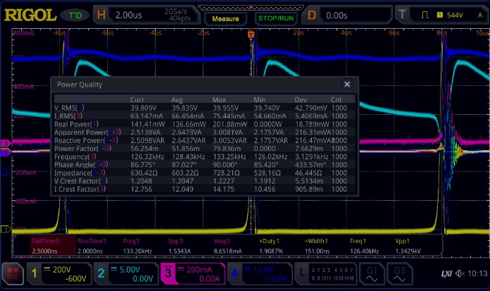

As an example look at one of the images that Bearn sent in a post recently wath can do the
Power analysis software
Real Power, Apparent power, Reactive power on same view, wow
This avoids a lot of calculations, everything is done in the software instantly, beautifully
On a 70 Mhz scope we have 5 ns rise time, 100 Mhz 3.5 ns
on a 350 Mhz 1 ns rise time , wonderfull.
They are to solve the software problem of vertical resolution at 12 bits
