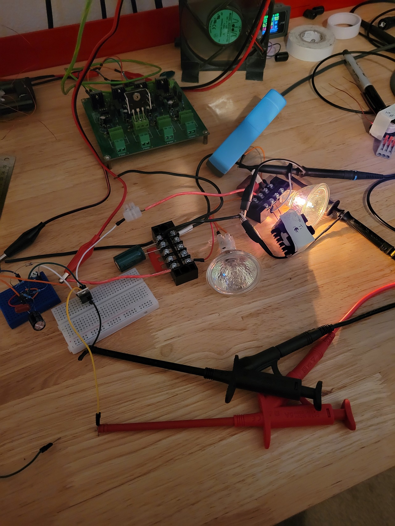

I am using IRF3205, and the gate driver given on the diagram. I wound two transformers on EI33/PC40, I have a few 3c90 cores on their way which should get better results because they have less losses etc. T1 is 16 Turns.
T2 I used the formula provided by YoElMiCrO: N = H(Oe)  le(cm) / 0.4*Pi  * I = 40 Turns.

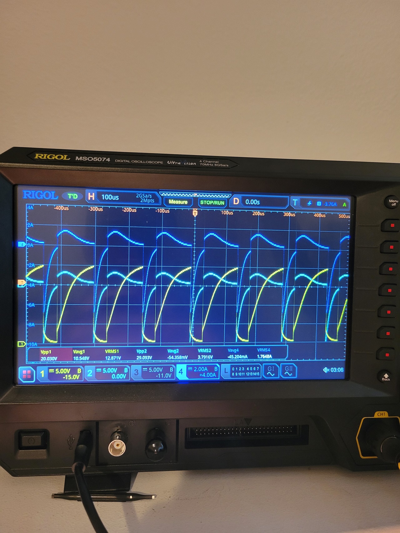

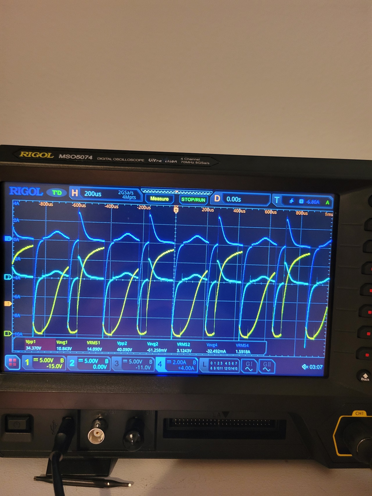

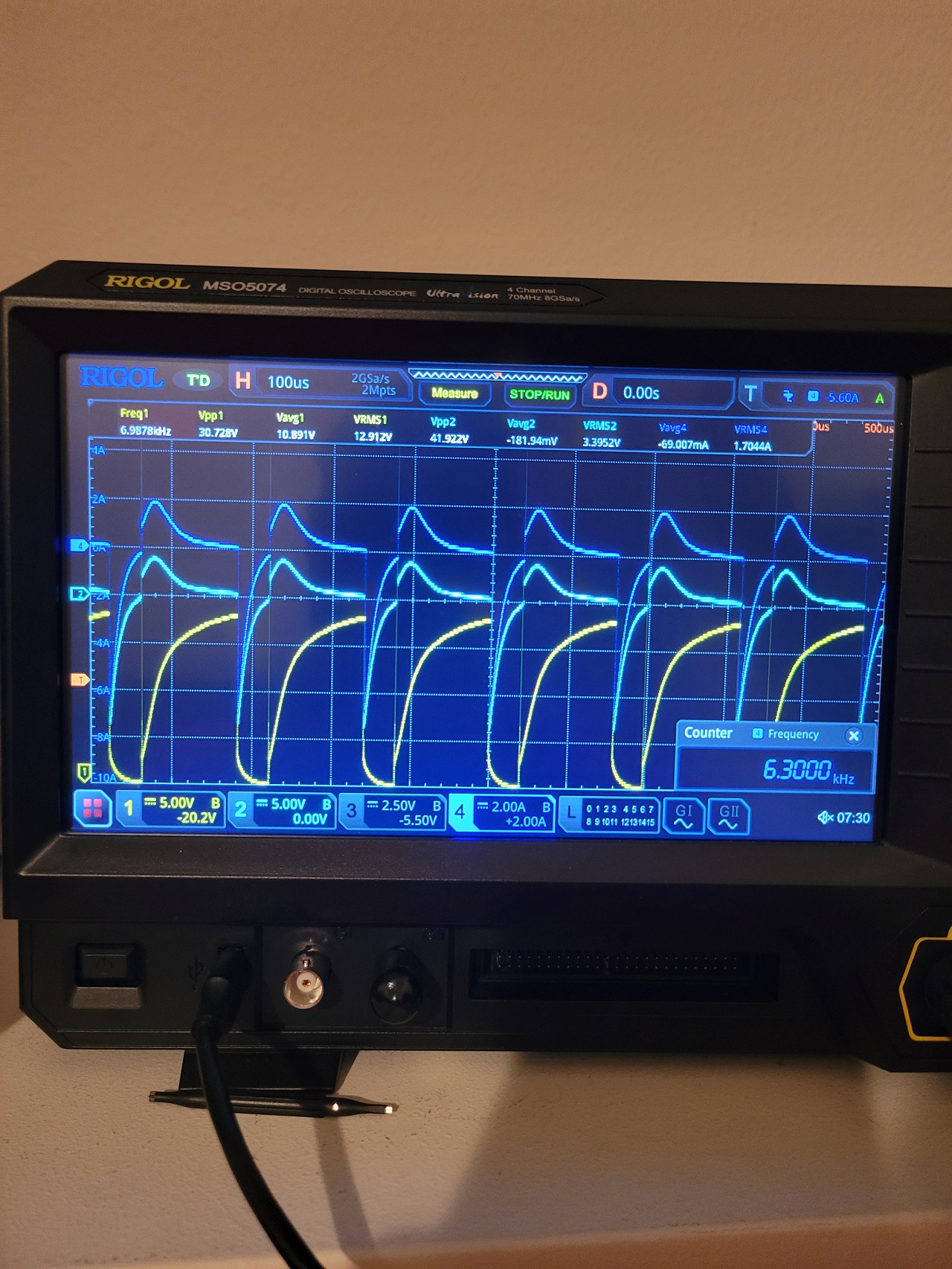

CH1(Yellow/Voltage at Drain), CH2(Teal/Voltage at Bulb), CH3(Pink/Gate), CH4(Blue/Current probe after bulb):
T1 WaveForms:
T2(40T) Waveforms: While scanning frequencies, i've came across a point where every other cycle the waveform or reaction changed, at one point you can see the wave roll untill it stablized into the same wave each cycle, shortly after it reverted. Not sure why this is, but heres a couple photos showing what im talking about:

This circuit is the second in the thread:

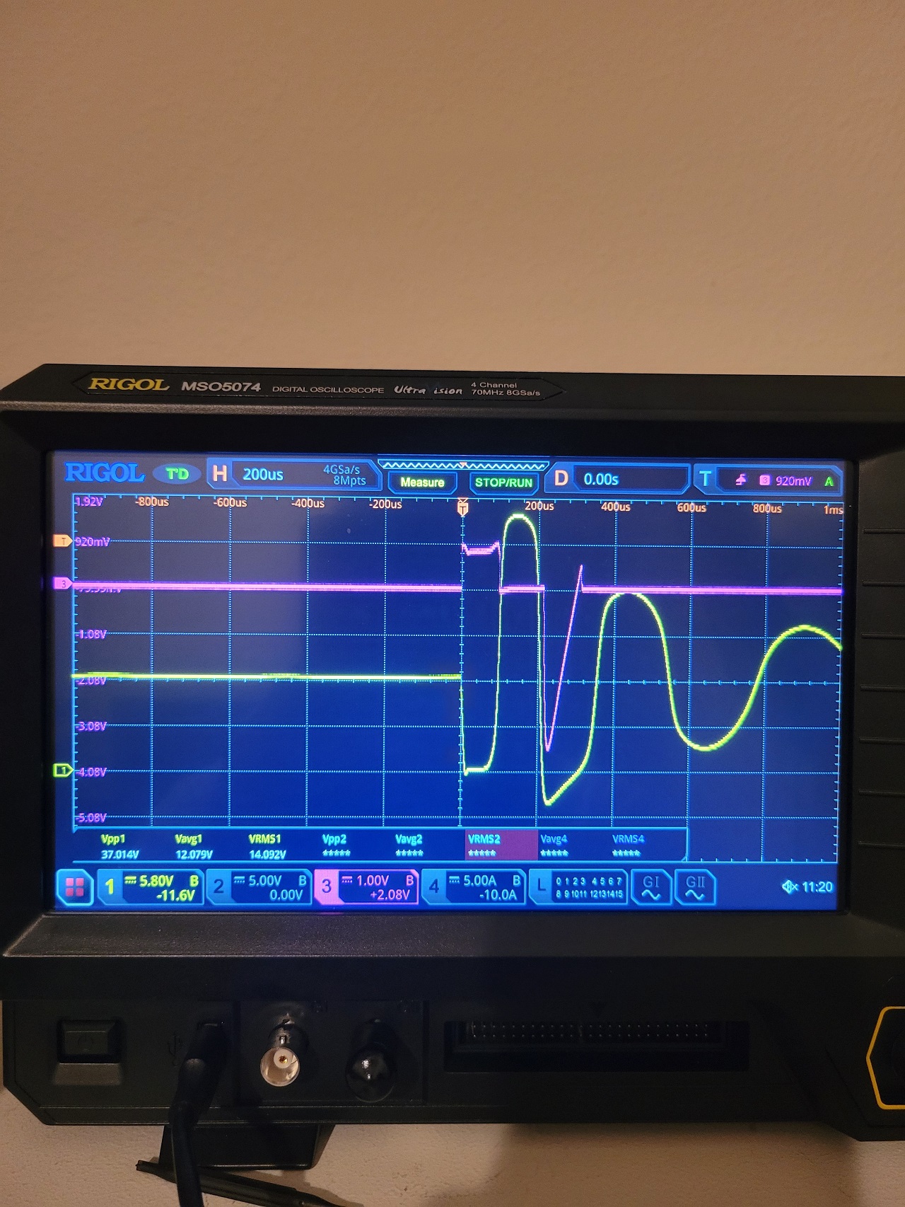

I never explored or looked into the miller effect, and had to change the mosfet I was using to achive the waveform although is slightly different so may not be exactly right, there is plenty to continue to learn.
CH1(Yellow/Voltage on Drain), CH3(Pink/Gate): Frequency: 82Hz Duty: 0.8%

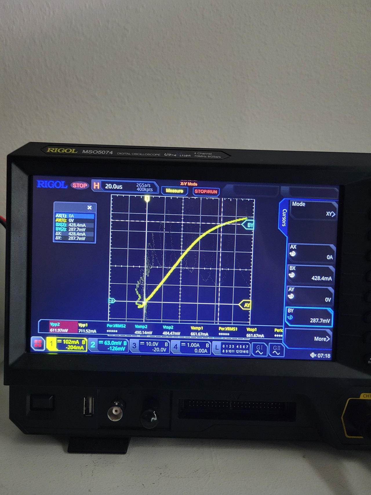

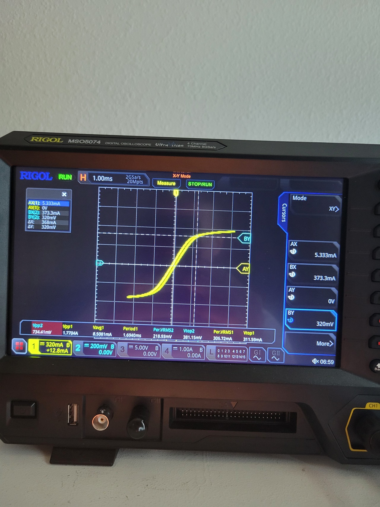

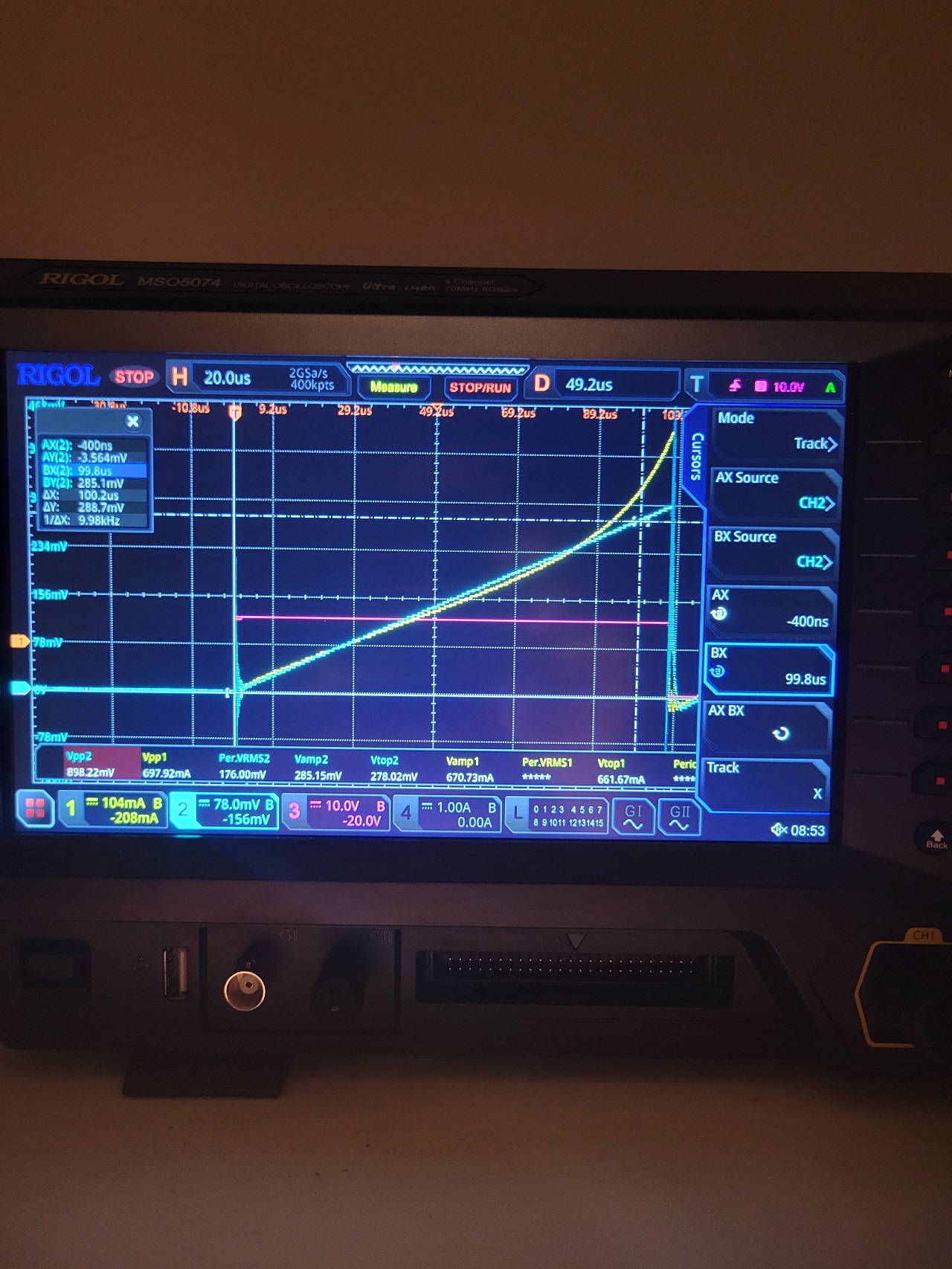

I wanted to measure where the datasheet specifies Bsat = 330mT. This is a ETD39/20/13 3c90 core. c
Measuring BH Curve: There are many sites that helped a lot, I will post once I find them again.
This setup N1 and N2 have 28 turns.
R = 3.8k
C = 1.037uF
f = 300Hz, 3.3% duty
  •  RC >> 1/2πf, in the pictures I took in a hurry I did not check this.
  • Ideally if you make R×C = N×Ae ; since B = Φ / Ae , also Φ = R×C×Vo / N; Then Vo = B
    • Vo = Voltage from integrator output
    • Vin = Input voltage: 12v
    • Ae = Core cross sectional area: 125mm^2
    • le = magnetic path length: 92.2mm or .0922m
    • N2 = number of turns on secondary: 28
    • Φ =​ R×C×Vout​​ / N2
    • B = Φ / Ae
    • B = R × C × Vo / (N2 × Ae)
    • Vo = Φ × N2 / RC
    • H = N × I / le
      Other formulas used:
  •    Φ = Vin × ton / N  : 41.25 uWb
  •    ton = N × Φ / Vin : 96.25 us
  •    L = N × Φ / I ;  Vin / (dI / dt)   ;  V × ton / I
Take a look at the current and the change it goes through while permeability changes as flux density is increased with time - Ch1(yellow/current), Ch2(blue/Vo); B =(3,877×0.000001034×0.2887)÷(28×0.000125) = 330.67mT :

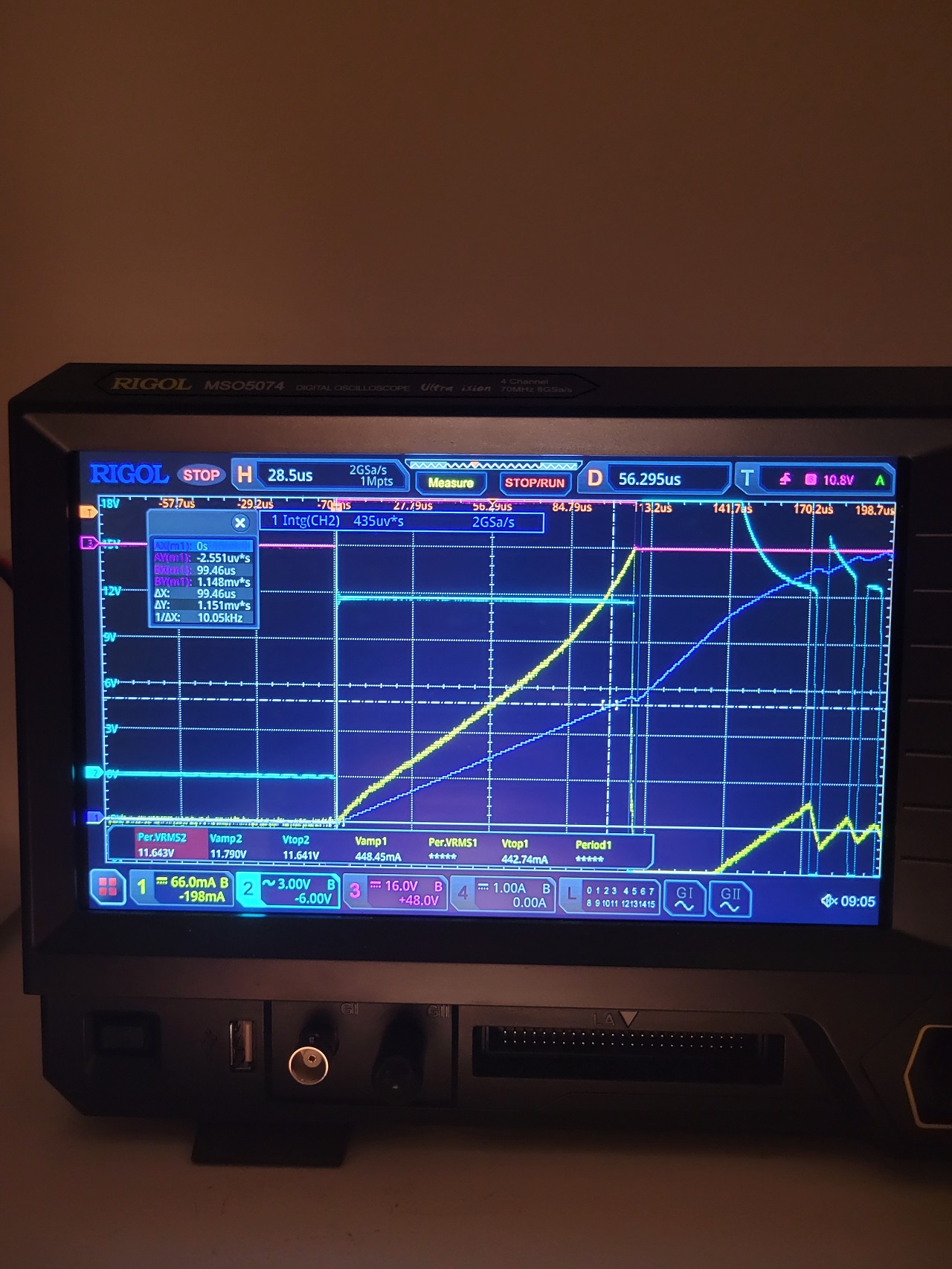

This is the second setup, using MATH(Integ) on CH2(directly connected to N2)
R×C = N×Ae

Thanks for sharing, the scope image showing the current change depending on permeability change is very interesting.
