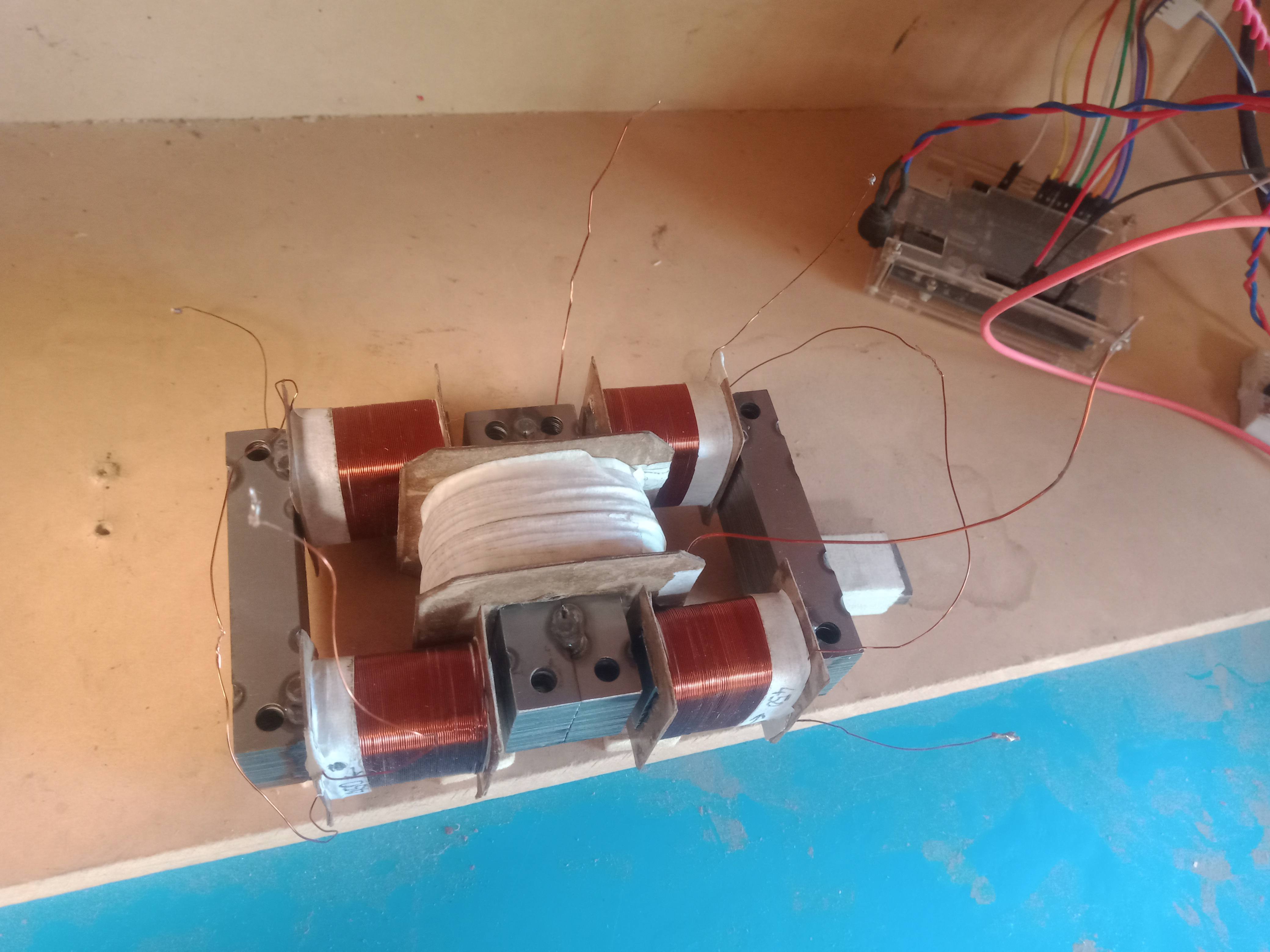

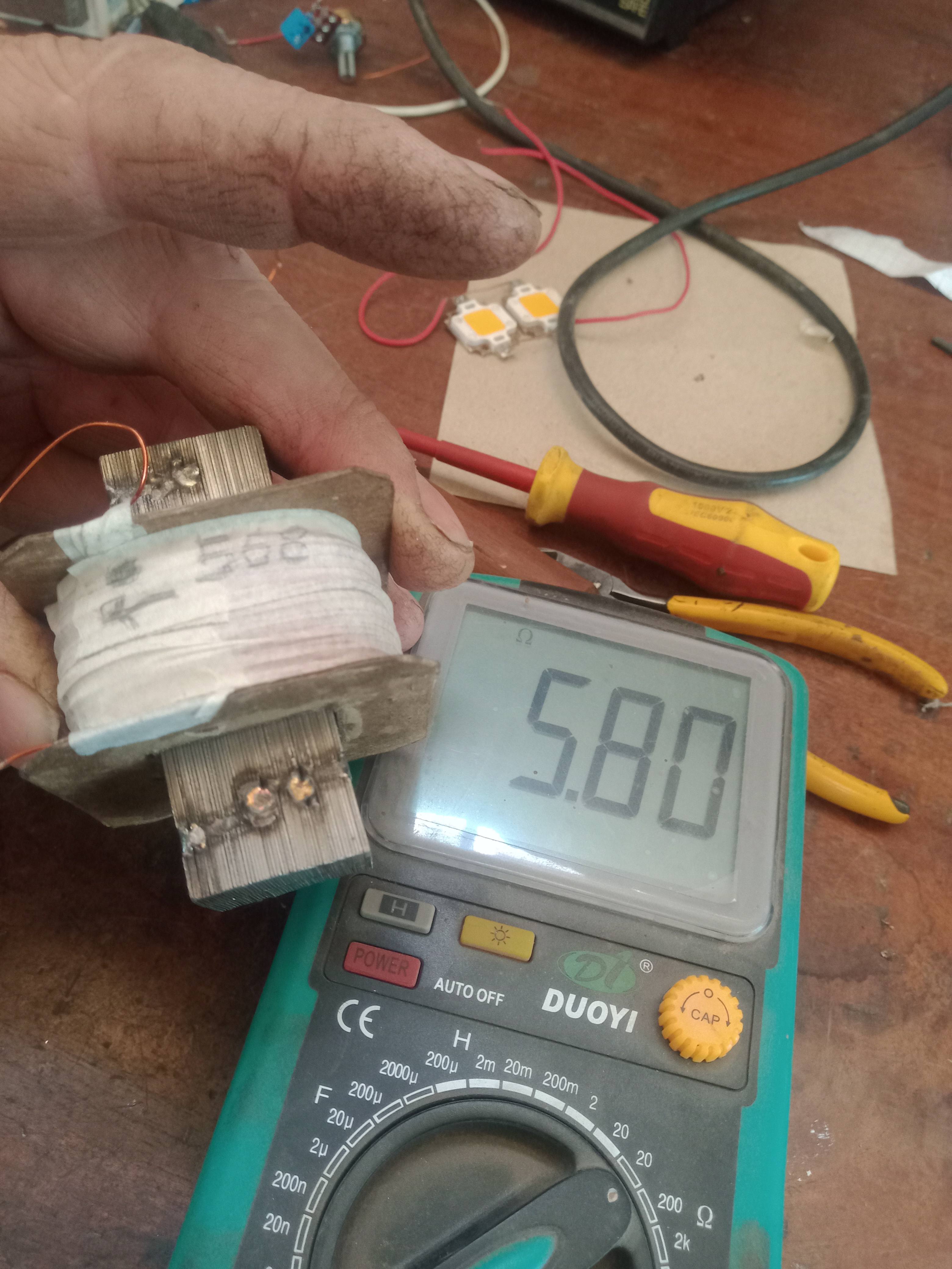

Today I finished the windings, but  could not find time to test it still. Below the Images:

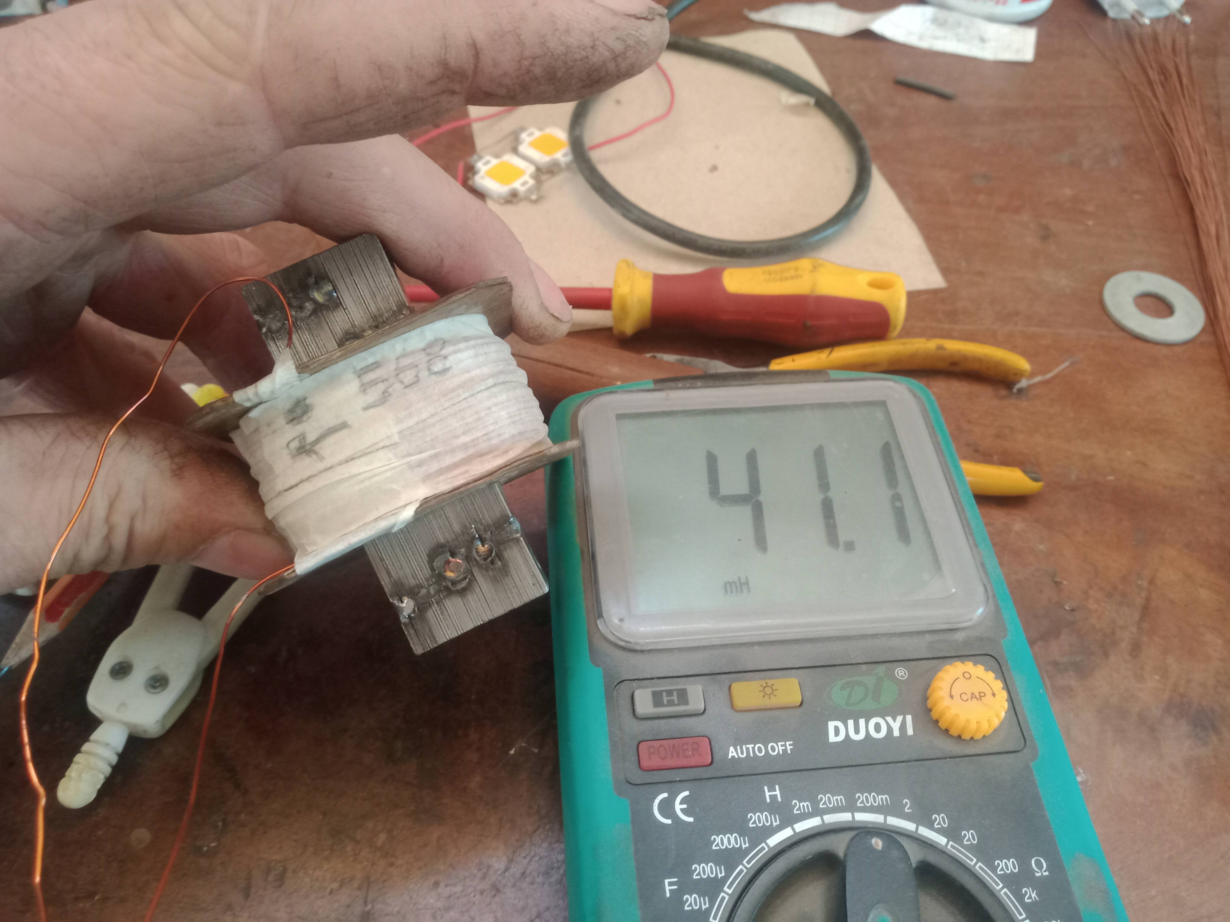

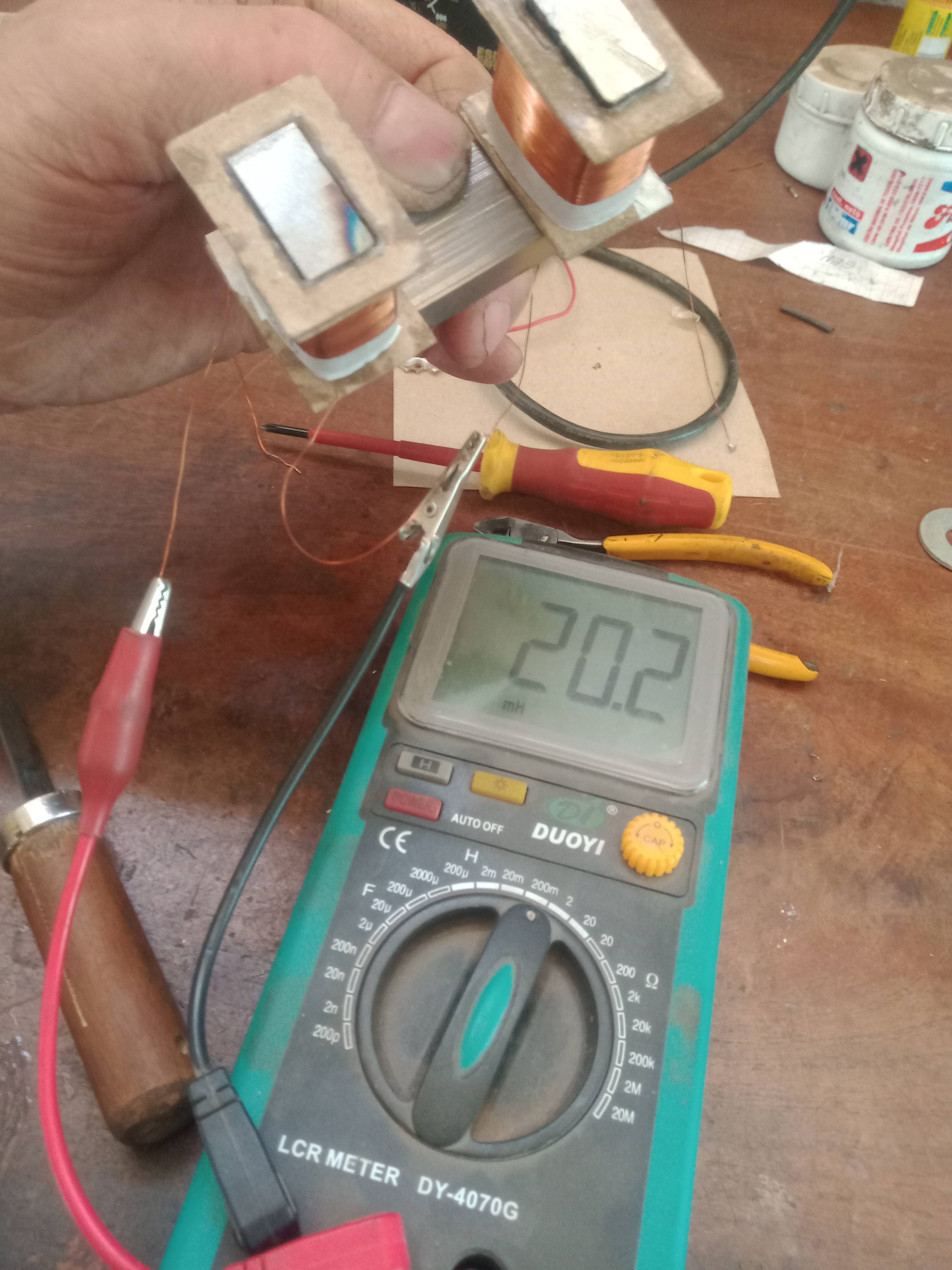

Here the induction measurement of a single EM.
Inductance outputcoil
Resistence 568 turns 0.55mm diameter.
The completed coils
Next step hooking it up to the switching device and test the rise-fall times of the EM’s

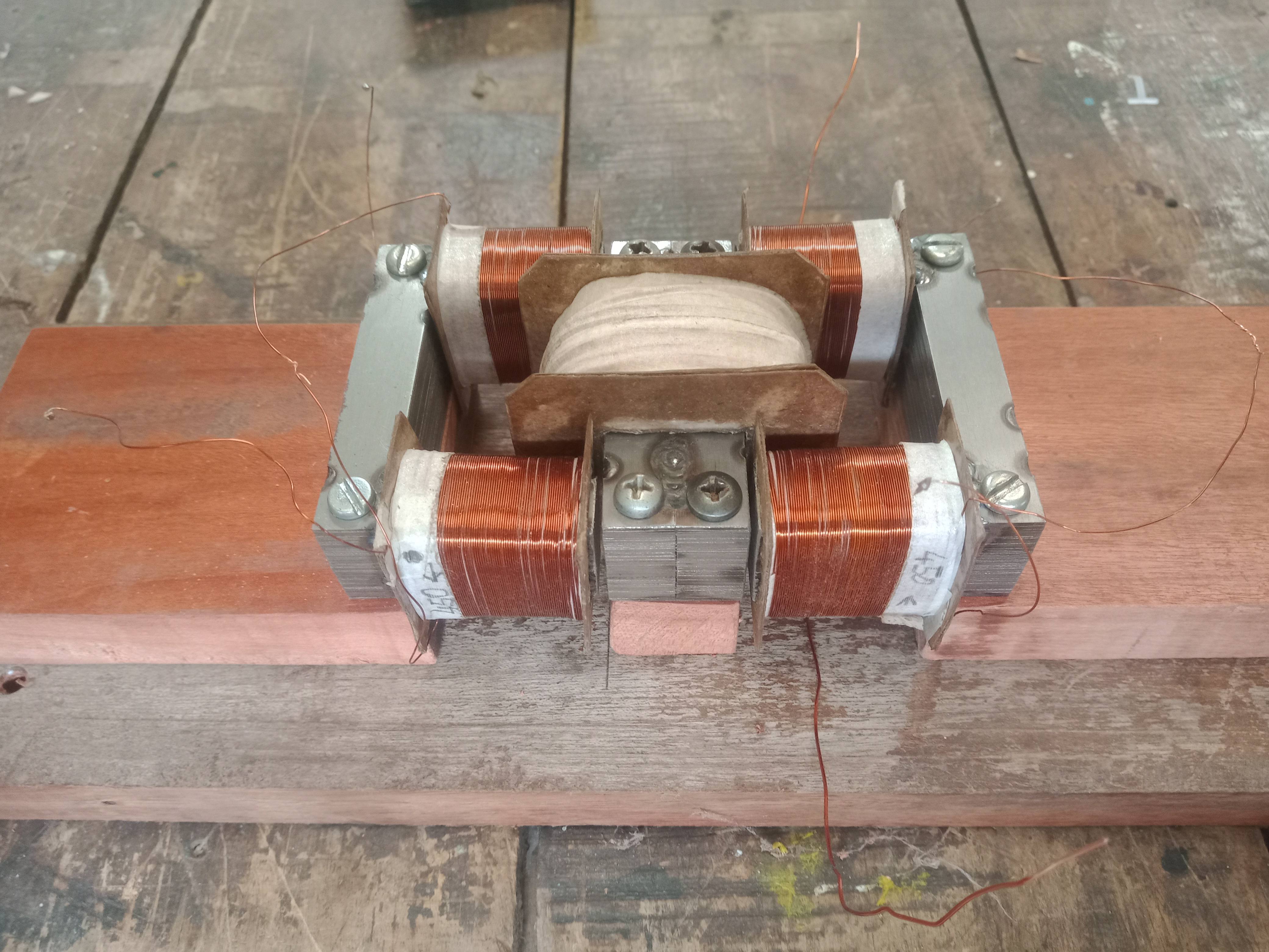

Vidura posted this 10 November 2024
Back in the workshop. Below you can see the mounting structure which will allow to adjust the airgaps. Soon I will try to run some tests to adjust the parameters.
What I am looking for is to get a generator effect, where the output voltage is dependent on the frequency ,not the ratio of turns

Today some tests could be made. The setup did not perform as expected, without load there was voltage, but loaded it dropped to less than 0.5 V. Also, a reaction(increase) on the electromagnet current was observed when shorting the output. I had the feeling that the magnetic flux was pushed to the core of the opposed electromagnet instead of the output core. Still, I think that the physical layout of the coils could be useful, but next I will try a completely different switching pattern and timing. For this the switching circuit has to be modified.
