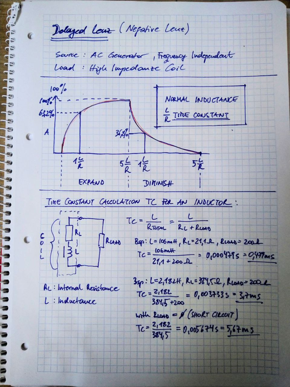

A few weeks ago i decided to dive into this interesting subject. I think you all are familiar with this topic and know about the work of Thane Heinz and others.
My approach is similar but i start with some non-complicated math. Goal is to know how much delay a coil system should have to benefit from this effect. Therefore we have to measure the ohms and henry from a coil to calculate the time constant T which plays a key role here.
as we can see, if we shorten the secondary from transformer the time delay gets big. and the force which acts against our primary source dipole loose strength so this is what we want maybe...
For any RL system, the time constant is:
\tau = \frac{L}{R_{\text{total}}}
where:
* \(L\) is the effective inductance seen by the current path
* \(R_{\text{total}}\) is the total series resistance (winding resistance, external resistors, and any equivalent resistive damping introduced by loads or coupling networks)
a bit more of this can be found at: https://aether-research.institute/MSO5000_liveview_doc/delayed_lenz_coupled_inductors/

to make things complicated i decide to built an analytic RL transient simulator for pulse and sine excitation, mainly as a clean laboratory reference model for inductive experiments.
It models a single series RL branch (L, R_coil, R_load) and computes a lot of stuff.
maybe it is only for freaks šŸ˜Ž

to make things more interesting i put a C in series with RL. so now we have a full RLC branch tester.
Focus mode for laptop
The next steps for me is to prove the simulator against my lab-experiments. when it is accurate enough i can step forward and add magnetic coupling or other stuff.
if you find errors or 'stupid' data values please tell me!
have a nice day!
baerndorfer posted this 25 February 2026
there is a second version with lots of improvements - i call it 'pro' because there we can have C in parallel with RL and other stuff. the scope can be changed to other views which are physicaly correct but can look 'spooky' sometimes - i like that. and because this suck up all of your cpu and gpu power i integrated a performance measurement tool too. if you are an explorer you can check it out here.
