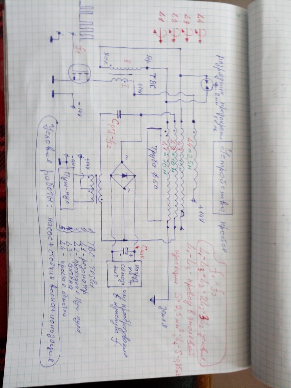

One day ago Mitza84 shared a archive containing conversations, schemas, details and explanations related to a succesful Kapanadze/Akula replication. The data is coming directly from the author of the replication named Ruslan Gadzhiomarov from Azerbaijan:

It's too much information about the device to show it directly in this post so I'm attaching an archive with all the information received from Mitza84.
In the archive you'll find the original documents in Russian language, photos, schemas, explanations and some of the translations in English using Google Translate so be aware the translations could not be 100% accurate. There are still documents and notes on the schemas in Russian language for which you'll need to use Google Translate in order to understand what they author is saying there.

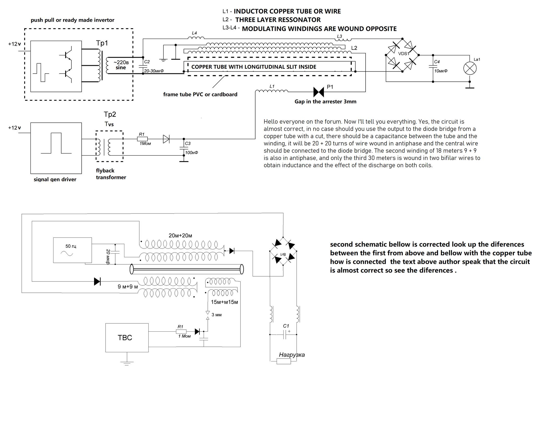

And some updated information.
On one of the the forums the author said the previous schematic is almost corect except for the connection from the copper pipe to the bridge diode rectifier and provided a second corrected schematic (see https://energyscience.ru/topic518-42.html):

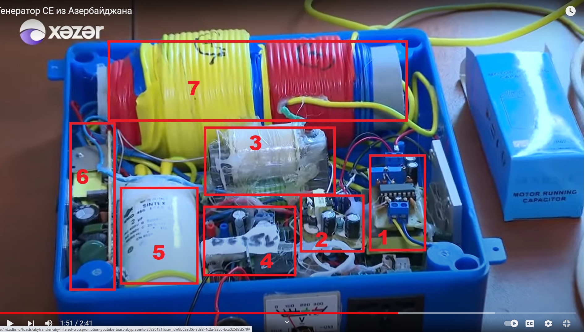

Fighter posted this 22 January 2023
And another video with the device shown by Ruslan Gadzhiomarov:

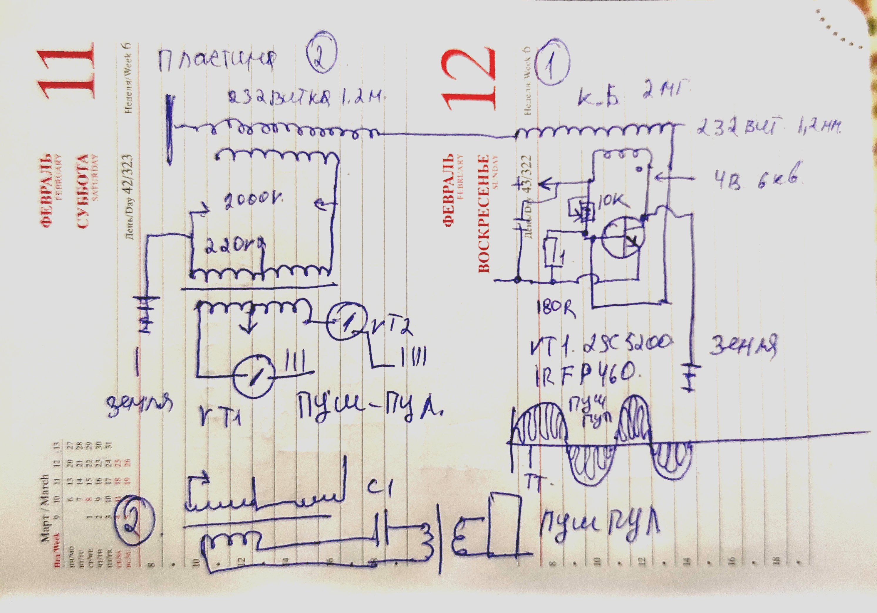

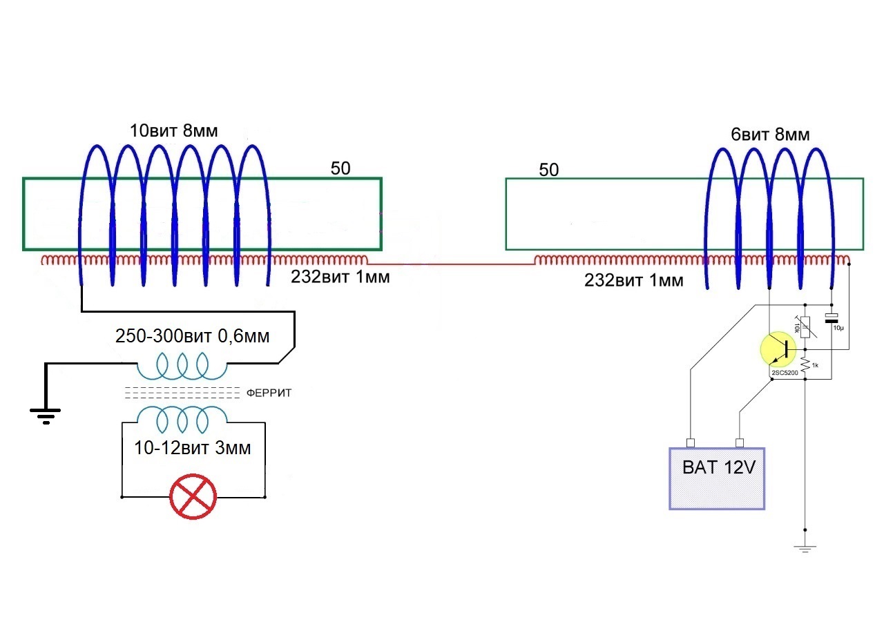

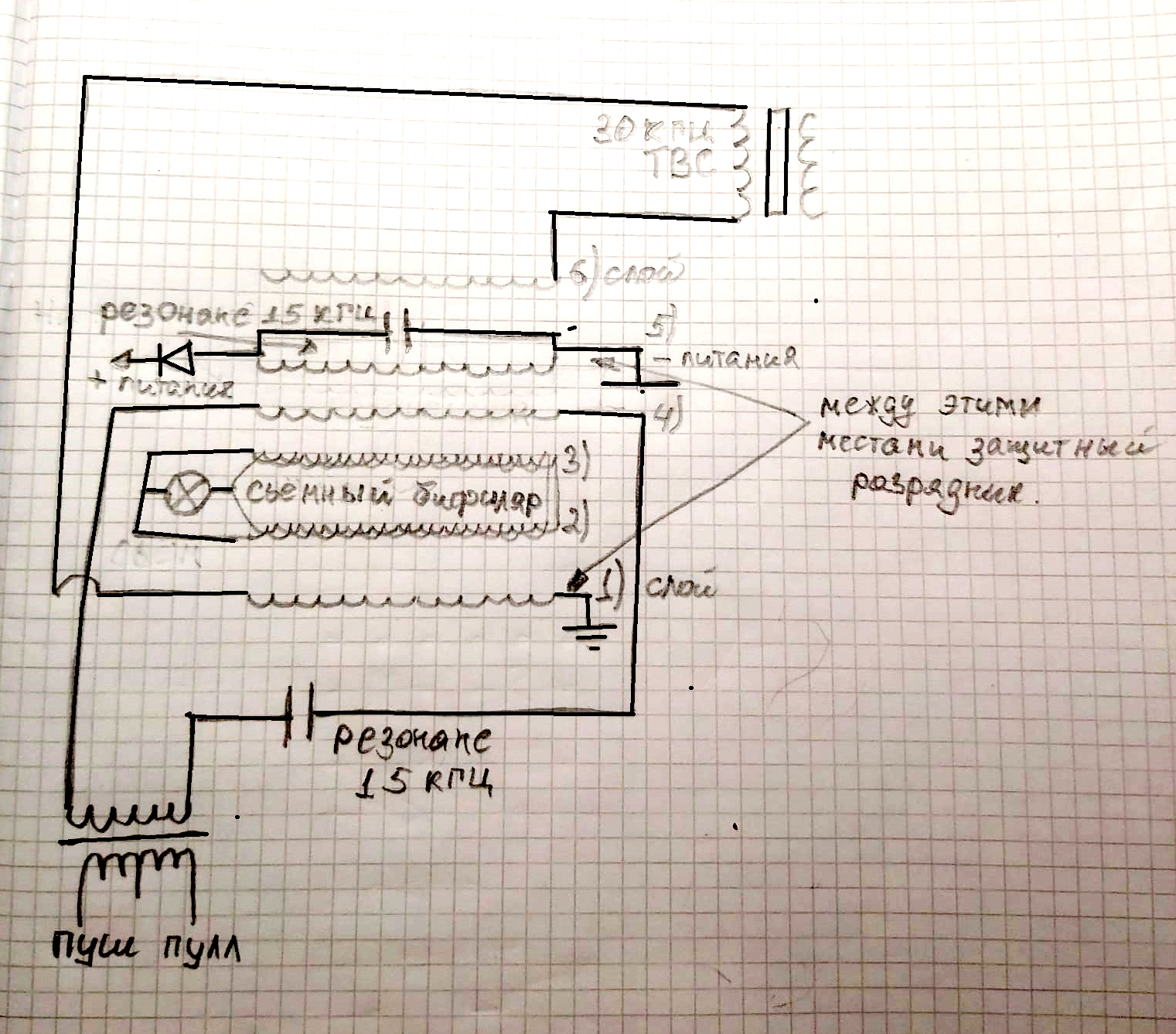

Ok guys hello again the inventor give this file as a first part of the device to get familiar with it  .so he say the voltage we get it from the push pull and the current (amps) from the high voltage part wich can be kacher or flyback of 5000volts      this device autor say it output 500w
but with the help of the grounding of course so the pull inverter have a coil wich is in series with a capacitor of microfarads valuea from 2uf to 25uf depends of the coils and goes to the main coil to help build voltage plus amperage i have a schematic for the device from the forum but i can not guarante that is 100 percent acurate because is from a user not the autor and i dont know if he got it from the inventor directly or not . but we have enough detailes to buyld the device .i will try to help as much as posible but the best is if you make a little time to read the litterature that we have on the device because i think is gold information he say about akula and ruslan kulabuhov that they have fakes and the basic he got it from an exsisting patent . wich is here   and translate in english the page and you will see         https://studfile.net/preview/8198608/

diagram from the chat above
