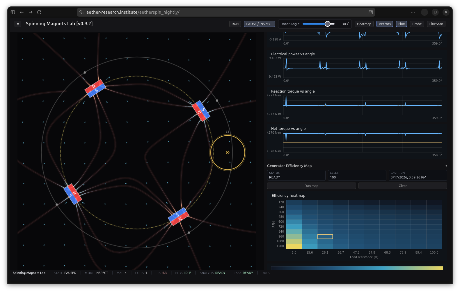

because magnets and a rotating disc is on my todo-list for some reason that i do not understand fully at this time i decide to build a tiny helper that should assist me on this journey.
it is in an early stage, but still usable and can help with design of such structure. at the moment i can calculate air-coils without core situation. script runs stable but need some cpu-power. the input scenario is nearly complete and it is fun to play with.
when you are in 'the right mood' you can check it out here
have a nice day!

changes since v0.8.6:
- Introduced authoritative induction runtime (fully state-driven, deterministic)
- Implemented self-consistent electromagnetic coupling solver
- Added magnetic back-reaction and reaction torque calculation
- Integrated electromechanical power balance (electrical vs mechanical)
- Upgraded coil model to surface-based flux integration (quadrature)
- Added configurable coil quadrature (square + circular, multi-order)
- Implemented rotor sweep analysis engine with aggregated metrics
- Introduced efficiency map (RPM vs load, 2D grid with convergence tracking)
- Added worker-based background processing for heavy computations
- Improved modular architecture (runtime split into dedicated modules)
- Added solver diagnostics and model comparison tools
- Stabilized numerical behavior and convergence handling
- Improved UI consistency (panels, status bar, interaction modes)
- Ensured full compatibility with import/export project schema
with more workers life is easier
