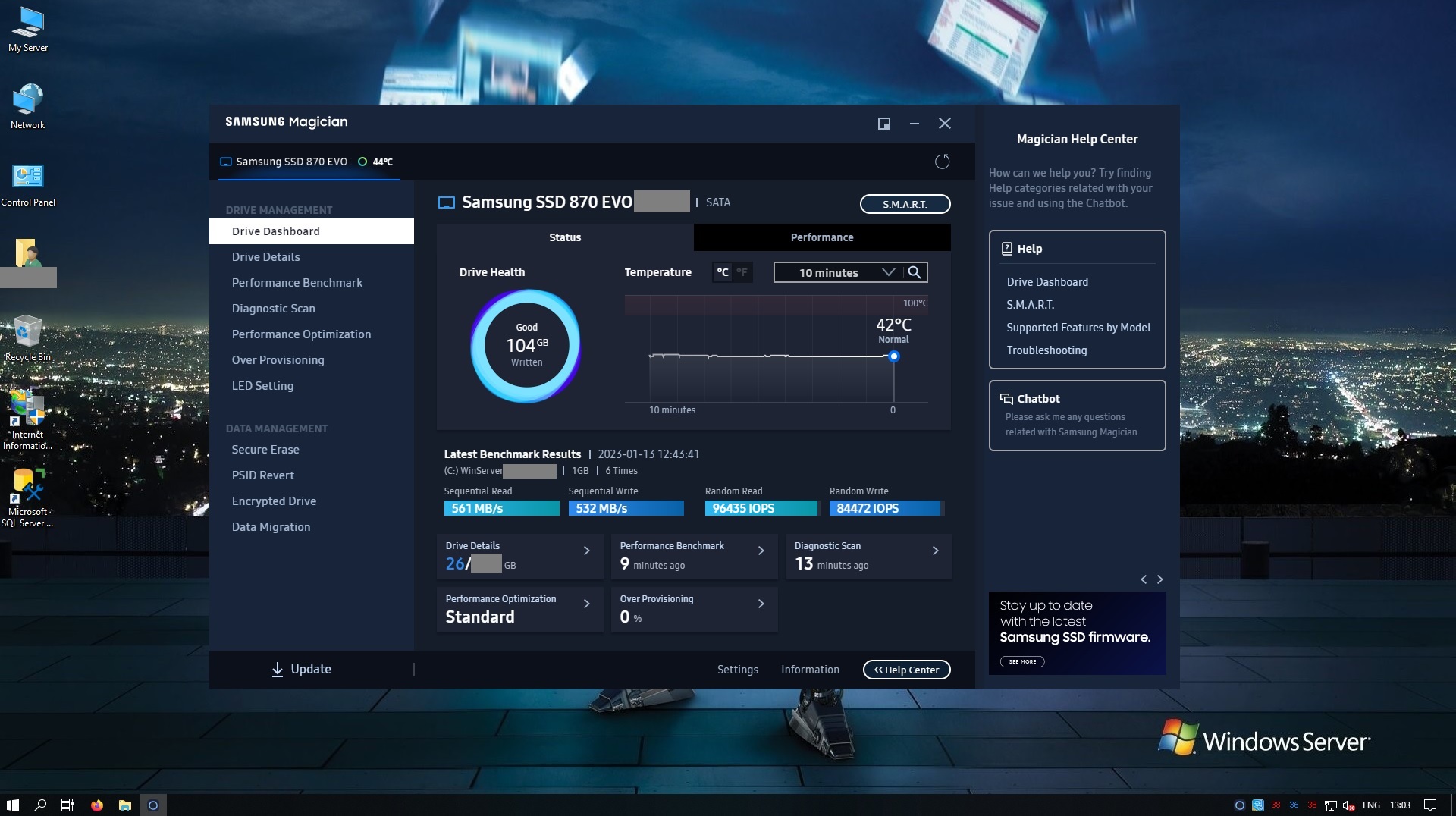

The RAM upgrade went well, it took about 45 minutes, the server started and shown the new RAM capacity but then after I restarted the server several times it failed booting and the SSD was reported as corrupted.
So the SSD (manufactured by Western Digital) which was running 24/7 on our server for more than 4 years has failed.
All the efforts to repair it using standard methods (diskpart, fixmbr, fixboot, rebuildbcd) failed, it was a hardware failure so the obvious choice was to replace it.
So in the next morning I ordered a new bigger and faster SSD (Samsung 870 EVO) and asked for expedited delivery from the store. I received it within about 4 hours and in the evening after I finished my job-related work I started a fresh installation of Windows Server, then SQL Server etc.
As we have automated backups running daily (at midnight, Romania's time) saving the database and site's content to an off-premise encrypted backup there was no data loss.
So after setting the new Windows Server OS, the new SQL Server, setting security and performance settings, updating it with the latest updates from Microsoft, restoring database and site's content and all the necessary things we're back online.
Even if the time that SSD chose to stop functioning was not a good time (it never is šŸ™‚), there are also good things about this incident: we're back online with 0 data loss, a much powerful server having more RAM, bigger and faster SSD and with fresh/faster Windows Server and SQL Server installations.

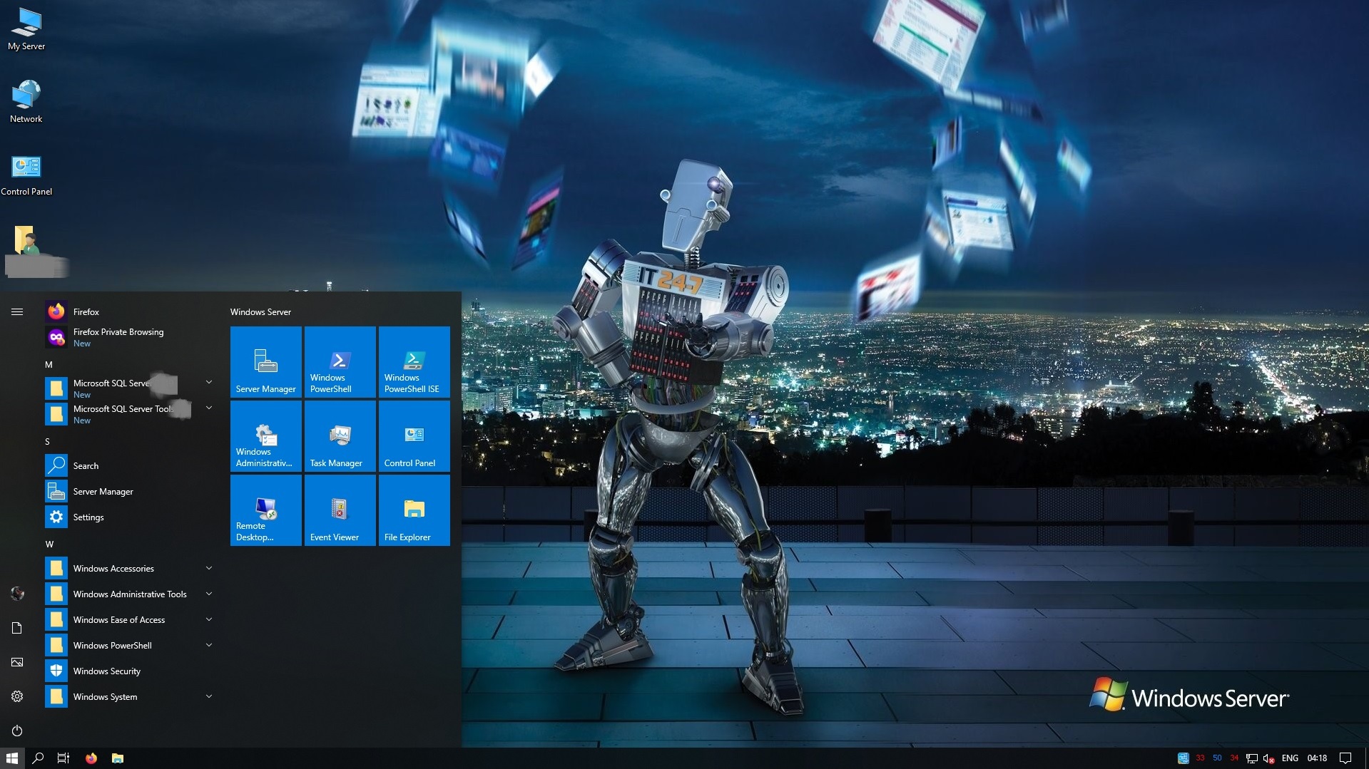

Below is a screenshot of our fresh Windows Server installation and the standard wallpaper image I always use on the server is showing how our server is handling your requests šŸ˜„
There are still things to do like setting again the daily automated backup mechanism, some fine-tuning and other stuff but I'll take care of them as I find time and most of them will be probably done during the next weekend. About the automated backup part, until I'll have time to set it up in the weekend I'll make daily manual backups, the data on our site will continue to be backed up.

Just a small update, I just checked the performance of the new SSD.
Compared to the performance of the previous Western Digital SSD this one is much faster !
It also comes with auto-diagnose and real-time health monitoring an reliability checks so if there will be a potential hardware failure in the future we will know in advance about it, before it happens.
It's really top-tech and top-performance, it was a very good choice.

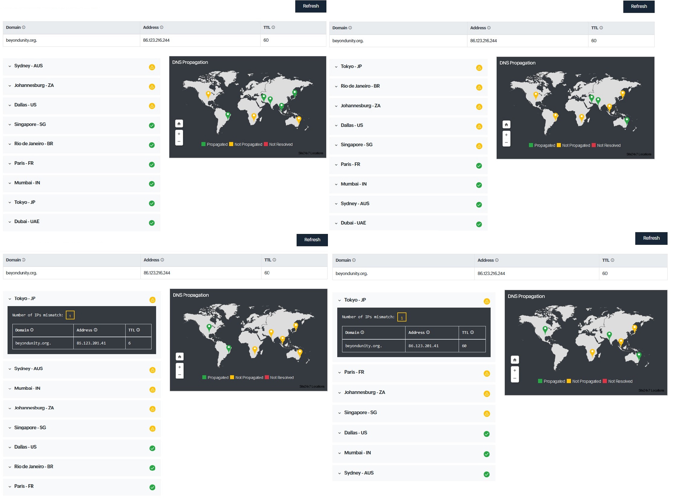

First, as probably many of you noticed in the last weekend and the beginning of the week our site experienced a very strange visibility issue around the world.

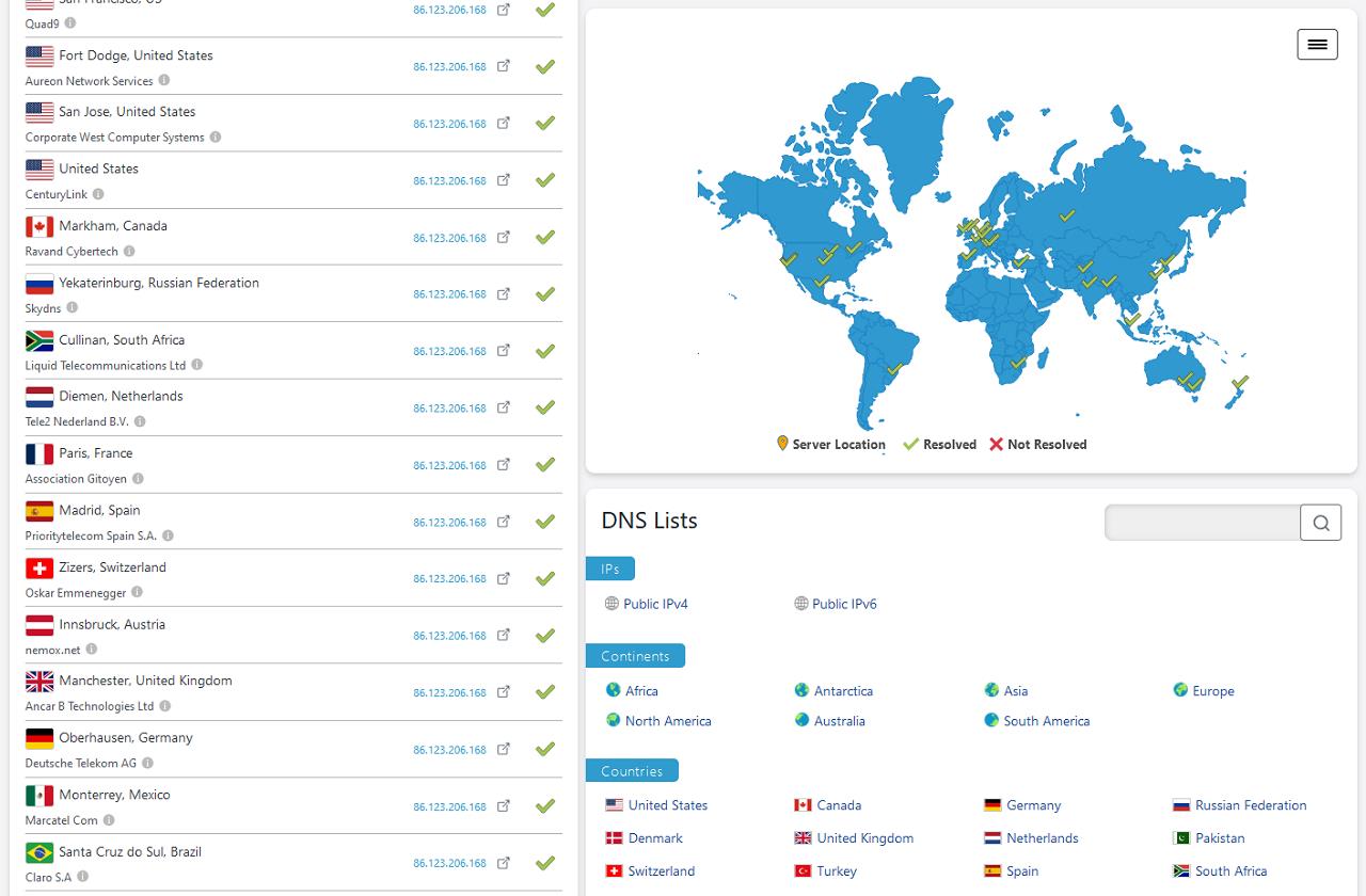

I chased this issue which was manifesting like this: at interval of a few minutes our site was accessible then inaccessible at different locations on all continents. This manifested randomly but continuously.
After investigating the firewall logs for possible attacks and checking for possible local connectivity issues of our server I came to the conclusion it was nothing wrong locally but it was a DNS propagation/caching issue of our domain manifesting randomy on all continents.
As example this was the situation at some locations at intervals of 5 minutes (green markers means our site was visible at those locations, yellow markers means our site was not visible at those locations):
My investigation shown a previous/wrong IP was associated with our domain at random intervals all around the world and the visitors trying to access BeyondUnity.org were pointed to that IP which was no longer our server's current IP. Therefore no server was present at that IP to answer to their browsers requests.
I gathered as much as possible information for diagnosting and debugging then I contacted our DNS provider telling them about the problem.
I collaborated very well with Joshua from our DNS provider (it's not the first time I work with him, he is always very involved and helpful) and he told me this is a very strange issue. As a matter of fact I was using their free DNS services for many years and I never had a issue like this.
At the beginning of the week the issue was resolved, this is the current visibility status right now:

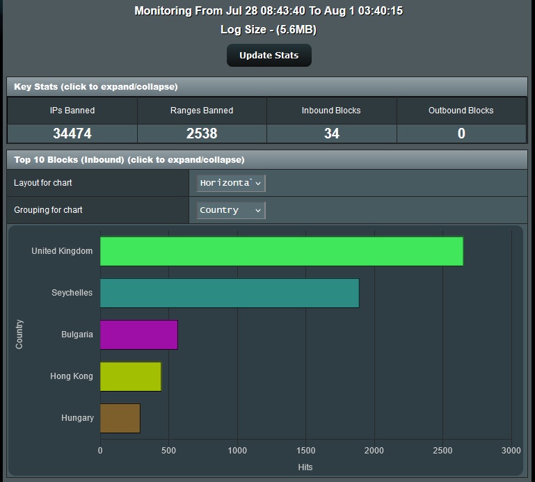

I'm saying this because as our members already know since we came online our site is under various attacks which are stopped by our firewall every day.
There are days when we have spikes of tens of thusands of deflected attacks, this is how a calm period looks like:

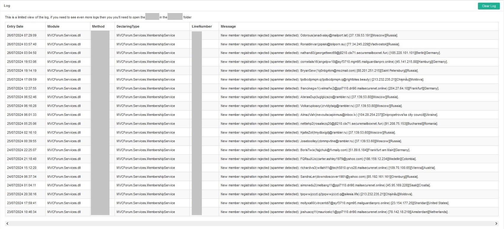

Also we have daily waves of membership requests from spammers and bots trying to make fake accounts on our site, here is just a small sample:
If we would let them on our site probable we would have thousands of fake members by now.
The algorithm we developed for our site is rejecting a membership request only when it finds 100% evidence that the source of the request is a bot or a spammer. We don't need fake members.

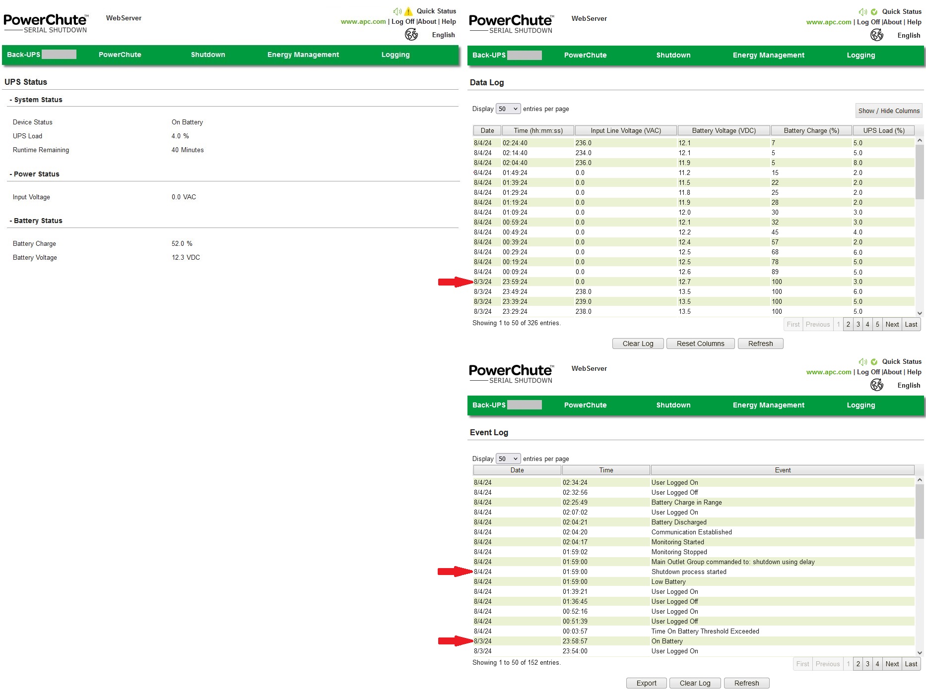

Another thing I worked on this week was to aquire a UPS for our server so there will not be any future incidents like it happened 5 weeks ago.
From now on in the case of a power outage the UPS will keep our server, router and the fiber-optics modem powered for about 1:45 to 2 hours so the site will keep functioning (if our ISP's fiber-optics equipment outside of the building still have power):
If the power outage's duration takes longer than that when the battery is almost depleted the UPS will send the shutdown command to the server and will wait for the power to comeback then I can turn on the server (including remotely).
During the entire week I simulated power outages to verify in all kind of scenarios the things are working as expected, here are some images taken during one of those simulations:
Everything seems fine, our site's endurance is stronger now handling the situations of possible power outages or power spikes (which usually are not happening that often in the area).

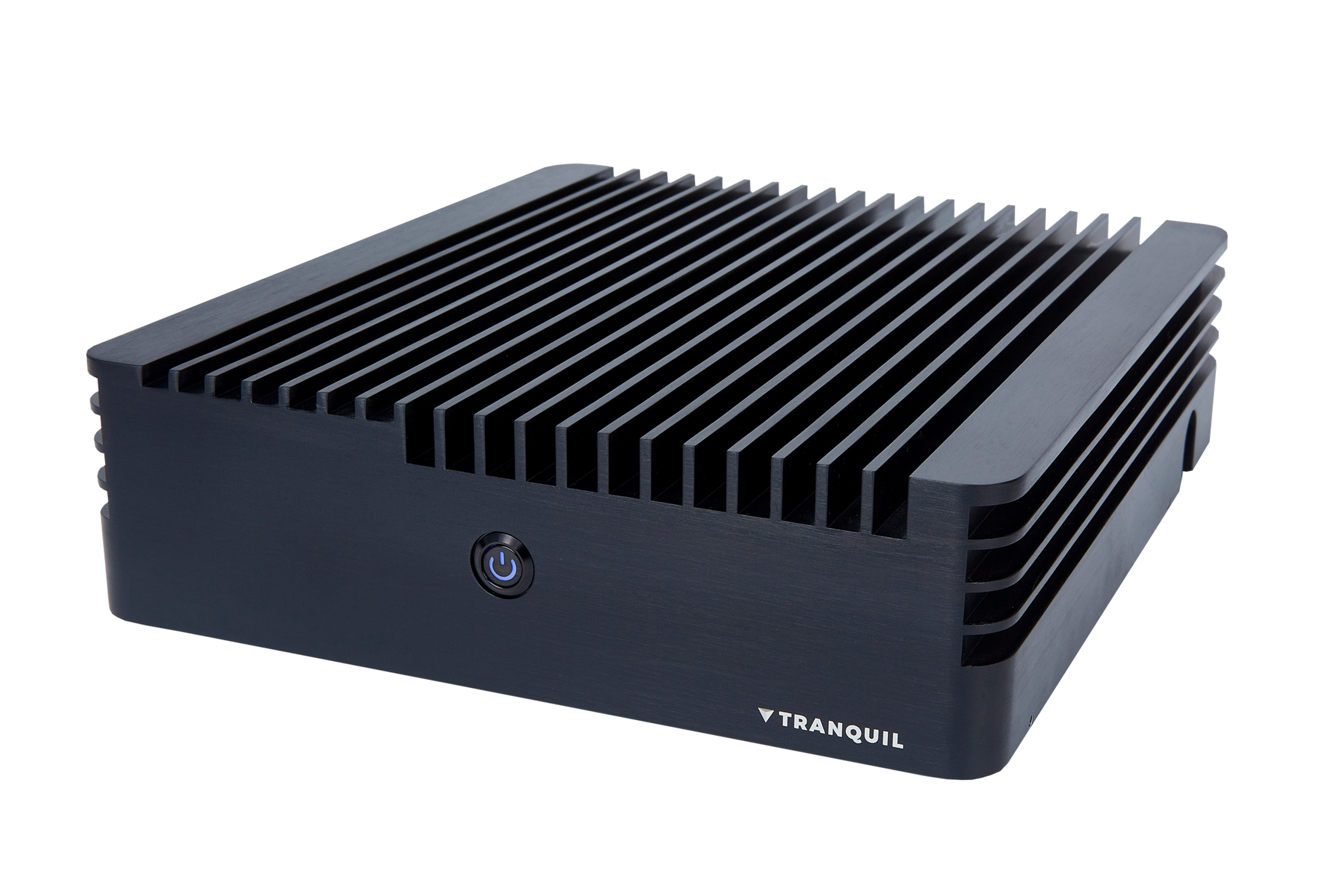

Because of the special way our server is built (as you can see here) this is not a trivial operation.
