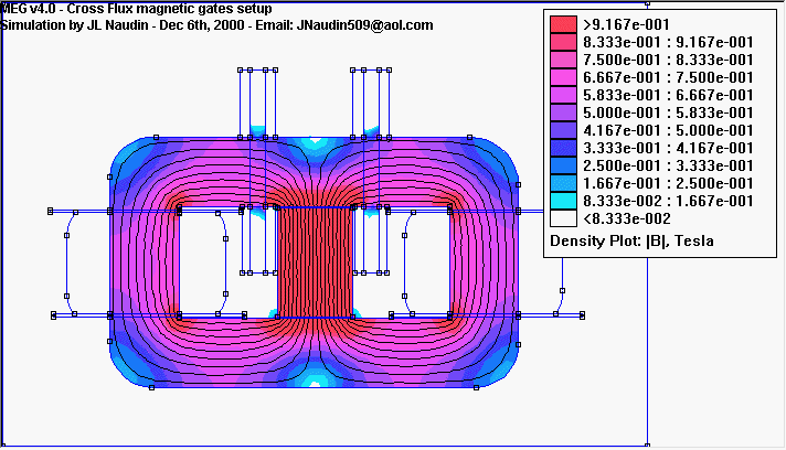

1. J.L. Naudin's explanation on how MEG works is totally wrong. So this simulation is wrong:

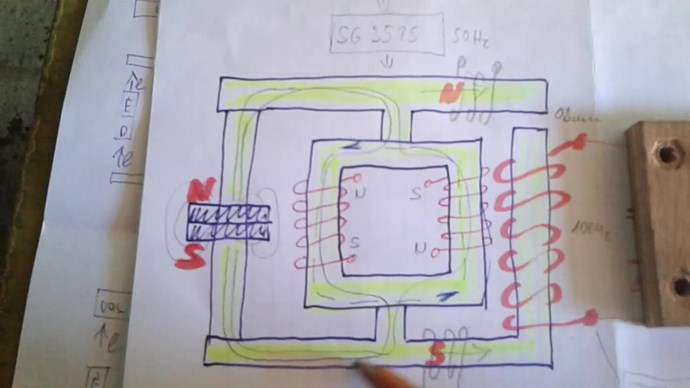

The role of the permanent magnet is not to have its magnetic field switched to left and right core sections by the small command coils.
2. Seems that when a permanent magnet is placed inside of the core without gap so the entire magnetic flux of the permanent magnet is "sucked" inside of the core and become trapped there are two effects:
  • the permanent magnet become almost inert so it stops emitting magnetic field around it or (depending of how close to 0 mm is the gap between it and the core) it's emitting a very small magnetic field compared to its original magnetic field;
  • when the previous conditions are happening and almost all the magnetic field of the permanent magnet is trapped inside the core something new happens: outside of the core a zero-point/quantum/aether (however you call it) field is formed containing additional energy ready to be captured by our device.

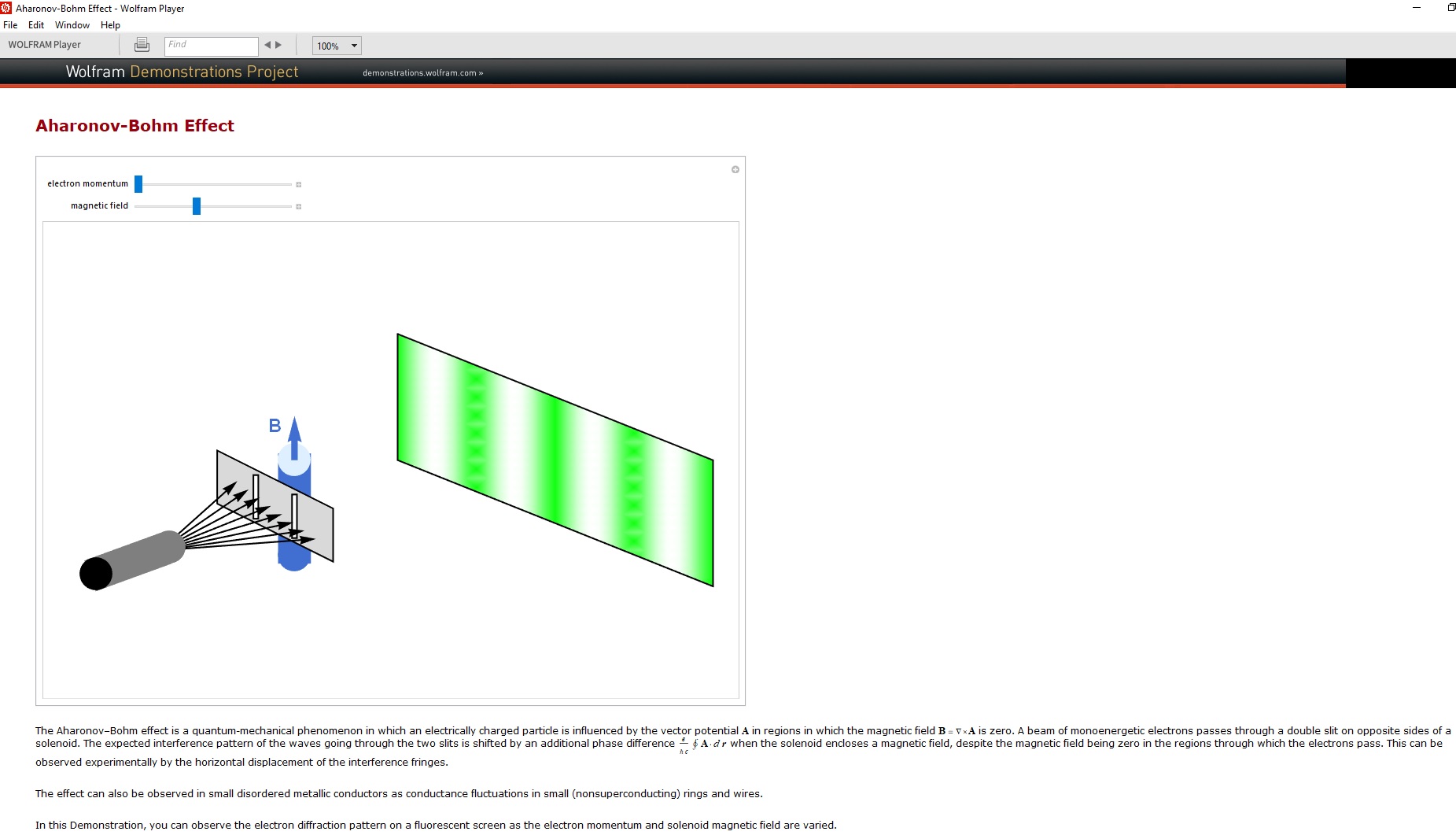

This is a Wolfram demonstration project I played with to understand better this effect (link to larger image here):
This is a try for a possible explanation of what's actually going on with this effect, but as I'm not that advanced in physics as other guys here I'm not sure it's a valid explanation, I'll just post it here for reference (link to larger image here):

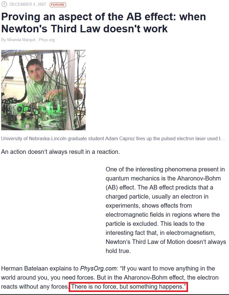

Following are two articles from physics publications:

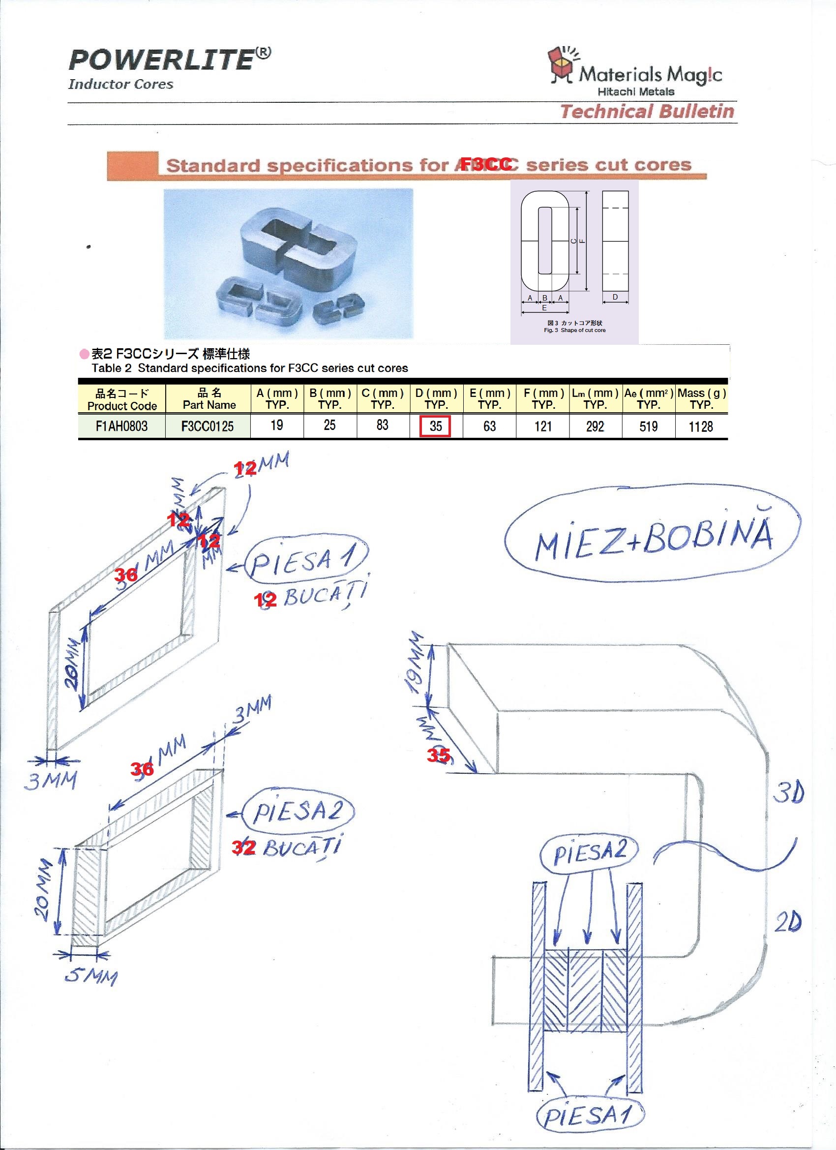

This is a really expensive experiment, the Hitachi F3CC0125 nano-crystalline core costs (including EU import taxes) as much as 3 AMCC-200 cores or as my oscilloscope.
Here are the core's specs:

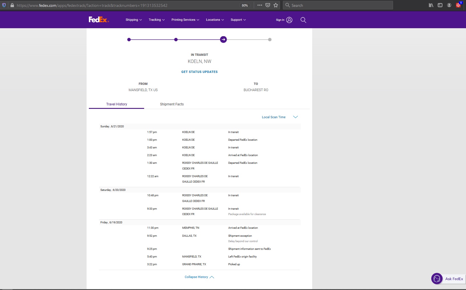

Seems the shipment is moving faster than I expected, it will be here before I'll have the coils supports ready...

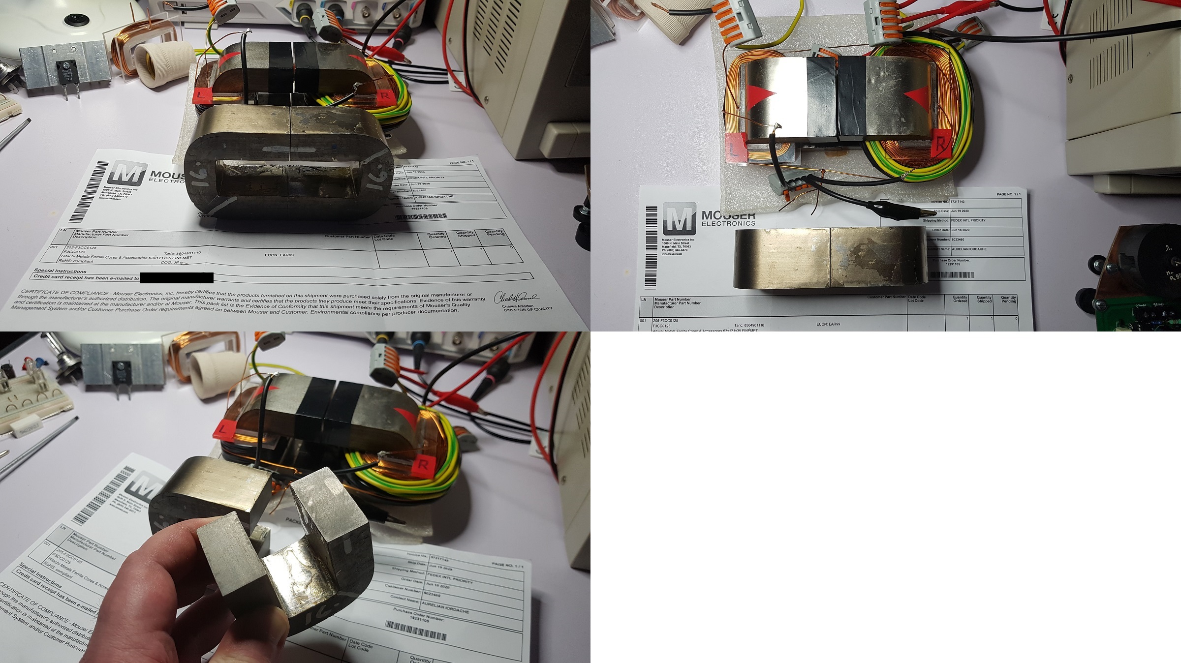

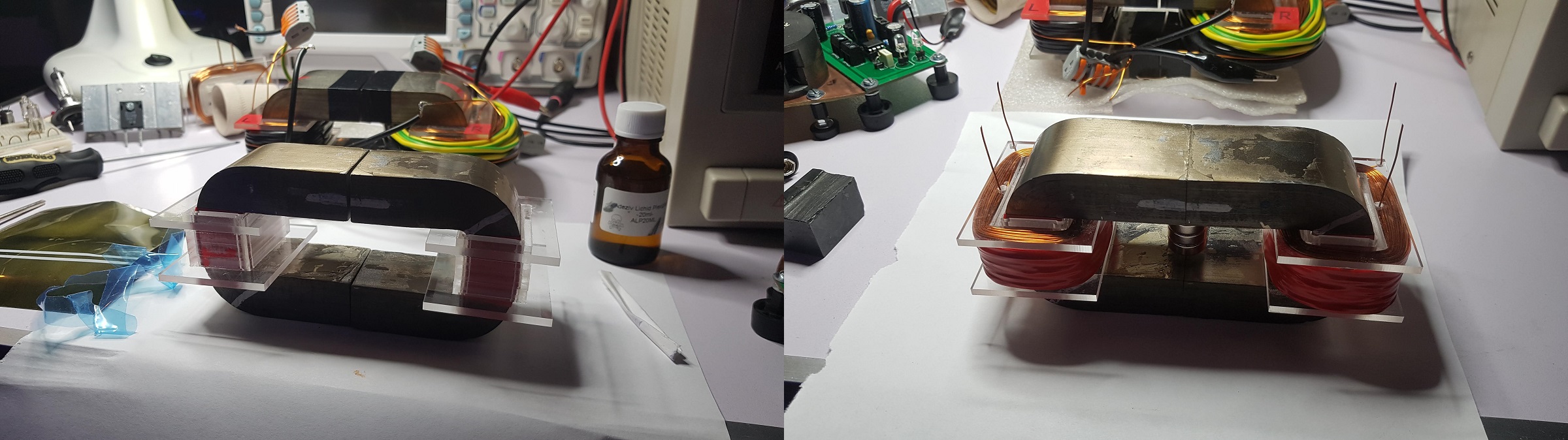

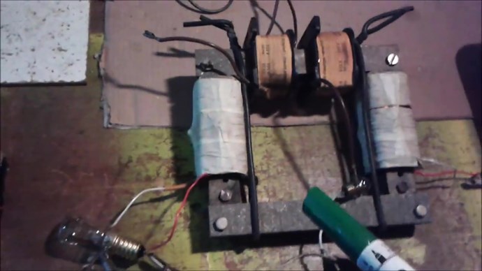

This was fast, it arrived today.
This one is smaller than AMCC-200, it's less wide - 35mm, while AMCC is 50mm wide.
It has some darker coating on it (probably against rusting) but inside the coating is not uniform so the alloy can be seen, it's white-shiny just like Metglas, visually seems there is no difference between amorphous and nano-crystalline alloys.
Few photos (link to larger image here):
I already sent an email to the CNC firm with the modified schema for coil supports (link to larger image here):
Let's see how busy they are, hopefully they can add my small order to their production schedule.
The difficult part will be to find a matching magnet for this core strong enough but not very strong so when placed inside the core its magnetic flux will be captured entirely by the core so it becomes (almost) inert but in the same time its magnetic flux should not be that powerful so it can escape from the core and flow around the core.
This will be tricky as I need to find this magnet online and I'll not be able to try it. From the original MEG images seems neodymium magnets are too powerful, seems Bearden used a ferrite magnet:
I'll try to find a matching ferrite magnet by dimensions, hopefully it will match the core magnetically too.

The pieces for coils supports are ready, I just need to find time to assemble them (link to larger image here):

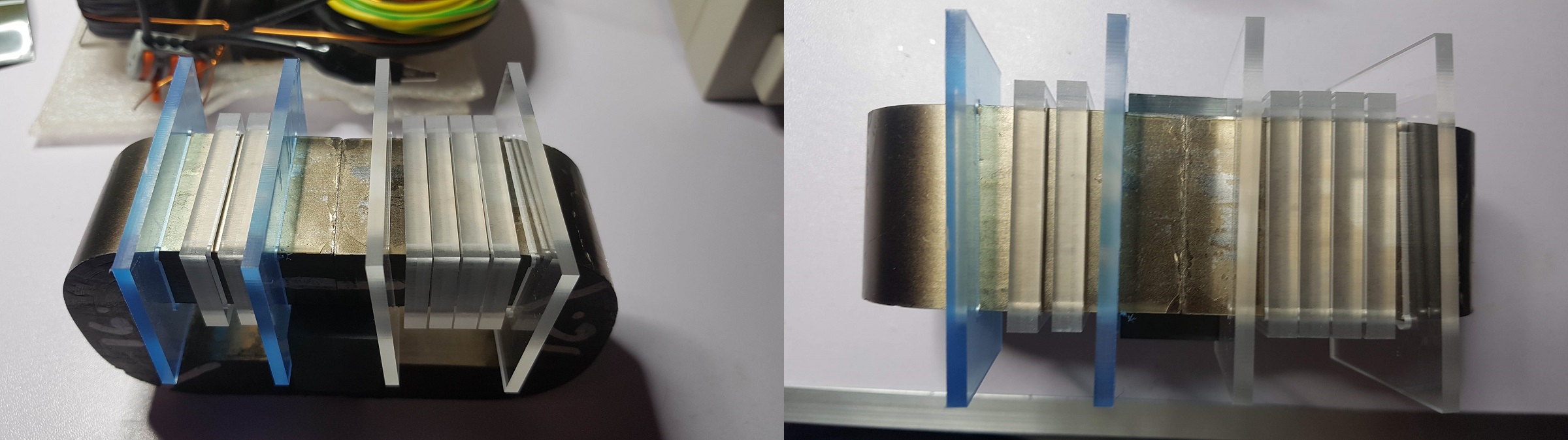

I was thinking about Dale's recommendation ("Make the ferrite a bit smaller than the dimensions of the core side to side. Having the edges line up is counter productive, and allows leakage of flux very easily.") so I searched and I found on local market a 20x20x25 mm ferrite magnet and I placed the order, it should arrive within few days.
Also I searched for a way to make the magnet modular and I found and ordered a few packs of 7x7x25 mm ferrite magnets from UK. This way I will be able to add/remove this kind of magnets in the center of the core while searching for a matching magnetic force for the core. I don't know how fast the shipment from UK will arrive, hopefully I'll receive it within few days too.

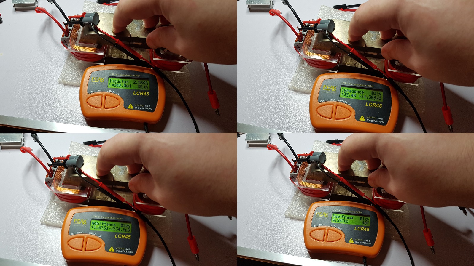

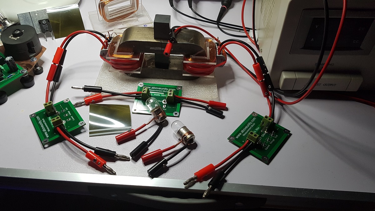

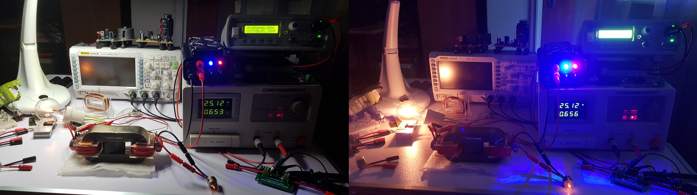

First, I'm posting the characteristics of the coils as measured by my LCR, here you can see only the left coil but right coil is almost the same, there is just a difference of +/- 10 turns (link to larger image here):
I've built assembled 3 of measurement blocks made by Chris and I've built a flexible circuit with connectors and wires so I can easily attach loads (12V/5W light bulbs) and easily insert measurement blocks in the circuit when required (link to larger image here):
Also I received the two 20x20x25mm ferrite magnets I bought from local market. The small 7x7x25mm ferrite magnets I ordered from UK just entered in country, seems they are transported on ground by truck so probably I'll receive them someday in the incoming week.

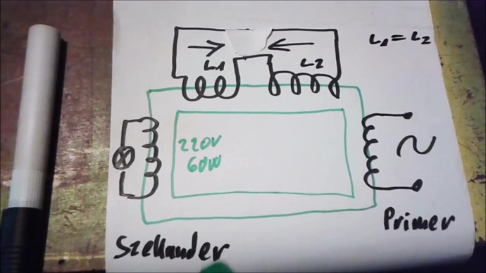

So the plan with these two similar coils was to make first a standard 1:1 transformer and then to experiment with different magnetic force and to observe eventually a increase in the power on the secondary coil (the coil on the right side).
Well, seems like the 250 turns using 0.6 mm copper wire are not okay for a 1:1 transformer with this core. The 12V/5W light bulb on the secondary (right-side) coil is not working at all when powering with pulsed 12V the primary (left-side) coil no matter what frequency or duty-cycle I use. I had a conversation with Cd_Sharp and seems the 250 turns are too much for the coils.

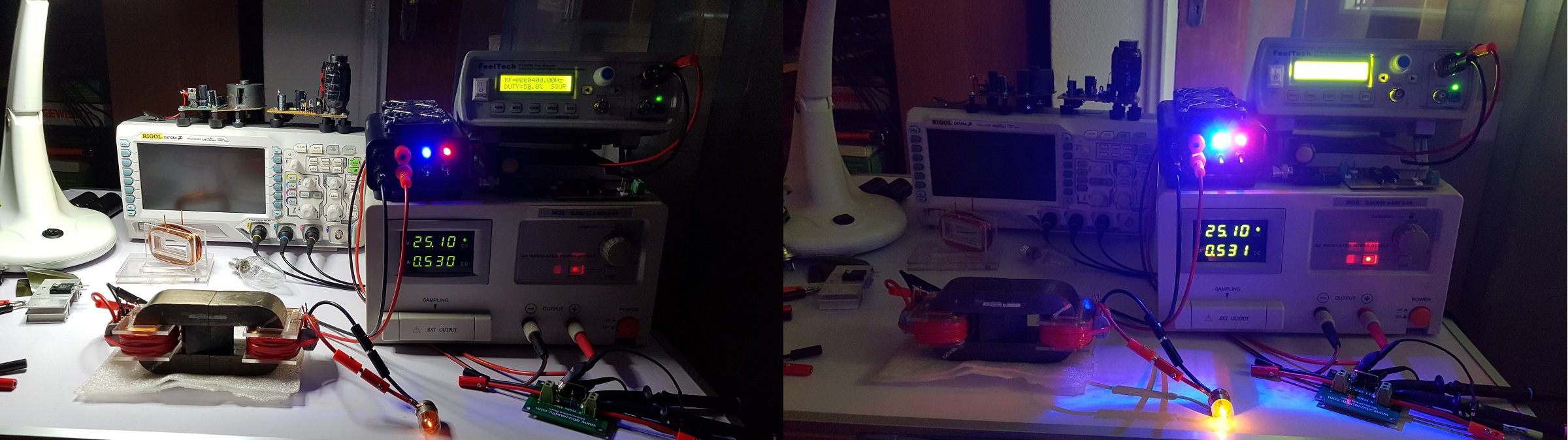

The light bulb start to shine only when I use pulsed 25V with 500Hz and 50% duty-cycle (link to larger image here):
But what I found out in this configuration is, even if the light bulb on the secondary (right-side coil) is shining very weak, I have high voltage back-EMF on the primary (left-side coil), if I put the 220V/70W light bulb in parallel on the primary coil I have it shining, it's weak but still it's a 220V/70W light bulb ! (link to larger image here):
Notice the consumption seen by the DC source (not sure how accurate it is) is just about 100mA higher.
And a note: the primary coil starts to warm up slowly in this configuration.
So right now I have a problem with a standard 1:1 transformer which is not working as expected but which unexpectedly creates a pretty strong back-EMF in the primary.
I'll need to figure out and fix the 1:1 functionality issue and to figure out what;s with that back-EMF.
