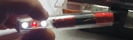

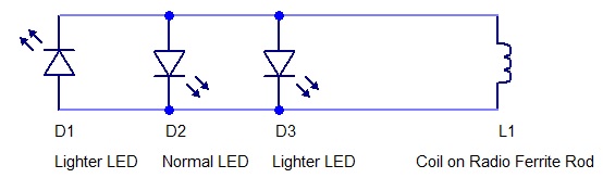

Sure, this is the schema of the tester:
The details can be found on my post above made on 16th July 2020.

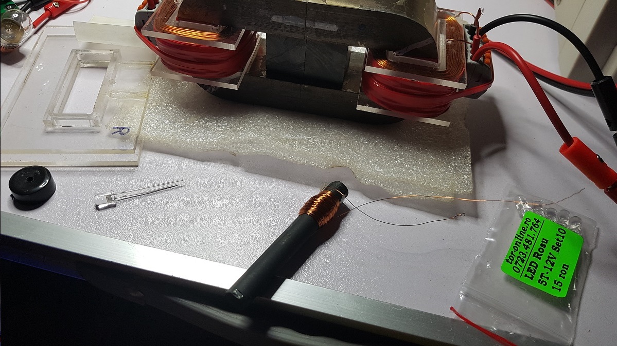

For the coil I used 0.2 mm copper wire but I didn't counted the number of turns, I just used some wire left from other experiments.
Looking at the photo I took at that time could be a few hundreds of turns I guess (link to larger image here):

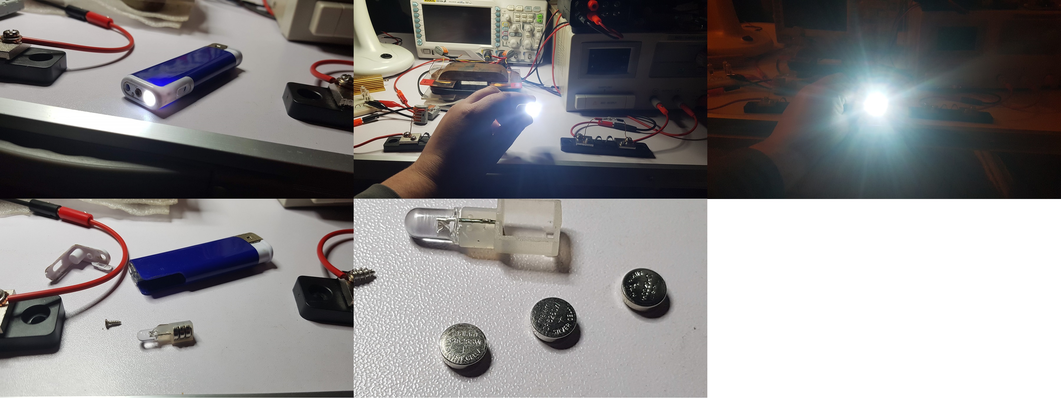

The "normal LED" (red color) is an 12V LED, the other two LEDs (while color) are more sensitive (I suppose they have very low voltage) and I took them from some Chinese lighters like this (link to larger image here):

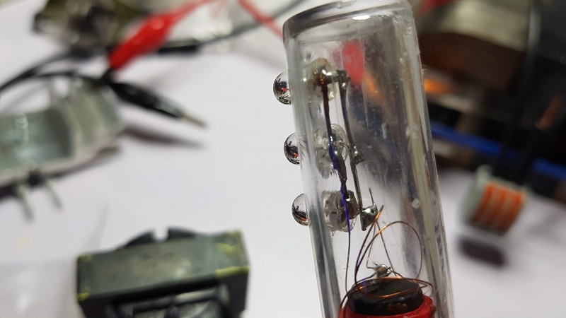

And this is a photo of how the LEDs are connected inside the tester (in parallel) just the top white LED which indicates BEMF have inverted polarity than the other two LEDs (link to larger image here):
Before soldering the LEDs to the coil output you must test their polarity to make sure they are indicating correctly, meaning the top white LED is indicating BEMF (magnetic south pole) even if it's weak and the other two LEDs below it (red and white) are indicating EMF (magnetic north pole). The 12V red LED is actually indicating how powerful the pulsing N field is while the white LED below indicates just the presence of the pulsing N field even if it's weak. If it's a weak pulsing N field the red LED's light is weak too or even off.

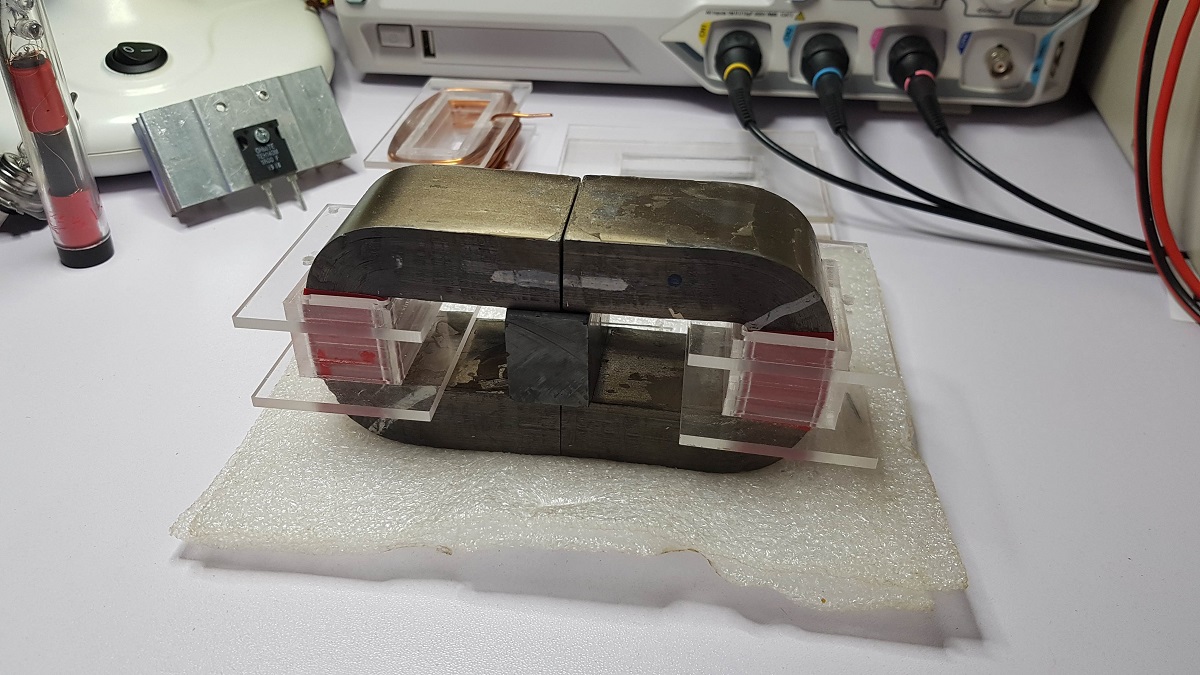

Again, I took out the old hypersilicon transformer layout.
There is no permanent magnet right now. (otherwise it doesn't change anything)
Since the metal oxide varistor has a capacitive character, I loaded the output coils with a capacitor.
Yes, it’s such a barren performance, but now I’m specifically focusing on it.
I was wondering to what extent the current was charging back to the power supply.
How the voltage of the drive coils changes.
How the shape of the current changes.
How voltage and current change together.
As well as the extent to which the oscilloscope figures show similarities to those given by Naudin and Bearden, respectively.
As expected, the output coil affects the input coil. This is not necessarily a bad thing.
But as a result, recharging may appear on the power supply.
Energy reflection is not what we have seen so far. So recharging doesn’t occur to such an extent. But that's a different layout.
Separation of magnetic fields cannot be achieved with this arrangement. (as reactive power is seen in video or other layouts)
Some snapshots of the layout.
