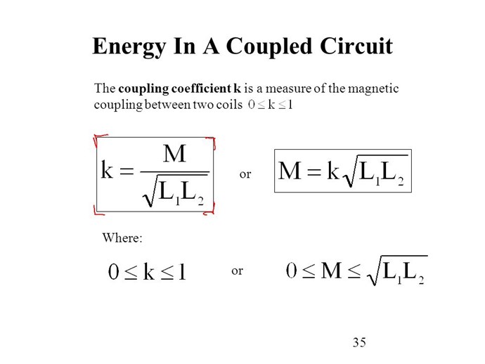

Coupling Factor is a big problem, as Coils are further away from each other, the Coupling falls off sharply. Unity Coupling, where one coil is wound on top of the other, normally Secondary wound on top of the Primary, achieves this Unity Coupling.
Unity Coupling in most cases is modeled as 1 when in reality it may be 0.95 or something. 1 is max, 0 is min. I am sure others here can elaborate further on this if you need more info, Jagau, Vidura or YoElMiCrO or someone. I believe YoElMiCrO was pointing towards this Here.

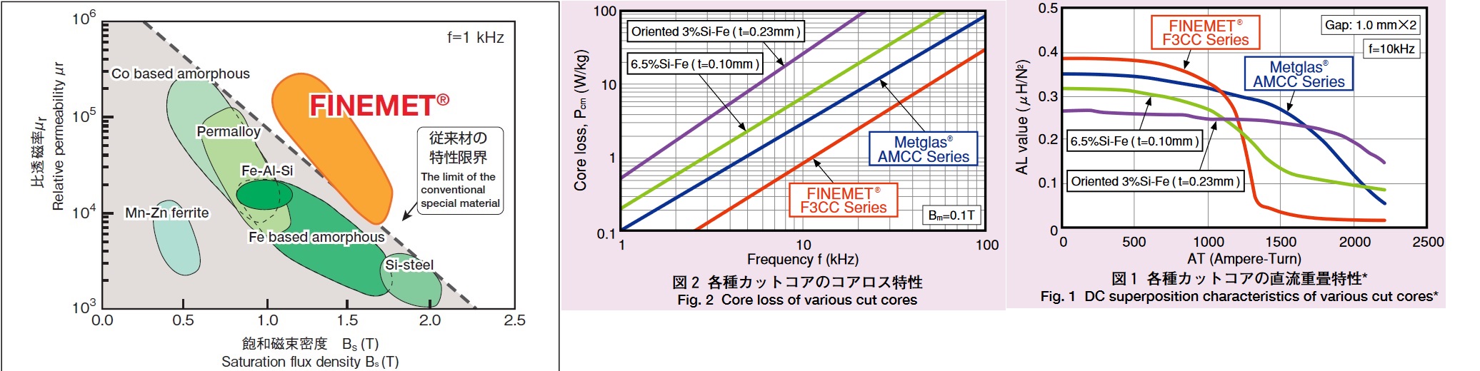

Hey Fighter, any initial thoughts on the use of Finemet for these experiments? Are you seeing anything to indicate it is worth the price?
Hi UndisclosedMember,
Talking about standard transformers, the price is justified by the properties of the alloy, it's superior to Metglas alloy (link to larger image here):
The core that I have (F3CC0125) is the biggest in these series so it can be used to replace a bigger Metglas core (maybe even AMCC1000 ?) with smaller AT (Ampere-Turn) and smaller core losses.
So I think this is how officially the price is justified.

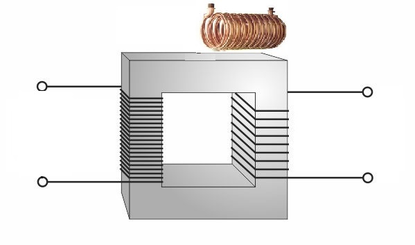

We all know how a transformer is made. What happens if we have a coil which is not around the core like this ?
Will it receive any voltage or current on it ?
The question could be seen as stupid but it's not, the reason I'm asking this is because I'm looking for a way to detect/measure a electric field formed outside of the core.
The hypothesis is the scenario described by Bearden: outside the core is present a uncurled A potential (Aharonov-Bohm effect) but in order to detect it we need to disturb it by applying sharp pulses in the primary so it starts producing electric (not magnetic !) fields.
So the coil from the figure above will "ignore" what's going on in the standard transformer and "see" only the electric fields formed outside the core ?
I need something like this in order to find the right magnetic field (from permanent magnets) required for the core to have the Aharonov-Bohm effect manifesting and producing uncurled A potential outside of the core. Without this I have no way of knowing if the Aharonov-Bohm effect is actually manifesting or not in my experiment (the magnetic field from the permanent magnets could be too weak or too strong).
Do you think this could work as intended ? Any other ideas are more than welcome !

It is always worth to try (intuition tells you may not see much), but I would suggest (as according to Hector's teaching) to wrap coil(s) fully around the core to detect radiant pulses. You will see peaks on scope. When this happens have LC around the core to tap.
Fighter posted this 12 July 2020
The idea is to have a coil (detector) which ignores what the classical transformer does. Wrapping this coil around the core will make it sense everything including the magnetic field pulsing in the core. I would like to avoid sensing the magnetic field inside the core. I just want to see only the electric field (not magnetic) forming around the core when the uncurled A potential is disturbed by the pulses coming from the primary. Maybe I didn't understood correctly your idea ?
This is a case of Coupling, if there is Flux that Couples the Coil you mention, to "Generate" a E.M.F or Voltage, because E.M.F is measured in Units of Volts, then a Current will Flow.
Normally, very little flux is outside the Core, but with Bucking Coils, we can have more Flux compared to normal, especially in loose coupled situations, E.G: Not Unity Coupled.
Best wishes, stay safe and well My Friend

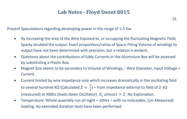

Of course, Floyd Sweets Lab Notes are well worth studding! What is contained here is very important start!

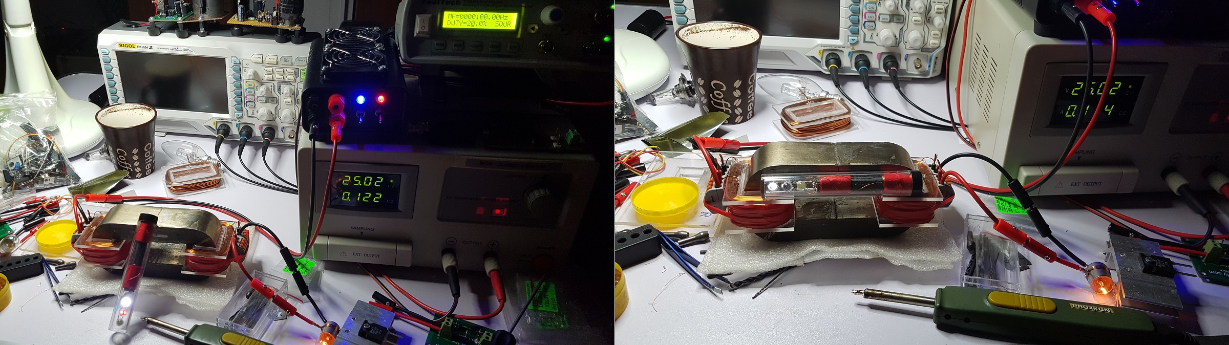

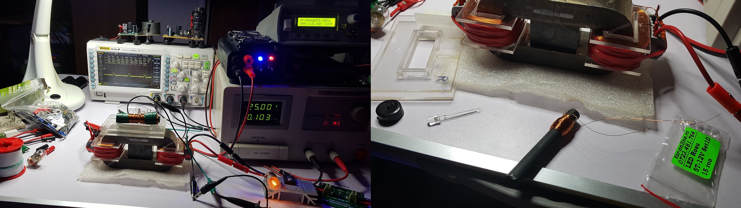

Meanwhile as you know I was looking for a way to find out what's happening around this device while it's powered so I did some experiments (link to larger image here):
So I come up with a very simple but extremely helpful tool not only for this device but for all our devices.

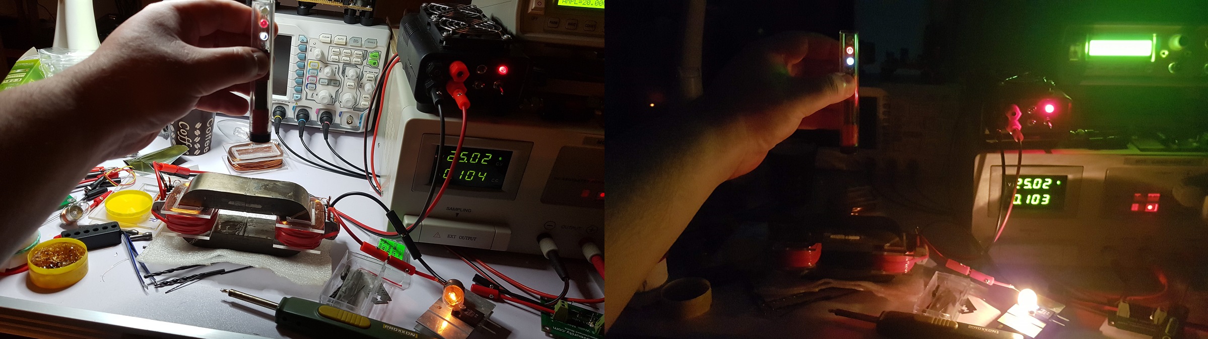

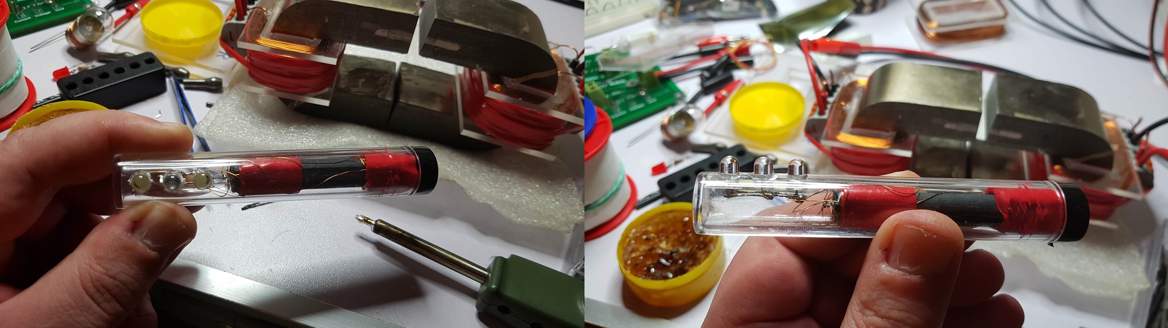

I'm using a ferrite rod I have from a radio, a coil on it and 3 LEDs connected to the coil: two having the same polarity and one having opposite polarity. The red LED have higher voltage (12V) so it's less sensitive but can indicate the strength of the pulsing magnetic field. The other two white LEDs have lower voltage (4.5V, I have them from some Chinese lighters) so they're very sensitive and can indicate magnetic polarity. Also because the core of the coil is a ferrite rod it can indicate the direction of the pulsing magnetic field. I tested it within 50Hz - 100KHz range and it works.
So if around a device there is a pulsing magnetic the tool is able to show that magnetic field's strength, direction and polarity.
It also can be very useful to see if your device is spilling magnetic field in space like in my case where the coils I've made seems to be too powerful for this core (I'll need to rebuild them).
This is how I've built this tool (link to larger image here):

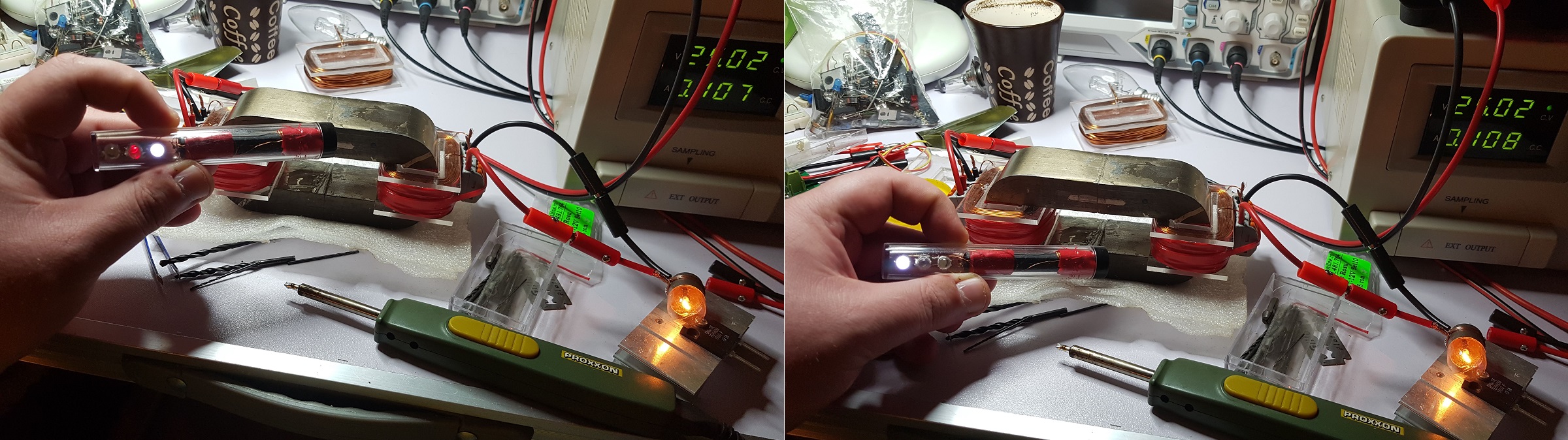

Here is indicating the magnetic North and South poles, for North indicating also the strength - the red LED:

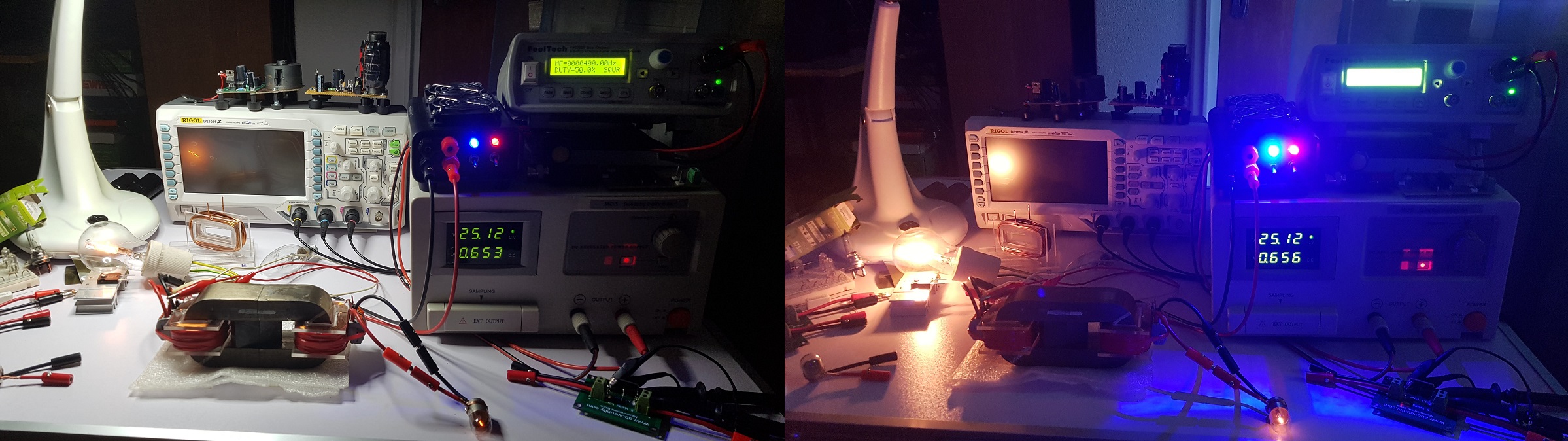

And here it shows how much magnetic field my current configuration is spilling into space, so I'm sure now the A-B effect is not present with this configuration, I'll definitively need to rebuild the coils (link to larger image here):
So if you need to check what's happening outside of your device a tool like this could be very useful, if you have questions about it please let me know.
