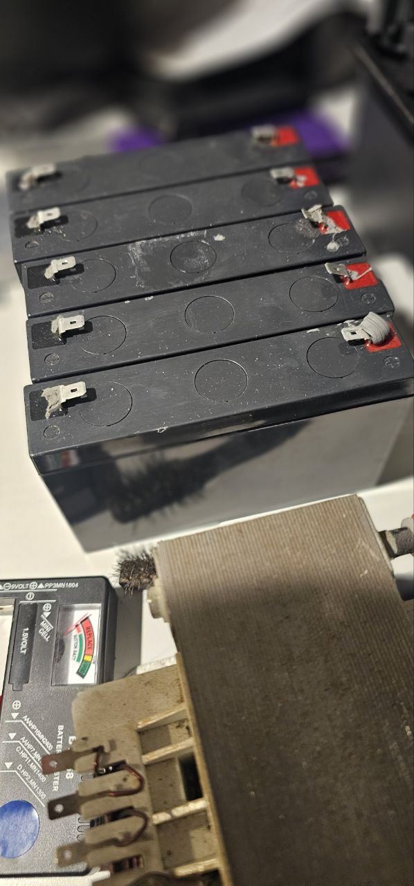

It is likely that you can restore most batteries. It may take a lot of time if very heavily sulfated, or if there is a metalic short from internal rust it may not fully charge.
I am surprised how many I have recovered. It has restored larger batteries beyond the listing on the charger cover.
6V UPS batteries that were dead and given to me from an IT tech:
I plan to make a battery bank for experiments that will have a 6V incremental voltage selector.
I have recovered 12V and 6V UPS batteries, but they must be soluble inside. If the gel gets too hard you may not be able to revive it. Pry open the seal and pop each rubber cap off of the cells. Add distilled water just below the opening.
The setting for those type is #6 on the dial. If the battery acts shorted and pops the circuit breaker, reset it and turn down the dial until cells come up to the right voltages: 2+, 4+, 6+, 8+, 10+, 12+.
I can usually get most to come up to 10 -11 volts and then it takes longer to get the + side cell to desulfate.

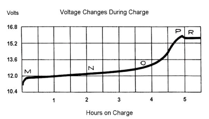

Most standard chargers stop charging at 14.8 V the charge is incomplete according to this table:
John Bedini says:
If the charge process is stopped before point "P" is reached, it means that some sulfate ions are still left in the plates. If, for any reason, the voltage is prevented from rising to the finishing level, the charge will NOT complete.
This is another "little secret" of the battery industry. By limiting the voltage that most battery chargers provide to 14.8 volts, they know that the batteries will only last for a certain number of cycles, because a small amount of the sulfate ions are (purposely) being left in the plates at the end of each charge.
So, repeated incomplete charging is what causes most batteries to fail. A lead-acid battery that is charged to a finishing voltage at the end of each charge cycle can easily operate for 5,000 charge and discharge cycles, which is over 15 years of service. This is how to make your batteries last a very long time.
I have been managing a fully solar-powered radio communication network for several years, and I can confirm that following the Bedini method by reprogramming my industrial-type charge controllers to the values ​​recommended by JB has resulted in my batteries lasting on average between 12 and 14 years. I know it sounds incredible, but I have experienced this for several years. The batteries (lead acide) don't have time to sulfate with this charging principle. For some sites, I use the programmable Morningstar PS30M charge controllers.
PS Information and image taken from the book The Complete Beginner's Handbook page 76, buy it, it's a plus.

Interesting stuff. Makes you wonder if the people that make "conventional chargers" actually know about this curve and stop the charging intentionally at 14.8V.

Jagau, you are correct.
Also, the large deep cycle batteries can refuse charging at 1.9V per cell. I recently experienced this. All the pressure beyond that will not keep a 2+ volt charge. The Tesla pulsing technique makes all the difference when reviving those cells. I have to use the 2V radiant rejuvenator to break through that barrier.

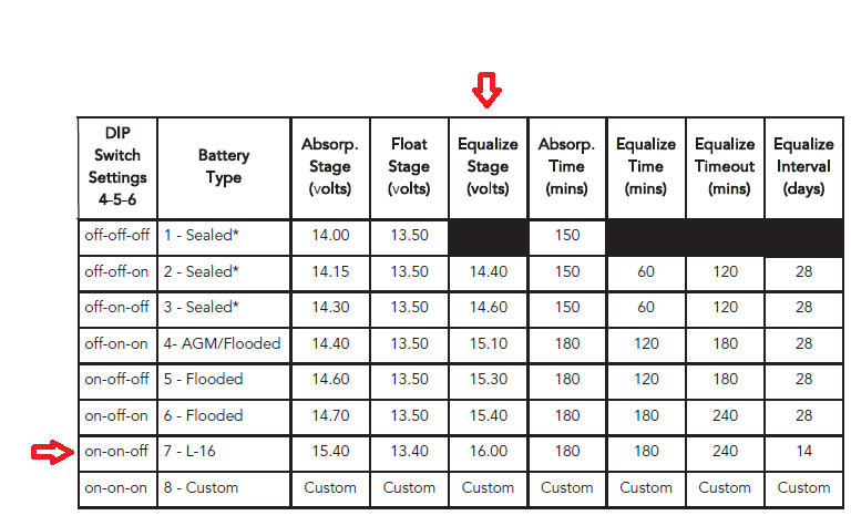

What set-points are you using for the chargers?
If you look at the specs of the PS30M here:
The L16 series goes up to 16.75V. So, as JB said, he was absolutely right.
You just need to program it in the right place. What is important when charging a battery in order to get the maximum is its equalization time which comes immediately after the absorption time.
 Yes, these are high-quality controllers programmable at home or remotely; a host of other options are available with curves, so you get your money's worth. Note that like JB I only use deep cycle batteries of the flooded lead-acid type. We've strayed a bit from the Adams topic, but it's for a good cause!
