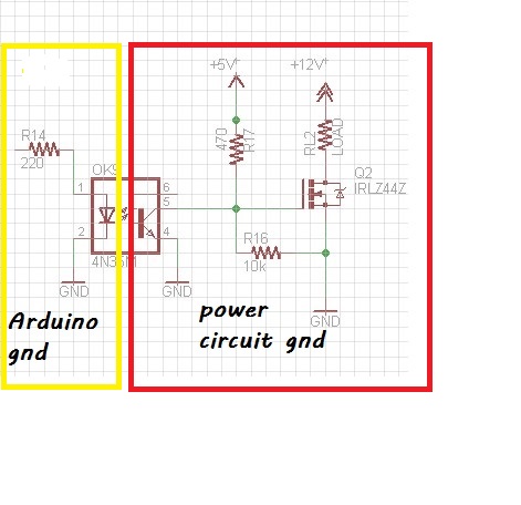

When connecting an Arduino model to power circuits, it is best to isolate its mass so that it is different from that of the power circuits. Here is a perfect example suggested by Arduino forum, that I have tried and works great.
With a low side connection and the two grounds well isolated by optocoupler. We can add to the output of the opto, the two NPN PNP transistor configuration to improve gate speed of the N-Mosfet

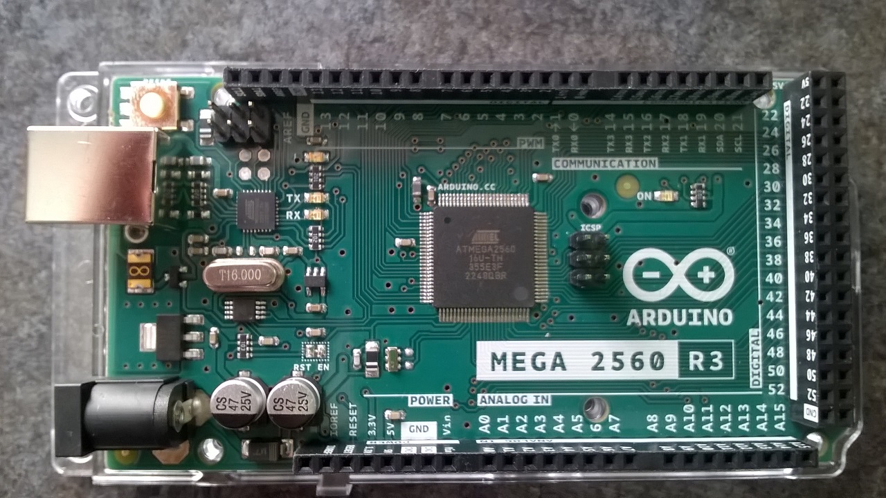

Jagau posted this 27 February 2024
Hi All
I ordered lately a new Arduino mega 2560 rev3 board that has multiple outputs for PWM.
I'm going to share here using this particular new board on the Adams motors which I believe is a good example of using Arduino and talk about mosfet driver other thing like that.
I hope to have some members interested in coming here to discuss while waiting times and in order to improve our knowledge of Arduino.

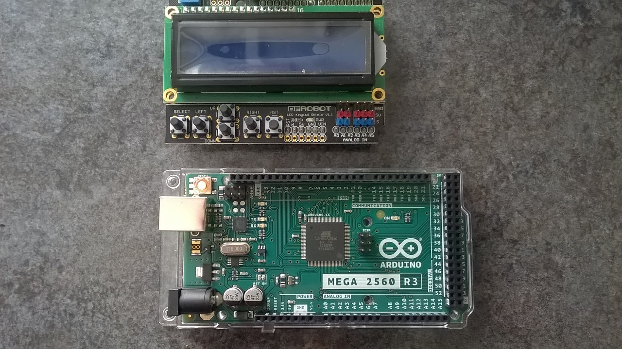

I received my new Arduino mega 2560 R3 board
With an LCD display shield card
The board contains 54 digital input/output pins, 16 analog inputs, 15 PWM Output, really interesting.
 The first tests on the Adams engine will follow soon with speed support with a hall effect sensor and Mosfet for faster switching.
