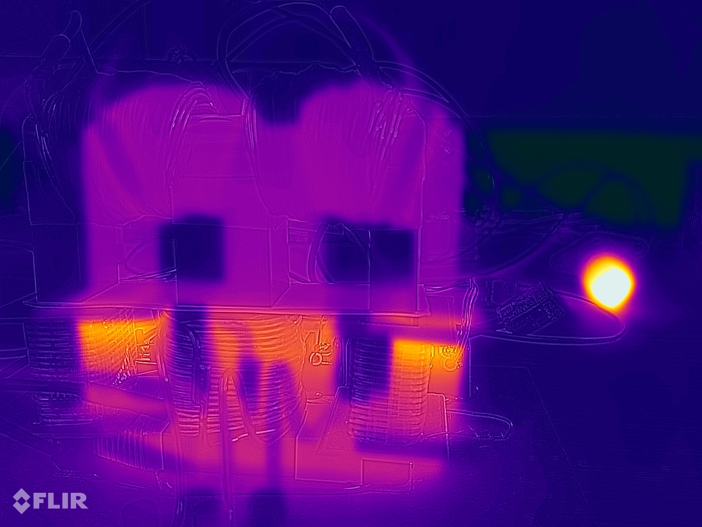

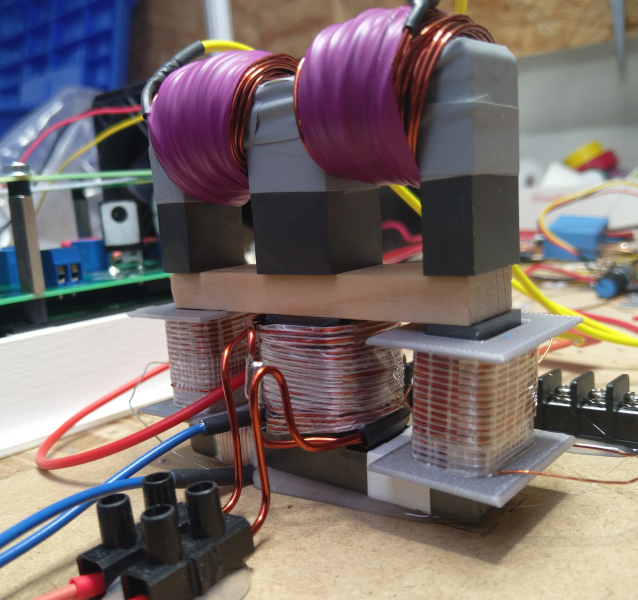

i like to show you my observation when it comes to opposing coils. in the picture you can see 2 e-cores (3C95). the bottom one is my primary side - i do a lowside switching of a bifilar wound coil which is placed on the middle leg. the coil on top represents my secondary side where i wound the coil in opposing style.
the switching frequency is about 90kHz. in this configuration i can have a load on the secondary side, but on the windings there will be no heat!
this is how it looks like,,,
you can see the load which is driven by 'cold windings' on the right side.
this is by the way my replication attempt of Andrey Melnichenkos field-copy-lesson.
if you like to see a video you can watch at https://odysee.com/@tankcircuit:a/VID_20230109_132111
regards!
cd_sharp posted this 08 February 2023
Awesome work, baerndorfer! Melnichenko is a legend. He has hundreds of videos, all worth watching. Thanks for sharing!

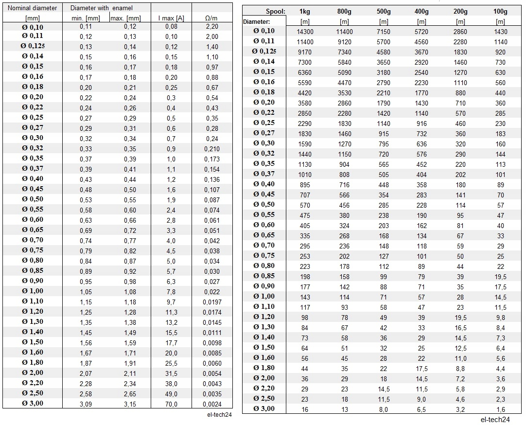

Shadow_ posted this 26 February 2023
Hello
once on the website of the manufacturer of copper windings I found such a table
Regards Gandalf
