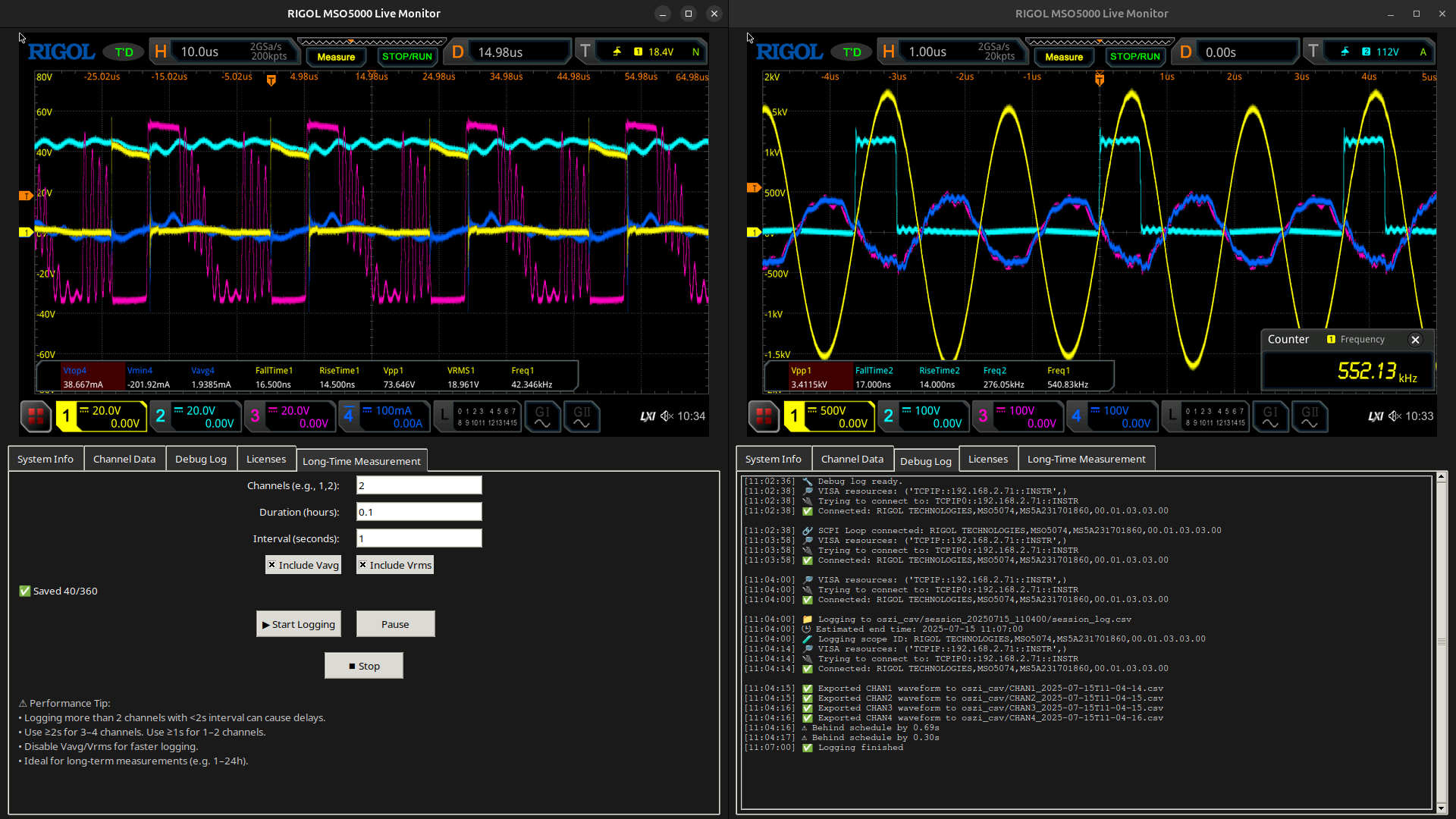

because i was not very satisfied with Web-View from Rigol for my MSO5000 i build my own one.
This tool provides a live view and SCPI-based data extraction from a **Rigol MSO5000** oscilloscope with **hacked firmware** via VNC and VISA (SCPI) interfaces.
The script displays:
- Live screenshots from the oscilloscope (via VNC)
- Channel information including coupling, bandwidth, scale, offset, and probe settings
- Trigger and timebase settings
- Raw waveform statistics (Vpp, Vavg, Vrms) for up to 4 channels
- A scrollable debug log for diagnostics

i made an update, so that we can extract channel-data from scope.

the last version includes 4 tabs with lots of data..

Jagau posted this 14 July 2025
Hi Baern
This is what I currently have on my oscilloscope.
Same as yours.
As for programming, I'm not knowledgeable enough to play around with it. I'll just stick to the first result, which is excellent, as in the photo. Thanks anyway.
baerndorfer posted this 14 July 2025
you made it which is excellent! 😀
the new version can handle multiple oszilloscopes and we can do a Long-Time-Measurement to get data out.
it works for a single channel and i try to make it work for all channels simultaniously which is difficult because of scpi and tcp limits.
when there are no more bugs i will upload this new version.
thx for testing!
