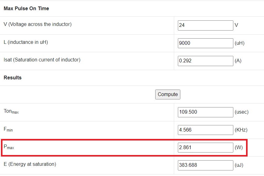

On the following site there is an online calculator that can make your life easier, just enter the first 3 values, voltage, inductance and current, you won't have to do any calculations and that's what I explained above.
https://www.daycounter.com/Calculators/Inductor-Current-Power-Calculator.phtml
These are maximums or minimums that you can reach so you can go more or less according to these forecasts.
if we take example of my last demonstration
24V, 9mh, 0.292amp
the site indicates the i can reach up to max power drawn at thei nput by this inductor  2.861 watts with DTC max of 50% as they suggest
as I used 38.2% DTC and 1 Khz and I got 2.5 watts as I demonstrated, so I could rework my circuit to achieve less input consumption.

Munny posted this 14 December 2022
I like where you are going with this, calculate the power ceiling on the input based on the fixed parameters.  Then you know there is no possible way you could draw more than X watts.  That makes any COP dead simple to know if you're going in the right direction when tuning.
I like it!   I like it a lot, though the site won't let me give you two thumbs up.  😜

Yes that's what coilcraft a great coil manufacturer uses to know the maximum can be reached, they code their inductors with the maximum but nothing prevents us from using them below their saturation point and that's the same thing for the DTC it is the range available before saturation which is useful, it is the maximum not to be exceeded.
