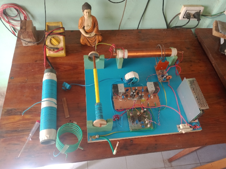

Hi all.
Update: In order to make a series of tests to learn about the interaction of the two resonators, I have built this board. It allows an easy exchange of components and coils, while maintaining an ordinated layout.
As stated before, I am very busy this time of the year. Additionally I had  a lot  of offline time lately, due to a server problem. But finally, I could do some tests.

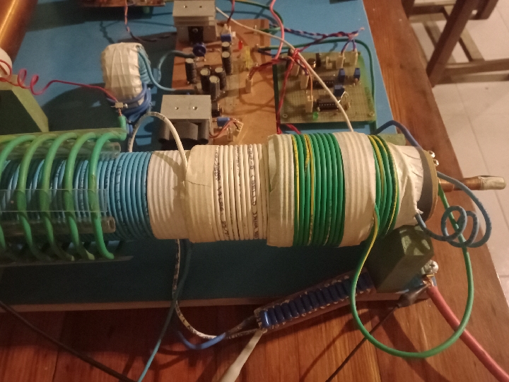

Here you can see the parts inside the main rwesonator. Still I did not get the expected results, when the HF pulses are activated ,the amplitude of the mainresonator decreases instead of increasing. regardless of the timing of the signal. So I guess there is some issue with the feedback, but with patience and persistence it will be solved. As time allows I will continue and troubleshooting why the increase of the oscillations is not present.

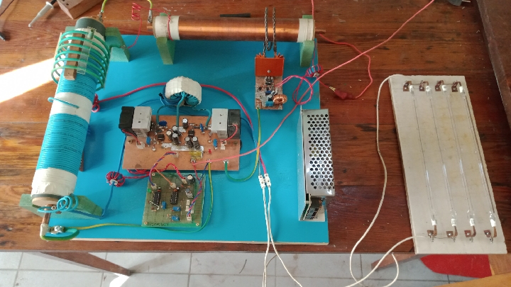

No, I didn’t take scope shots yet, just played around with various configs. Some more details: First I tried to put the load in series LCR in the main resonator, but the push pull could not bring up the oscillations as the dampening of the load resistor is way too high. It might be possible by increasing the secondary voltage of the toroid, at the cost of pumping much more power into the circuit. Then I added another winding for the power removal:
it is wound over the inductive part of the resonator, with some extra layers above the ferrite rings with a step-up ratio of 1:2.5
As result of the decoupling the push pull could oscillate, although dampened when loaded. Also I swapped the windings, connecting the new coil to the push pull and capacitor, but all tests with the same result, that is the amplitude was decreasing when the HF pulses turned on.
In the next video I will document this and hopefully something more...
