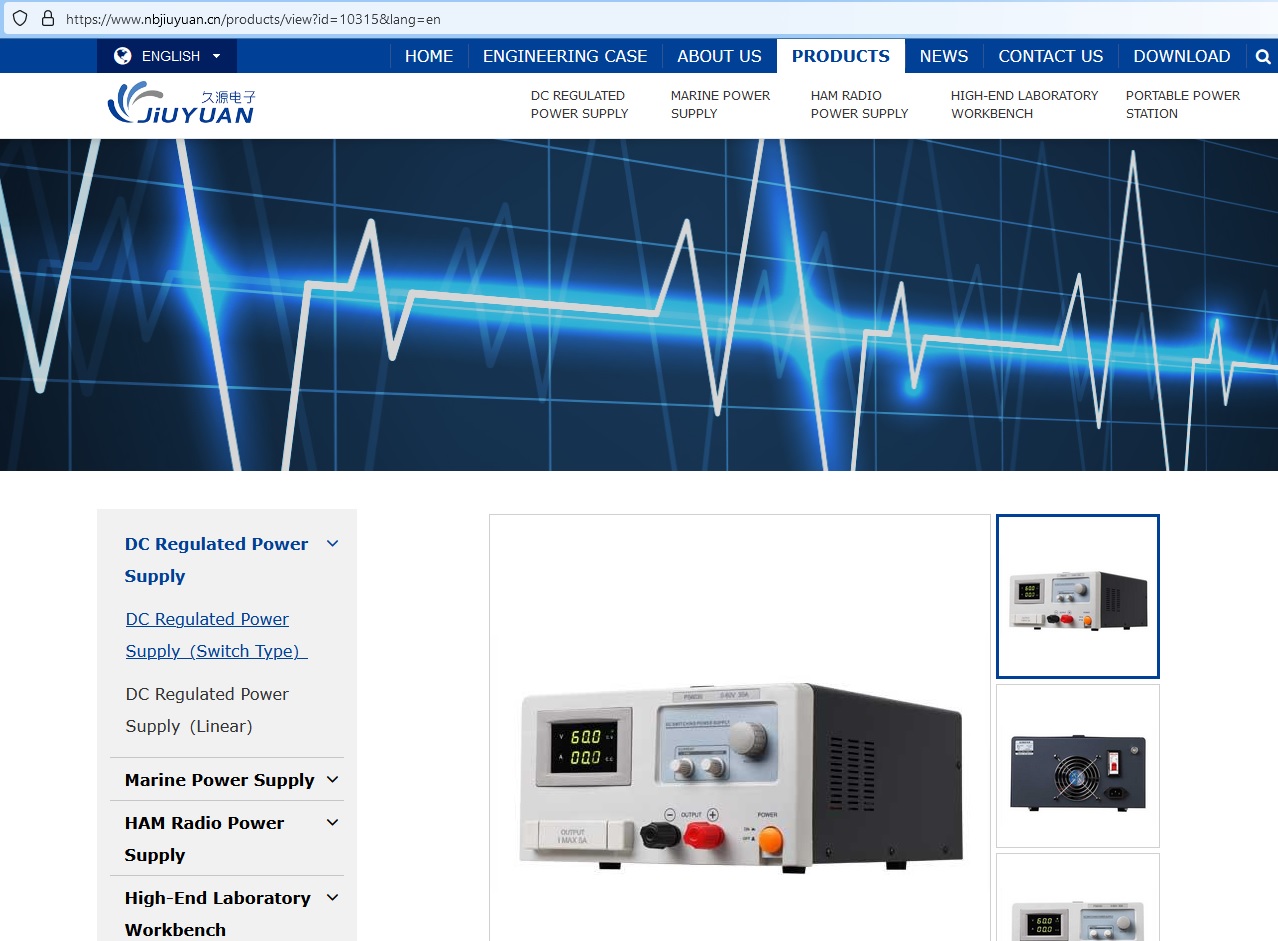

Fighter posted this 18 November 2022
I'm sorry but I don't have the messages containing links I exchanged with my friend at that time but I remember well it's switching.
From the wikipedia link: "Unlike a linear power supply, the pass transistor of a switching-mode supply continually switches between low-dissipation, full-on and full-off states, and spends very little time in the high dissipation transitions, which minimizes wasted energy. A hypothetical ideal switched-mode power supply dissipates no power. Voltage regulation is achieved by varying the ratio of on-to-off time (also known as duty cycles)."
When I modify the voltage or the load is requiring more current I hear a specific "click" of (probably) an internal relay or something like this inside, this is how it worked from the beginning. I asked my friend at that time and he said "it's okay, this is how they work, mine is doing the same".
Unfortunately I don't know the manufacturer's site to check there but I found another clone, it's like mine just a bit different buttons on the panel, its manufacturer specify it's switching type, not linear:

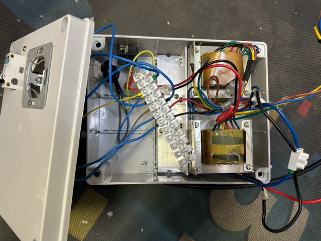

I got some inverters and built an isolated transformer from 2 transformers from an old broken UPS. Works well for powering the scope, I also add a ground switch so I have all the options available. Still have to experiment a bit with different PS the best result was with the one minus connected to ground.

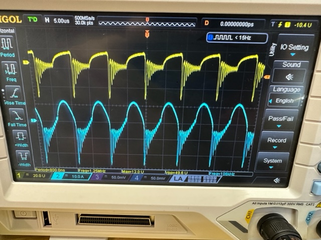

Today I played it with a ZPE with different loads but not getting the low power consumption like expected. The waveform is from the coils; the bulb is 50W low brightness and 1.7A 25V from accu.
Have a great day or night, e
Fighter posted this 30 November 2022
That's exactly the ZPM waveform pattern, its signature.
I don't understand why you don't get the input decreasing effect...

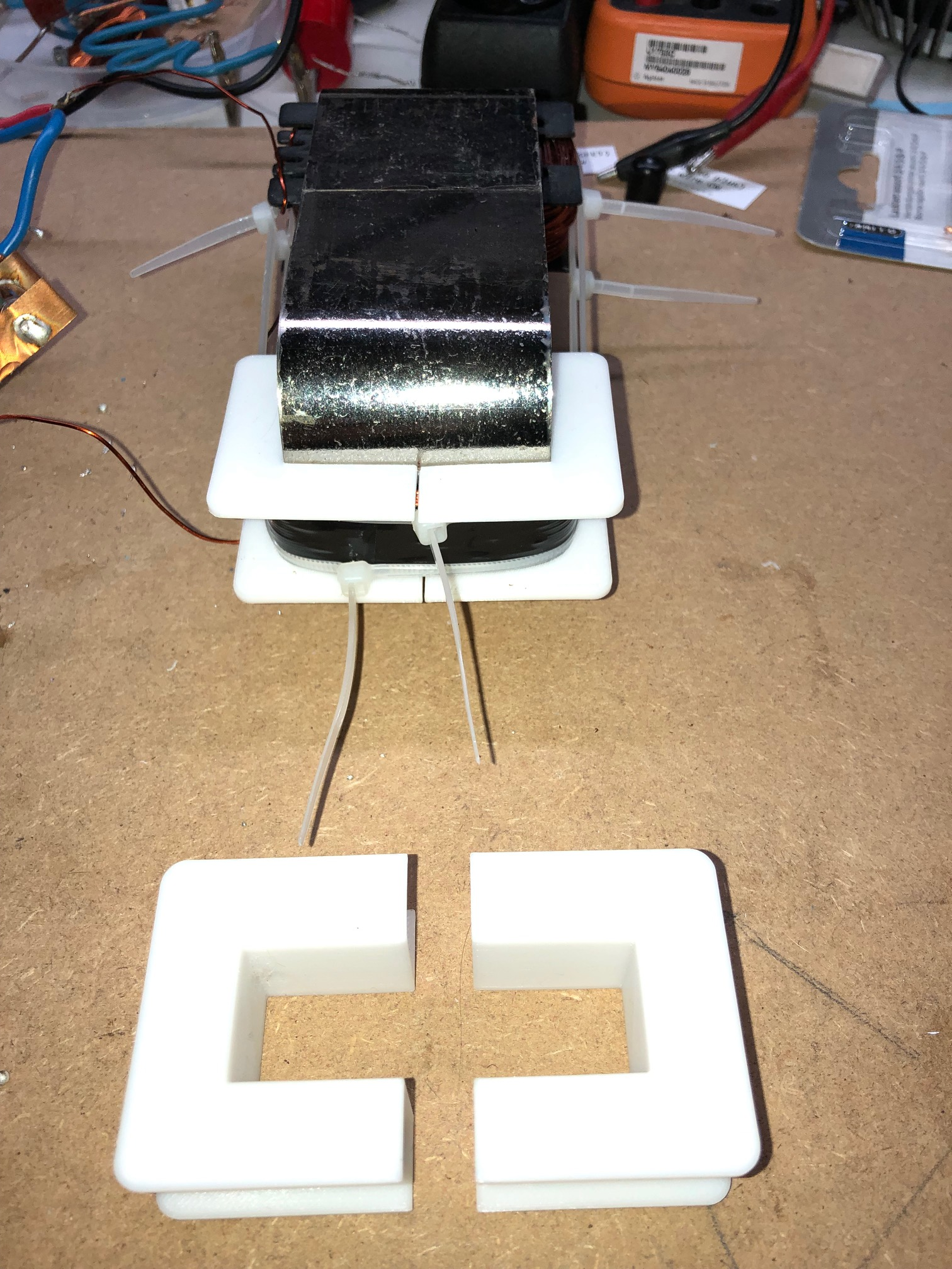

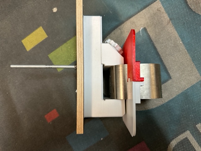

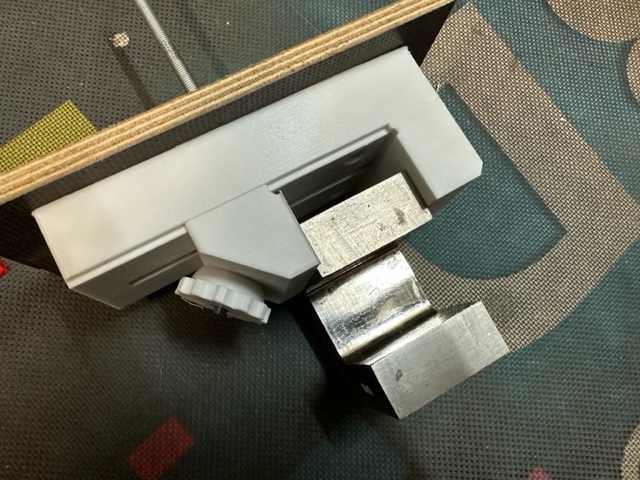

One of the things that I like to try is also positioning of the coils. So I'm in a process of building the new formers
and a 3D printed vise for helping with winding the wire. (AMcc 320)
4pcs part, showing just 2
br, e

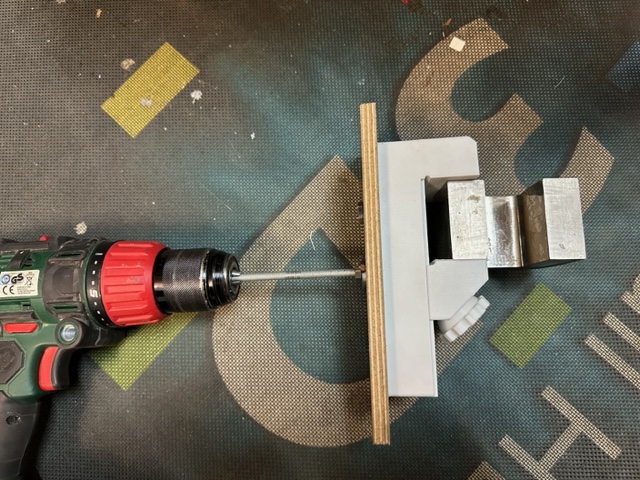

looking nice, could you tell somewhat more about the Vice?

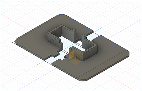

I also have designed formers for my AMCC 200 core (on the far ends) as can be seen here:
The .stl files (left and right) are attached below (AMCC200.zip)
I also made some .stl files for the AMCC 320 core (left and right), also attached (AMCC320.zip), but be aware i have not tested them on a real core so there could be some mistakes / margin errors.
If needed i also have the Gcode files for a Prusa MK3 (Prusa slicer) PLA, no brim, full support.
editor posted this 06 December 2022

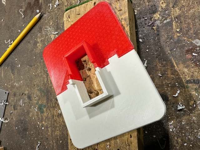

looking nice also, maybe I'm complicating too much. Well see. Tomorrow the Petg is arriving to get the better, stronger formers. Until now I was printing with PLA. I was also checking the RF performance for the PETG and It looks good from 0 to 30Mhz. Check the video:
About the vise, I was thinking how to wind the coils as quickly and simply with some control, maybe some day I have to with 10-20 coils in a hurry for family and friends so I have to have that in mind too.😁
It is still just an idea, but like you can see on the photos I took the vice from here:
https://www.thingiverse.com/thing:3421158
add a wooden platform to minimize the weight and add some M6 shaft for the drill.
The magnet is missing for counting the turns, with tha phone app called Turns Counter ( magnetic) IOS.
In this case it is very easy to use the phone to also count the turns. The drill will be operated by voice activation by a human operator ( family)🤣. Like you see I'm working on it, still have to do some small mods on the coil former, and print them. But this is it for the moment. Was just thinking today, how nice it would be to be able to participate in a weekend workshop in the center of EU with all of the active members here and finish this off, finaly. Just an idea.šŸ˜„
