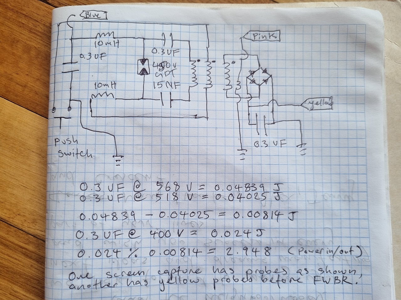

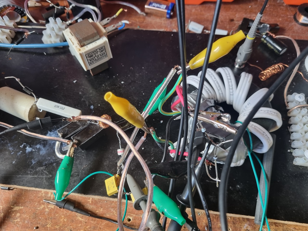

Thanks for this thread. I was inspired to do some experiments and I am excited to see promising results. All my experiments so far have been with single capacitor discharge events. Just manually filling a cap and then manually discharging through various circuits. Attached is a schematic and photo of a messy circuit on my bench.
I believe that the input capacitor, although it discharges fully, is only furnishing about 1/3 of the joules that end up in the output capacitor, and the other 2/3 end up shorted across the chokes and GDT. I believe that if the push switch was replaced with a switch that opened when the GDT fired, then this would be over unity.

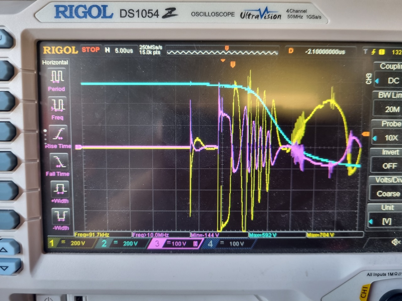

Let me get this right, the blue trace is the input capacitor which is 0.15uF and the yellow trace is the output capacitor which is 0.3uF? Are you sure? Can you double check?
Sandy posted this 03 December 2024
Hi All. I apologise. Today I found the cause of my results is faulty oscilloscope. No overunity! Sorry to waste your time! Kind regards, Sandy.
