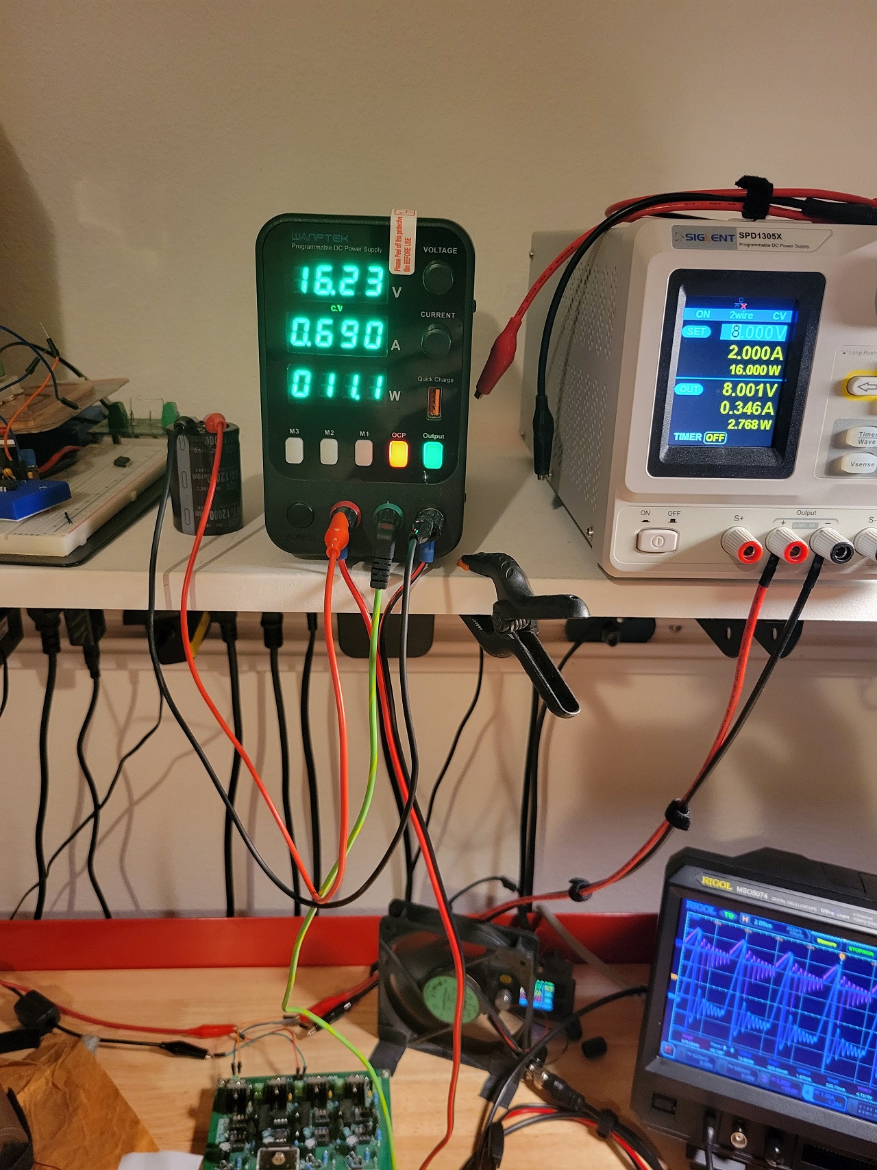

The output on the load isn't great, but thats not what im showing this for. While tuning I realized my powersupply voltage started to increase. It is set at 16v, and while hitting certain frequencies, it goes to 16.23V while the input current drops about 20ma. Maybe helpful. Freq = 333kz, duty cycle 23%.

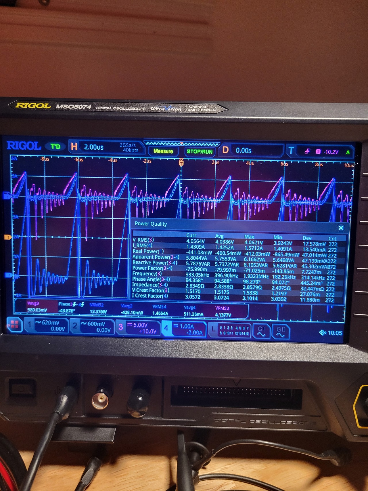

Also I got a new scope, having fun and learning it better. The picture shows a Power Analysis function available on the scope, keep in mind this function to used to measure AC input line, though here on the output it shows im using -463mW of Real Power to my load, im still learning why this is or what it means.

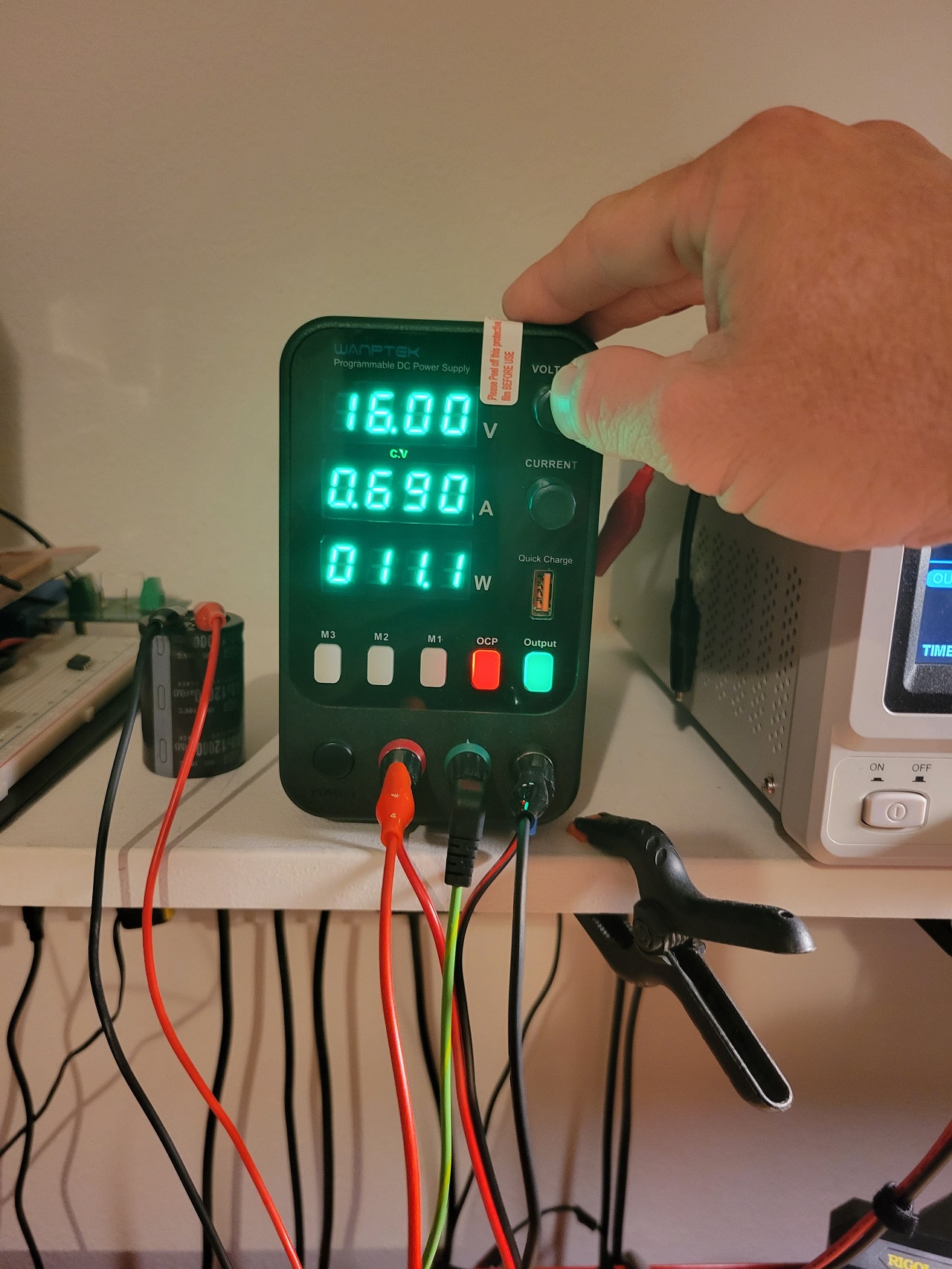

This is clicking button on power supply to show its current set voltage while its running:
This is the voltage its displaying its putting out(ive seen this on some boost converters in the past when a cap wasn't discharged and output was shut off, it shown the capacitors charge until it depleted) :
And here is the scope shot with voltage across the load(measured with differential probe), and current through the load(measured with current probe):

Yes the power analysis software package is very interesting, when I look at your last image everything corresponds very well with Cos Phi, the values are exact when we do the calculations manually to double-check.
The software calculates in real time the correct average values on which we can rely. As you may have noticed when Cos phi exceeds 90 degrees, nothing is consumed at the source and there is even, as in your case, a small negative 460.5 milliwatt who is returned to the source. Lots of pleasures in perspective.
