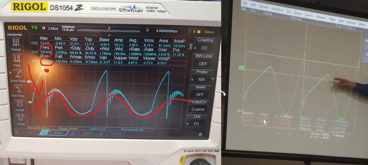

In this oscilloscope examination, I was curious as to where and how the two coils resonate. Or how I see it. Or is it visible at all.
When the current drawn from the power supply is the lowest, the CH2 (blue) channel is at a higher voltage. But this is the coil with less turns. Thus, it should be smaller by default (or at a lower frequency). So when this coil is at a higher voltage, it works on the other coil and charges back to the power supply. (here I deliberately did not say L1 or L2 because only the principle is the point, but this still awaits further investigation)
In some cases, the hump characteristic of parametric excitation can also be observed in the measured signal. Vidura alluded to this in one of his comments.

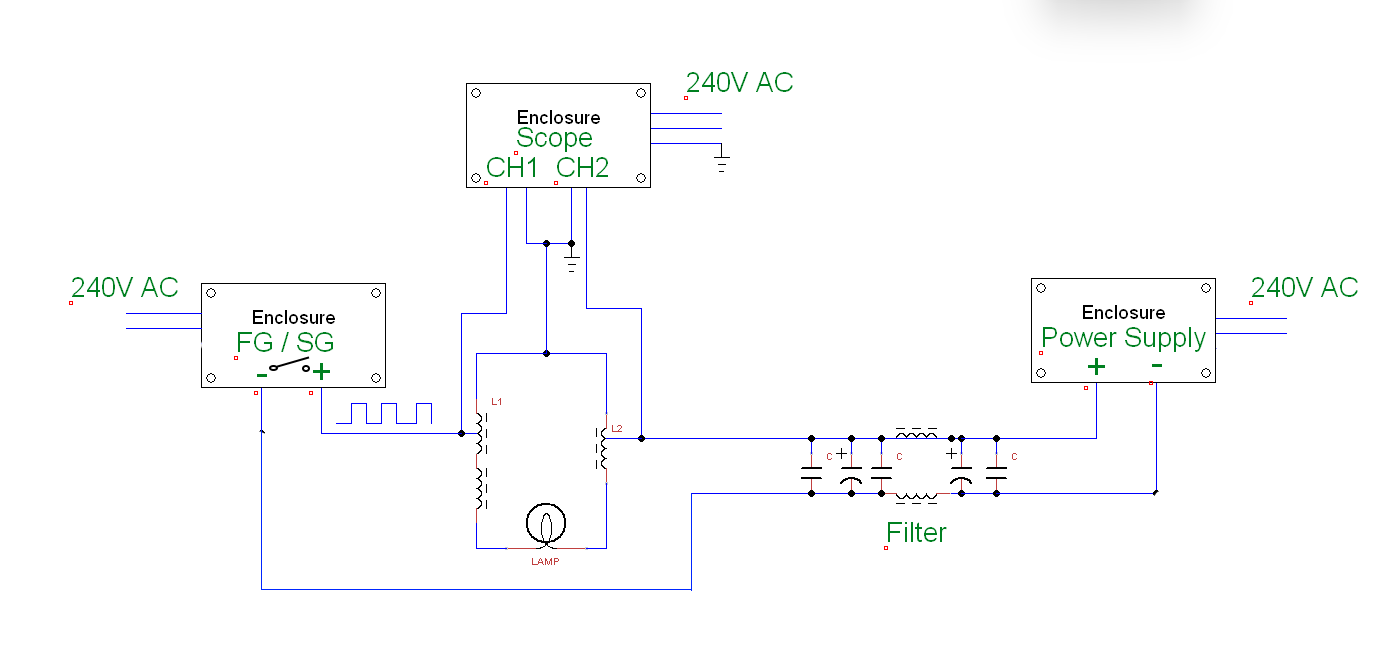

Itsu.
I have attached the drawing in video form (so it's easier). So grounding is not connected to anything. Only the oscilloscope receives the mains ground. The power supply (or maybe battery) is not grounded. The H-bridge controller is not connected to mains ground. It only takes one impulse, that's the point. This could be done with a 555 timer or an opto-isolated drive. Or as you use it in the first drawing you provided.
I used this because it's handy.
Thanks.
Itsu posted this 29 November 2022
Atti,
thanks, i have removed the grounds from the FG/SG and PS and connected the minus/return from the PS and FG/SG.
So the connections should be like this:
Itsu

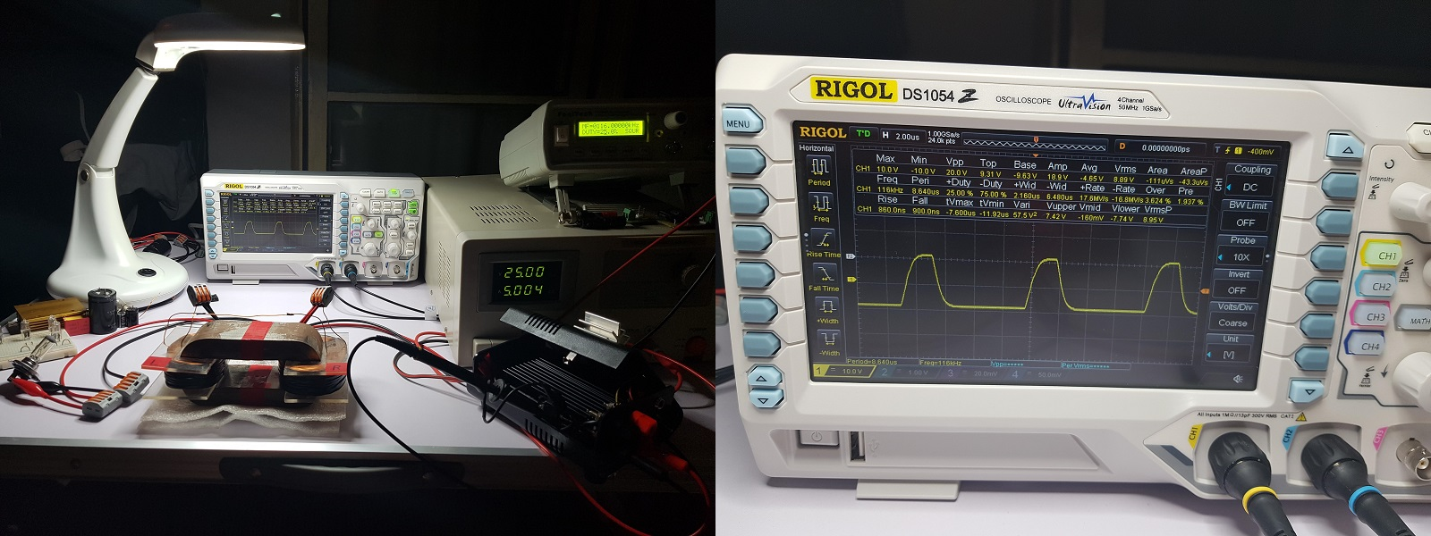

According to the specified parameters, I tried the connections with several ferrites and transformer iron.
I also replaced the control circuit (Tl494 control-Tc4429 fet drive) The gate signal was not distorted. The result is the same, so the phenomenon is not only with the H bridge drive.
At the moment, it is a question for me why only the Amcc core behaves this way the best. It also works with a CRT line diverter ferrite, but it is not so spectacular.
 As you can see, when the earth is placed at a certain point, the neon lamp lights up everywhere. In this case, the parasitic capacitance affects the current drawn from the power supply. That is, it decreases.
However, in this case, the Fet heats up a little. If the neon lamp is not lit, there is no heating. So this is one of the signs to look for.
Also, I have a question (and this is probably the second setting to look for, or the one I uploaded in the Cap1 video at 0:22) of the wavyness in the Fighter setting.
At first I thought the Fighter's distorted mosfet gate signal was causing the problem.
But now with the use of the new control, I could see that this should not be a problem. In other words, no one has to find fault in the control. A ground loop is not possible, this should not be a problem either.
Larger volume Amcc core with higher inductance can give better results.
Unfortunately, I currently have no way to test the settings with such a core.

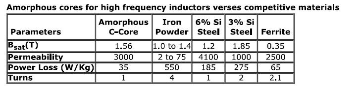

Remember that the saturation point of a standard ferrite is around 0.35 Tesla and the AMCC core saturates at 1.56 Tesla, there is a large margin before reaching saturation for the AMCC type core .
in addition to having better permeability

Atti posted this 04 December 2022
Hi editor.
As you could see in the video. If the scope is not connected, the neon light does not light up.
In this setting. It could be another phenomenon.

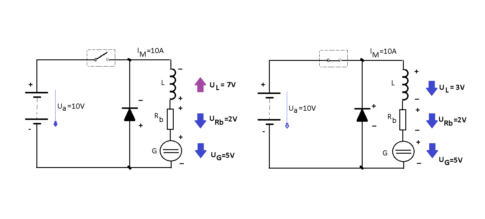

  Let's examine the connection based on the figure. It is a DC motor.
But we can also examine the operation of the MPPT charge controller used in photovoltaic systems.
Here is a simple orientation with the oscilloscope:
In the case of a transformer, at 6:10.
Here you can see how the current of the swing diode develops. There are times when it is higher than the current drawn by the power supply. How can this be and what does it result in? Notice the process.
-Let Ua battery voltage be 10V.
- Assume that the Ug generator voltage is 5V.
-The instantaneous current is 10A.
_The 0.2ohm Rb has a voltage of 2V.
-At the moment of switching on, the motor inductance, which in our example is 3V, creates a counter voltage (UL)
At this moment, this means that only 7V battery voltage is connected to the engine. This apparent loss of 3V accumulates in the coil in the form of magnetic energy.
Note the opposite processes. Let's see what the generator is and what the consumer is.
We can notice that the current of the oscillating diode can be much higher than the magnitude of the supplied current.
If the magnitude of the voltage in the phase also changes, the charge back towards the energy source is created. The higher the voltage, the higher the recharge of the network. Let's see the opportunity.
