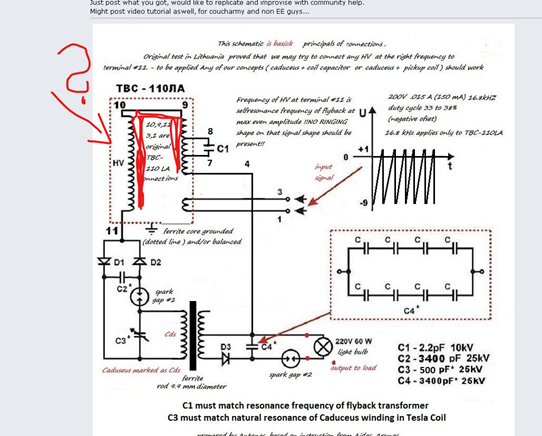

I just wanted to look at a few things in this simple compilation. As you can see, it's almost the same drawing as the one that Fighter gave us. I played with it a bit.
The core is a tiny Amcc20. Frequency between 90-110Khz. Filling factor 50%. Supply voltage between 20-30 volts. The power supply L-C filter works well. Roll ratio 1:2

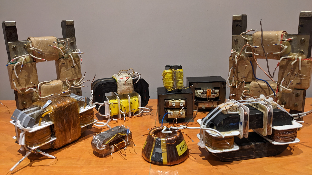

It would definitely be necessary to use an iron core with a larger volume and a coil with a larger surface area.

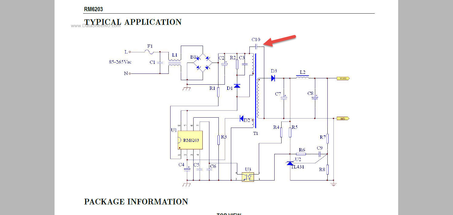

Coupling problems can also occur in switching mode power supplies or function generators. This can be caused by the installation of the so-called cooling Y condenser in some cases. This is also located in its internal power supply. (but not always!!!) It is mentioned in this forum. Image:
https://www.eevblog.com/forum/testgear/feeltech-fy3224s-24mhz-2-channel-dds-aw-function-signal-generator/225/

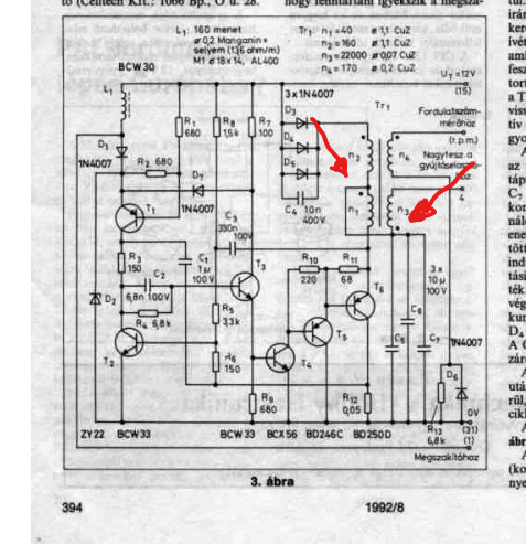

Notice the connection pattern of some inductances:
