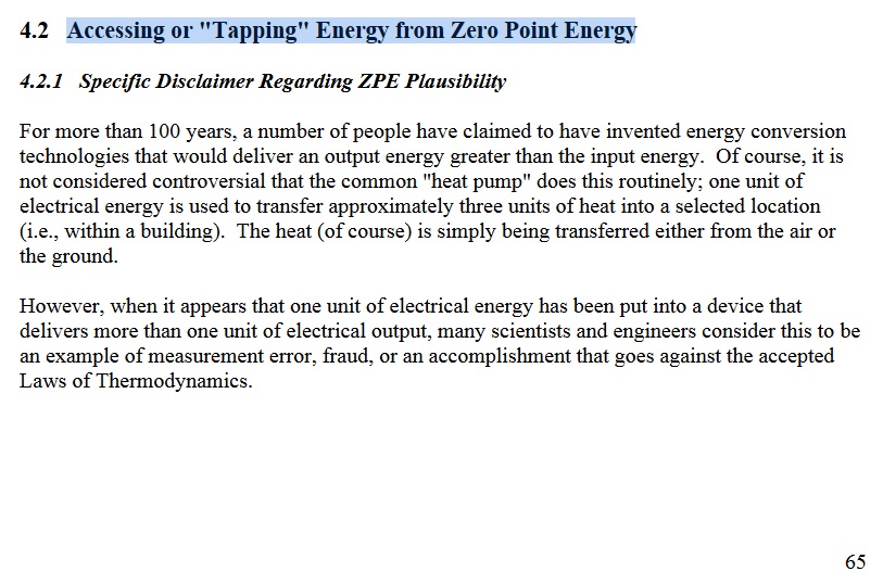

Another great document to read is this one by David S. Alexander MSE Technology Applications
wrote for NASA
Fighter posted this 03 November 2023
Very interesting document, thanks Jagau !
I must read this section starting from page 65:
