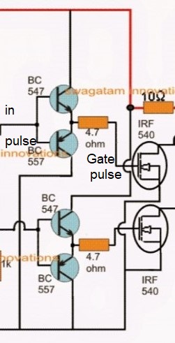

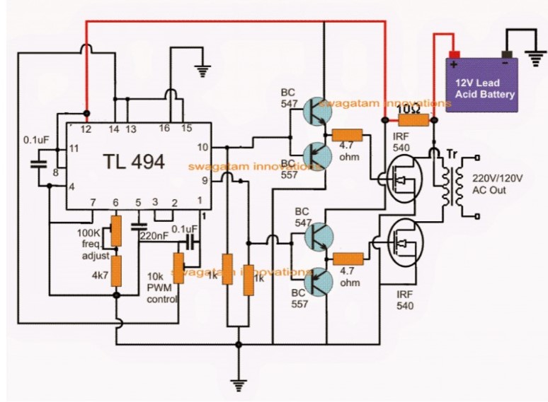

To give you an idea of construction here is a complete plan of the TL494 oscillator with two push-pull outputs which controls two N Mosfet , one after the other.
You can see the Totem Pole configuration at the output with an NPN and a PNP which activates each of the two N Mosfets with 4.7 ohms resistors at gate.
The totem pole configuration allows the activation voltage, On time, of the mosfet gate to be quickly increased to a higher voltage (NPN), which prevents the mosfet from heating up.
In addition, the other PNP transistor discharges the gate, OFF time, very quickly.
I built this oscillator circuit that use frequently,  design by Swagatam Ing. and it works wonderfully.

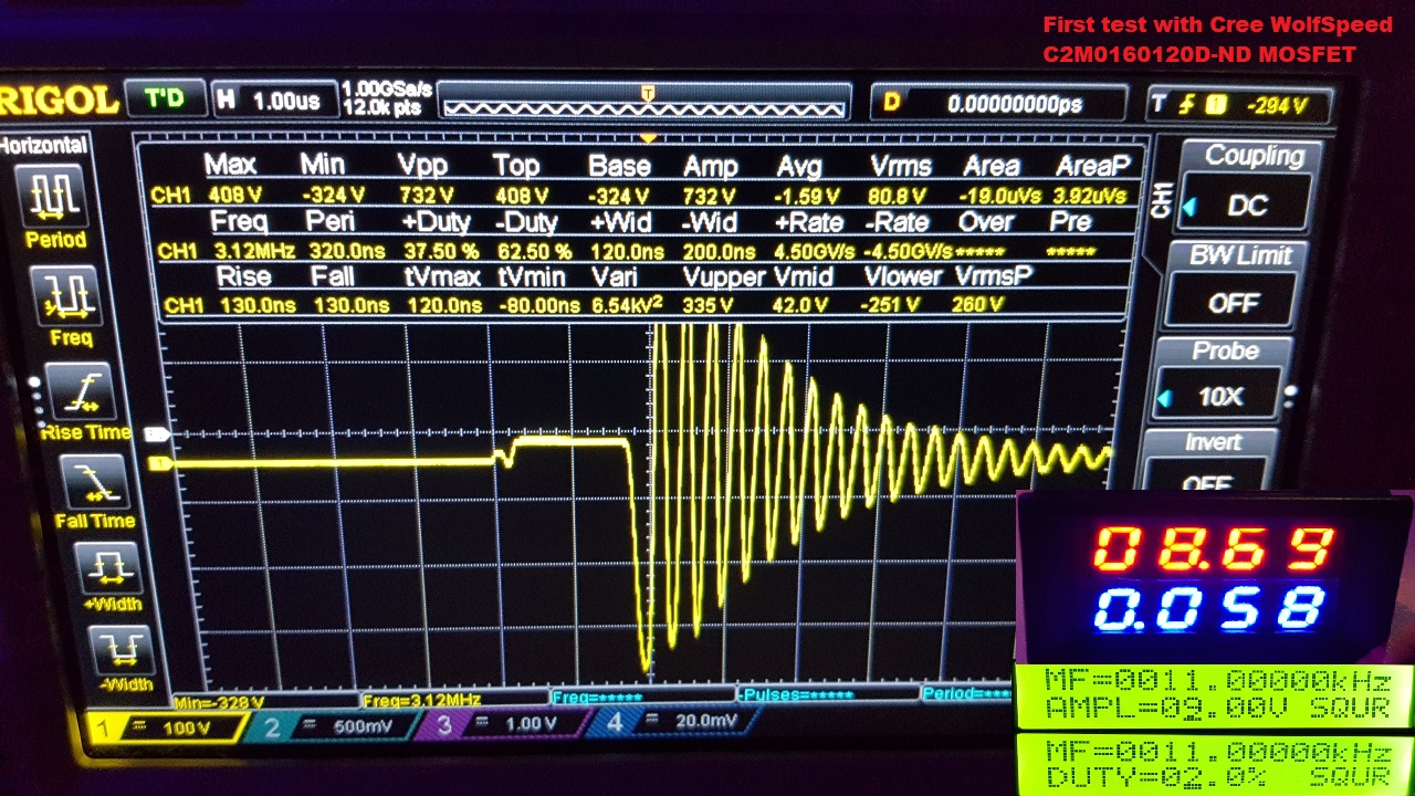

Yesterday evening I upgraded the device's MOSFET to C2M0160120D-ND.
Just by doing that the Vpp in the coil increased from the previous 500 Vpp to 730 Vpp and current on input actually decreased from the previous 67 mA to 58 mA !
It's amazing what these Cree WolfSpeed MOSFETS can do, no wonder they're expensive !
Here is the screenshot from the scope with the input parameters:
And here is the video showing the device working, checking that the coil is still working in resonant mode and also the effect of the device on the Micro-Generator:
Seeing the 732 Vpp after the test I was thinking I passed the limit of 600 V my scope can withstand and I was afraid I was at risk to damage my scope. Because I was never in the situation to have a Vpp so high, with ZPM the highest Vpp was about 230 so then the scope limits was not a concern.
I asked Jagau about this and he told me the 600 V scope limits are actually referring to Vrms not to Vpp.
Thank you Jagau for the clarification and for your help !
So I can continue to work with this new 730 Vpp range without the risk to damage my scope.
Considering the voltage booster alone is consuming 30 mA, now basically we get 730 Vpp with just 28 mA consumed from input which is putting the device in the right category to be able to experiment with the Don Smith Effect.
