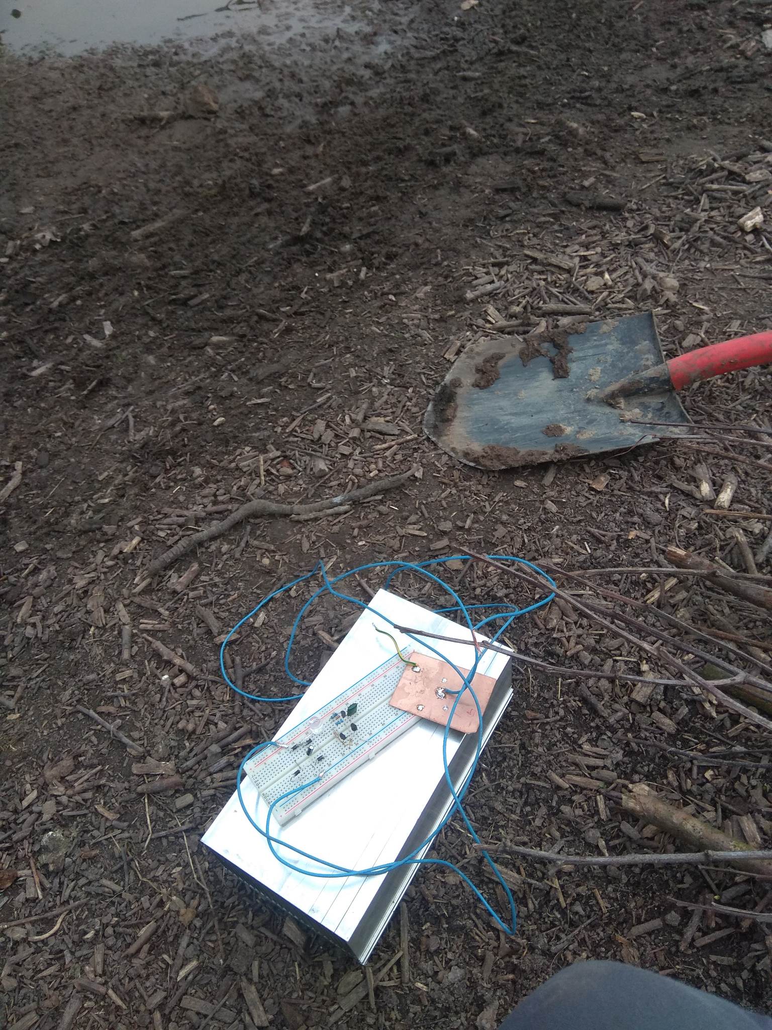

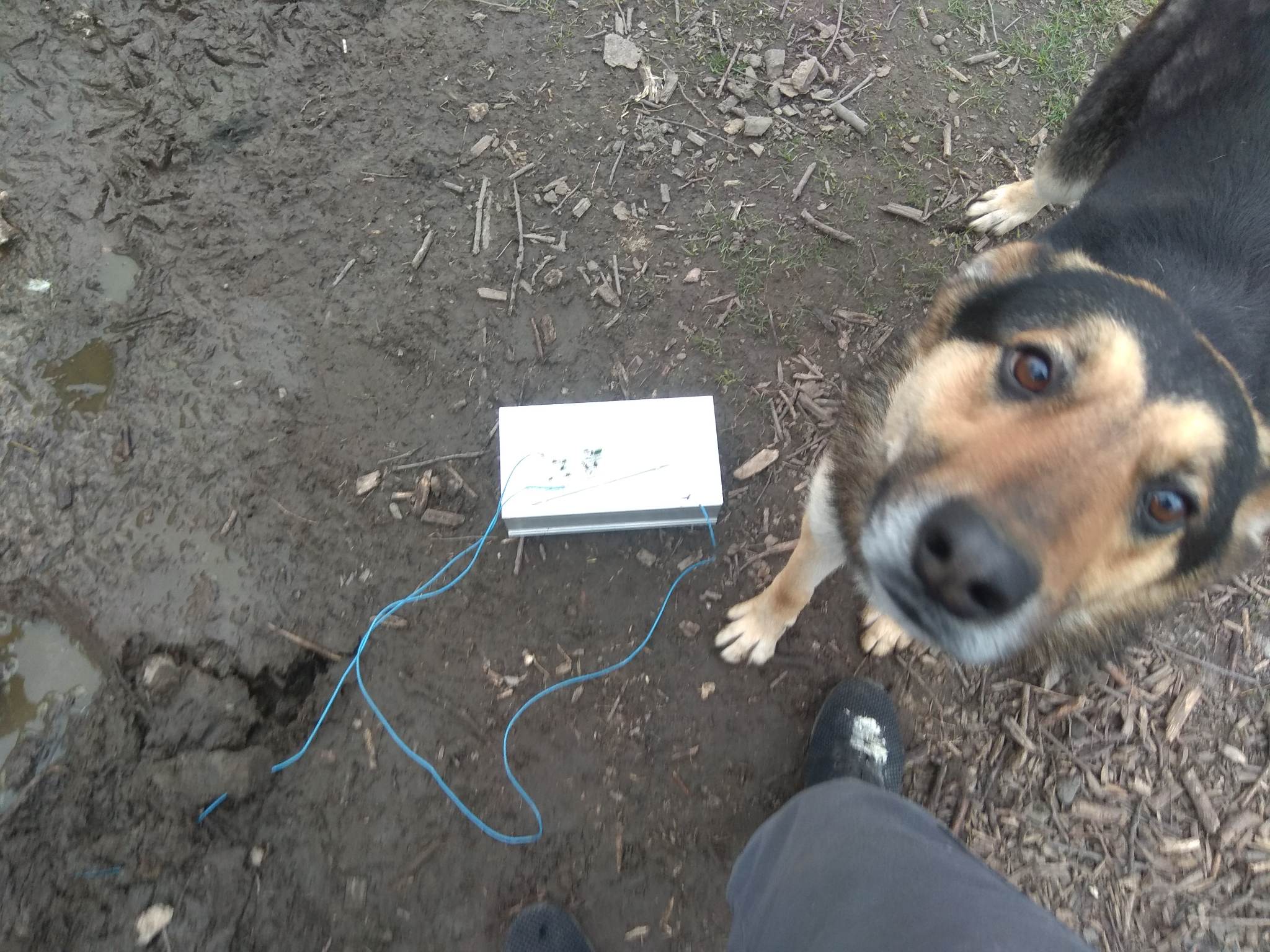

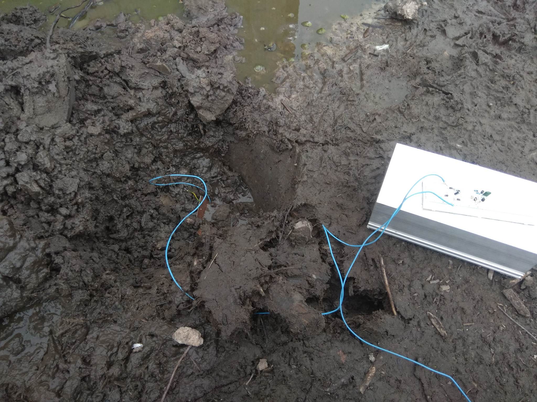

This is my replication of Jagau's Micro-Generator:

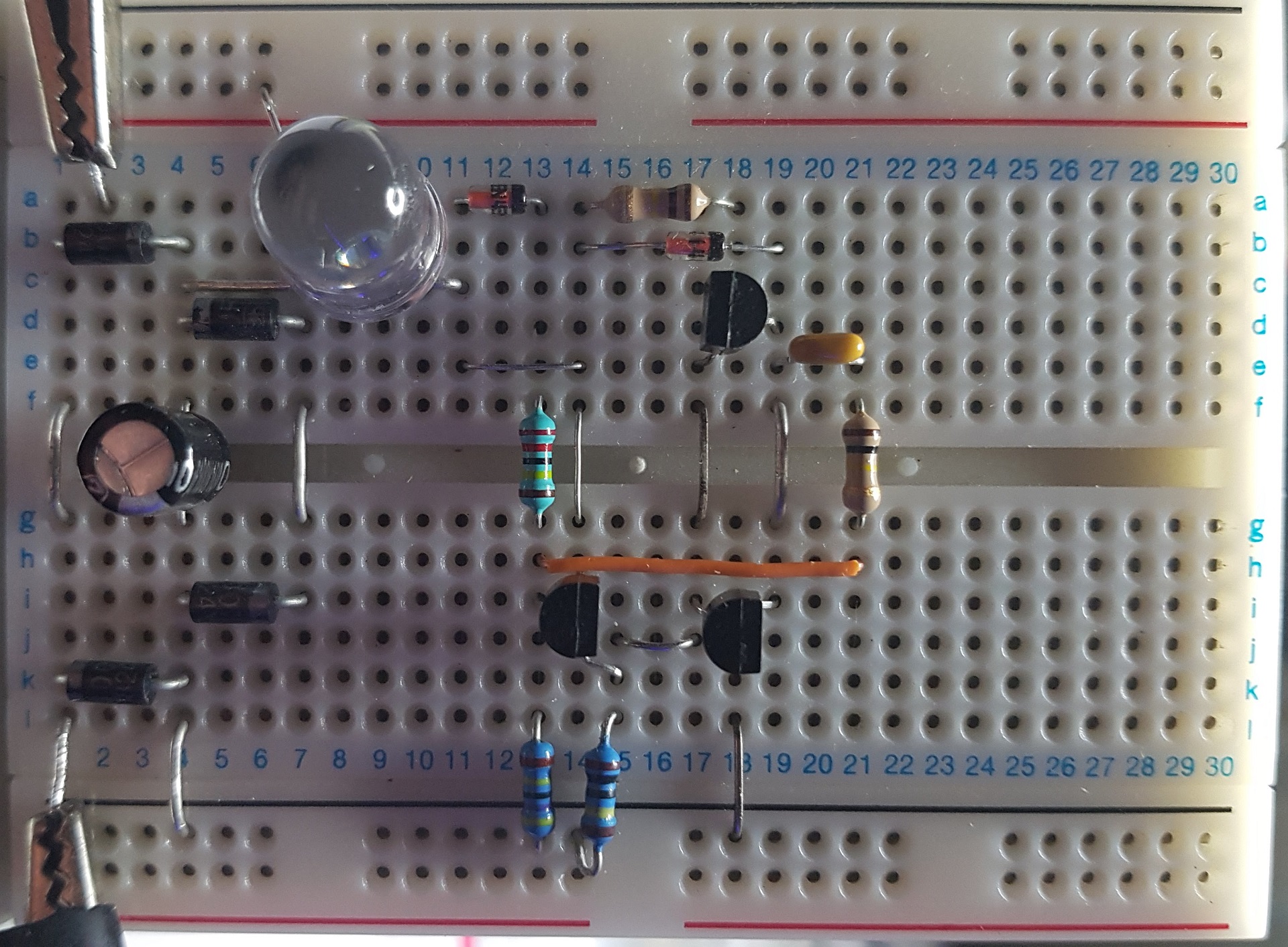

The shipment arrived and I replaced the temporary resistors in series:
Now all the components are as in the specs.
I noticed a slightly decreased frequency of the pulses which is normal.
For later references I'm posting a small video here with the current behavior:
This replication on the testing board will be the platform for future experiments.
The rest of the components will be used for building the miniaturized versions on permanent boards with soldering.

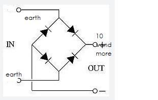

If you would like, would you be so kind as to give me a little sketch of what you are saying, I will find it easier to advise you.
As a starting point if you take just 4 diodes connected in a bridge with no circuit, the two AC of the bridge to earth, you should have a DC at the output of the bridge of 10 volts and more. To have best resutl diode shouldbe very fast diode like UF4001, small signal diode as 1n914 do not work well.
