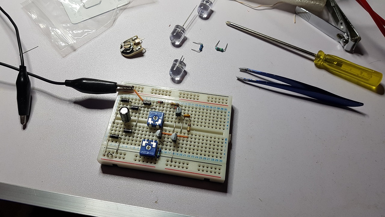

This is my replication of Jagau's Micro-Generator:
The circuit for those who want to do it.
If you need advice, just ask, I'll be happy to help you.
Fighter posted this 30 March 2023
Mine is working for one month already:
The 4.7M variable resistor is not connected yet, I'll need some soldering to extend the pin which is in air right now.
For the 2.2M variable resistor, it will be delivered when TME will have it available within a few weeks.
Will be shutdown briefly while making changes and experiments related to a possible virtual grounding in air.
Also I need to start working on the miniaturized versions on permanent boards with soldering.
Thank you Jagau !

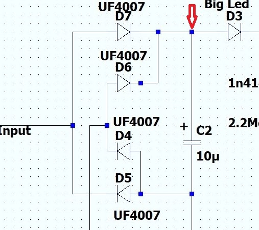

The problem is I don't know exactly what component should I check first. The 1N4148 diodes ? Any of the transistors ? I suppose the UF4007 diodes are okay.
Jagau, where should I start ?
Jagau posted this 15 April 2023
Hi Fighter
As you say, the circuit should not be without a load, the voltage can rise very high and burn the LED. Another example the ZPM without charge is not a pretty sight.
Started with this,  the circuit on the left, up to the anode of the LED is the circuit that powers the whole circuit and makes the LED light up, so you must have a positive voltage where I put the red arrow, just at the capacitor . If you have nothing go no further the circuit on the right is just a switch. So if there is no voltage, one of the diode bridge UF4007 is faulty.
to avoid other problems C2 must be very low in voltage.
Fighter posted this 15 April 2023
Yep, I'll try that.
Thank you Jagau !
Yes, I had nothing at that measurement point.
You're right, one of the UF4007 diodes was affected too. Also the initial LED is gone.

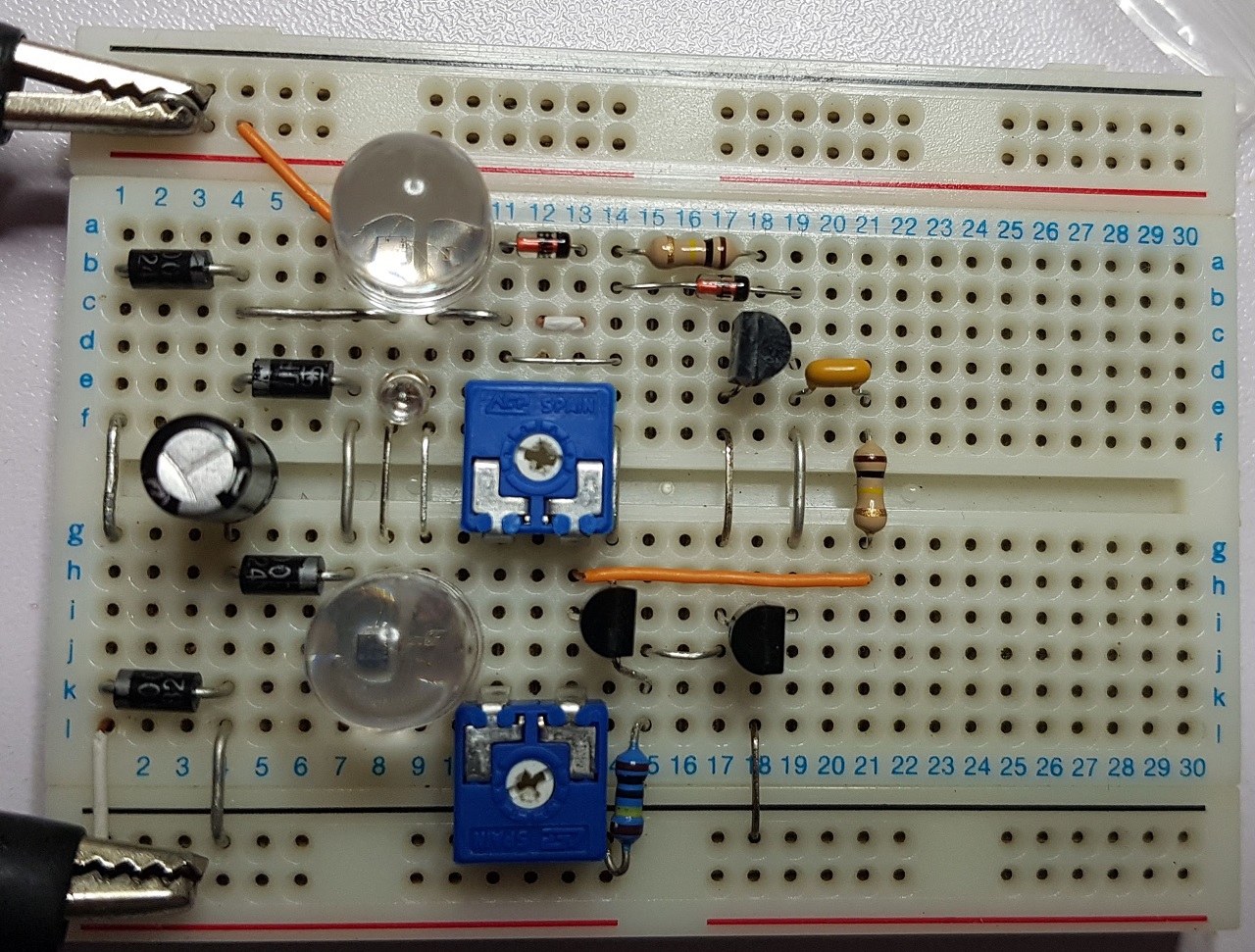

Sorry for the delay, I'm gonna present the new layout of the device:
I needed to do some modifications on the testing board to accomodate the variable resistors but the electronic schema is the same as presented by Jagau. Just instead of the 2.2M and 4.7M fixed resistors I have 2.5M and 4.7M variable resistors.
I played a bit with the variable resistors in order to learn the device's behavior. Basically I have full control of the voltage where the electrolytic capacitor is discharging (luminosity) and the frequency of the pulses.
It's a tradeoff between pulses luminosity and frequency. You just decide what to do with the energy. If you want higher luminosity that means you'll have lower pulses frequency. Also if you want to distribute the energy to more LEDs (as I did in this experiment) you can lower LEDs luminosity or the pulses frequency.
If you try to enforce the device to have pulses with high luminosity and also high frequency the device will cease functioning temporarily until you return to a certain balance between these two parameters. Basically the device will tell you: "not enough energy for what you're asking me to do, what about a bigger metallic surface on input in order to do what you're asking me to do ?". 🙂
As you may notice there is also a very small LED on the board. That is a permanent load and the solution to avoid the charging of the capacitor to dangerous voltages when I want to to change the LED (or LEDs) on the output and accidentally burn the components of the device like it happened to me. That little LED will keep discharging the capacitor even if there is no load (big LEDs) on the output. I tested this solution and it works.
I temporarily added a second big LED, I just wanted to push the limits of the device. I wanted the same luminosity as it was with just one big LED so as a result the frequency of the pulses is much lower than before.
