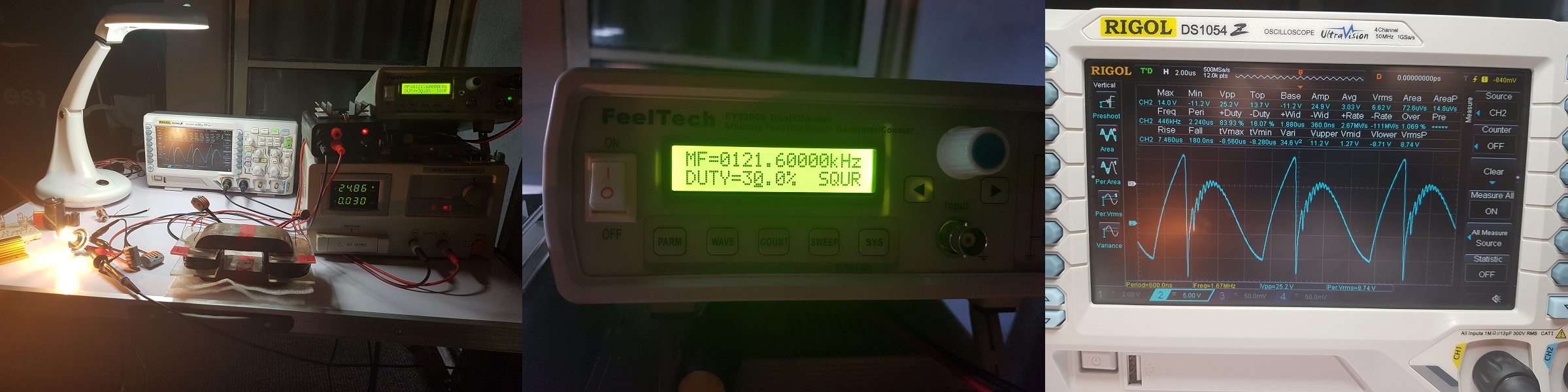

I dont want to upset you Itsu im trying to help but when you say you have the same as jagau im not seeing it.
These are the two images i saw, one shows a flat sawtoooth with a very sharp transient shown by the shap peak on the end of the switch and the other is curved with no transient or ring down after the switch. Why is this? am i not looking at the right pictures here.
There is clearly an effect here.
BMW,
i am not easily upset, i am doing this kind of stuff since 2010, so i have seen all and more you can imagine coming by since then.
OK, we are looking at the right screenshots, and especially the green traces.
We see the same triangle shaped forms (i hope for you), but indeed there are differences as is with all different devices, none is exactly the same.
I do not know the values of Jagau his coils or any other detail of his circuit (does anyone else?), but i use the same voltage (24V) and the same load (bulb 120V / 4W).
But my bulb is only dimly on (536mW) while Jagau shows his is full on (4W), so there is a difference there probably due to the coils.
His input current is obviously stronger (292mA rms) then mine (52mA rms) and i can imagine there will be stronger transients and a sharper triangle shape.
But the basic form is there, the triangle shape IMO.
Itsu.

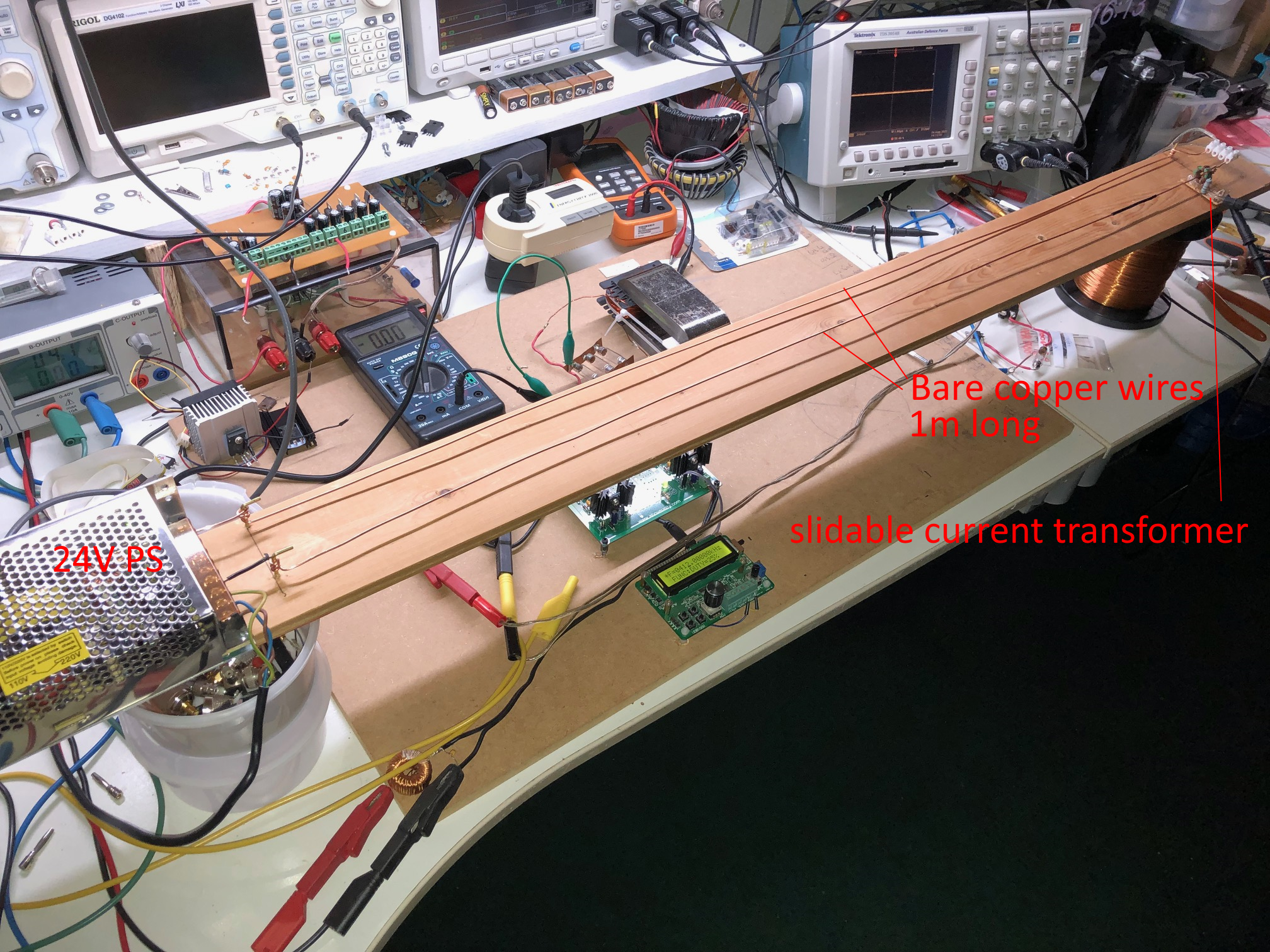

I put together this contraption:
It has a 1m long stretch of dual bare copper wires directly attached to the 24V switch mode PS on one side and a connection point to the normal device input wire leads on the other side.
There is a current transformer on the minus lead which is slidable across the length of wire.
This way i can make some rough current measurements and with the DMM / scope probe i can make voltage measurements across this length.
Some initial testing shows we have a steady triangle pulsed current across the 1m length, so no indication of a standing wave.
I did find that the voltage across the 1m does fluctuate from 24V DC (some rippling on it) at the PS side to 34V on the opposite side, especiall above 400kHz or so.
This raised voltage only occurs from about 3/4th from the PS side, and only then when the Fluke 179 DMM is put on top of the PS.
This 34V on 3/4th of the length will increase with used frequency of the device, but when picking up the Fluke DMM the voltage starts to fluctuate and go back to normal (24V) when hovering above the 3/4th part of the length.
So, it seems there is no standing wave, but the increased voltage seen on the fluke is caused by the high frequency noise disturbing the Fluke (specified for 20kHz or so) and setting it off.
Using a scope probe to do the same measurement across the 1m length confirms no standing waves and shows a steady voltage across the length of wire.
I will do some testing today and shoot a video.
Additional measurement suggestions are welcome.
Thanks,  itsu

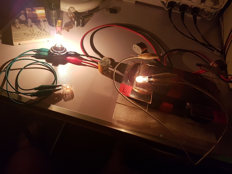

Now you try to say there are no standing waves on the output of ZPM.
First of all you don't have a successful ZPM replica running.
Maybe your device don't have standing waves on output, here are standing waves on the ZPM's output:
And there is no "high frequency noise disturbing the Fluke", as you can see there is no Fluke in this photo.

 At the start of the replication there were signs that you were begining to get the effect to appear on the scope shots and you have literally "filtered" that result out.
These are not the same waveforms, its plain to see, look at the thickness and striagtness of the slope and the lack of the tell tale inductive kick.
One is a curve and the other is not, the effect is not pronouced enough.
Your coils are not opposing each other strongly enough, there is either not enough induction, input voltage, or the output (which also includes the input in this circuit) impeadance is too high. It really is that simple, change your circuit and see the effects change, no ammount of winding coils will solve the fundemental and simple problems you have.
You say the output power is lower than it should be, then turn up the voltage.
