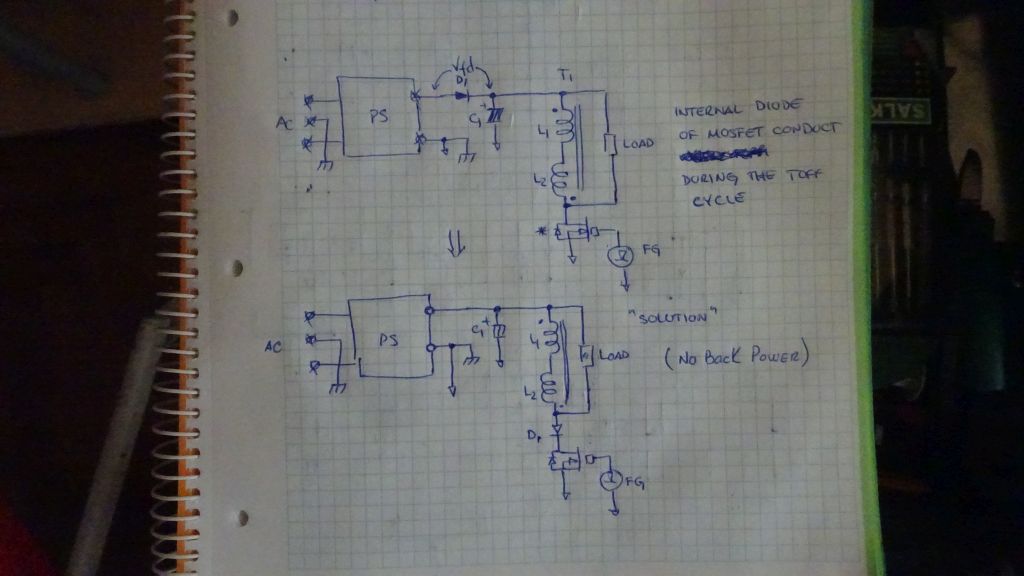

YoElMiCrO posted this 09 November 2022
@ Fighter.
It is more complex than what has been said, but it is not inexplicable.
In the shortest possible time
I will try to make myself understand better, I am not good at explaining.
This image explains why
the tension rises in the terminals of the power supply.

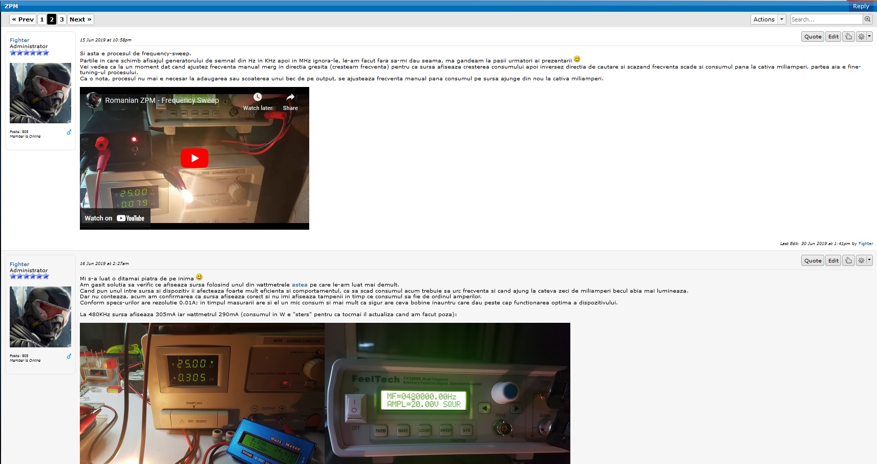

Fighter posted this 10 November 2022
I just realized in the ZPM thread in the old aboveunity site I didn't added the wattmeter's specs.
I have them in our secondary forum in the ZPM thread in Romanian language in 16 June 2019 when I was exchanging information with Cd_Sharp about the current stage of the ZPM development:
So I'm adding them here for later references:
Itsu posted this 10 November 2022
Quoting:YoElMiCrO
@ Fighter.
Thanks YoElMiCrO,
nice thought, it says  "No Back Power" next to the diode, so this diode would prevent any power to return to the DC source?
That also might prevent any disturbance inside the DC source, so would be nice to try.

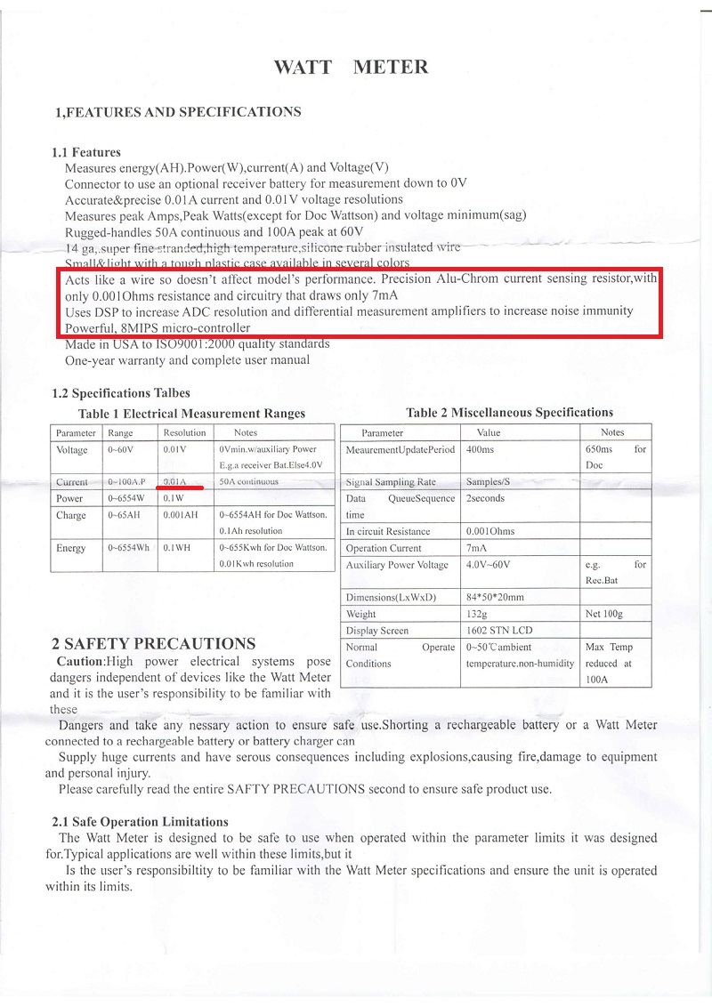

Replying To: Fighter
thanks for the info on the Watt Meter, but should it not also mention it is a DC watt meter only?
I read about the 0.001 Ohm csr  which will surely has some inductive reactance added when running at 604kHz
Not sure how it will be influenced by the AC or pulsed DC signal of the ZPM.
Just a tought.

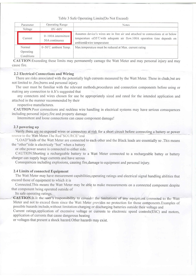

But to my surprise, no resonance was seen over a 0 to 5MHz range similar as when running from the battery.
That's very strange indeed, I'd wish to have that replica on my testing table to see what's going on with it...
Not really, it's a pulsed DC wattmeter, there in the specs it says "Current: 0-100A Intermittent" and "100 A peak".
It can be used for drones brushless motors and it's doing a good job, it reflects very well the consumption specified in the motors specs.
Something off topic but just for fun, this is just one of the FPV drones I've built and flew some years ago 🙂
Now about brushless motors: "Brushless DC motors are similar to AC synchronous motors. The major difference is that synchronous motors develop a sinusoidal back EMF, as compared to a rectangular, or trapezoidal, back EMF for brushless DC motors. Both have stator created rotating magnetic fields producing torque in a magnetic rotor."
So just as ZPM, these motors are using pulsed DC and are sending back to the source BEMF and the wattmeter can handle these pulses and pulsed consumption.
Notice the phrase: "Acts like a wire so it doesn't affect model's performance... Uses DSP to increase ADC resolution and different measurement amplifiers to increase noise immunity. Powerful, 8MIPS micro-controller."
All these would not be necessary for plain DC consumption.
And I can't find this info anywhere but considering all these above I think the resistor inside is non-inductive, at least it should be considering the environment the wattmeter is designed to work in.
These are the reasons I bought 3 of them for using in my experiments when necessary.

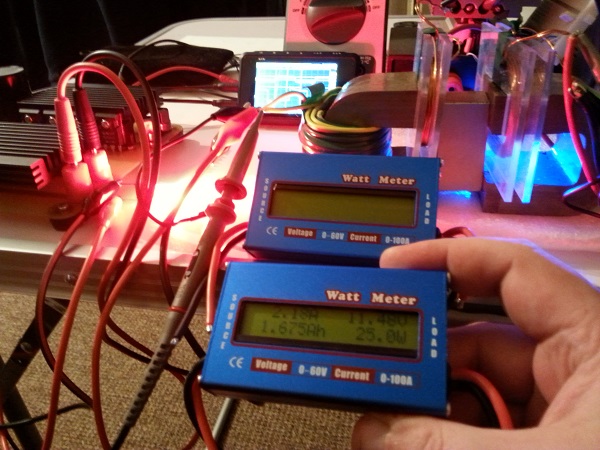

Here is a photo of two of them when I worked on Bearden's MEG replication (and experiments with modified MEG versions like you can see in this photo), a device behaving like ZPM (pulsed consumption and pulses sent back to the DC source):
