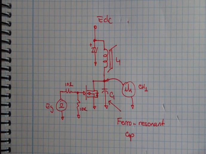

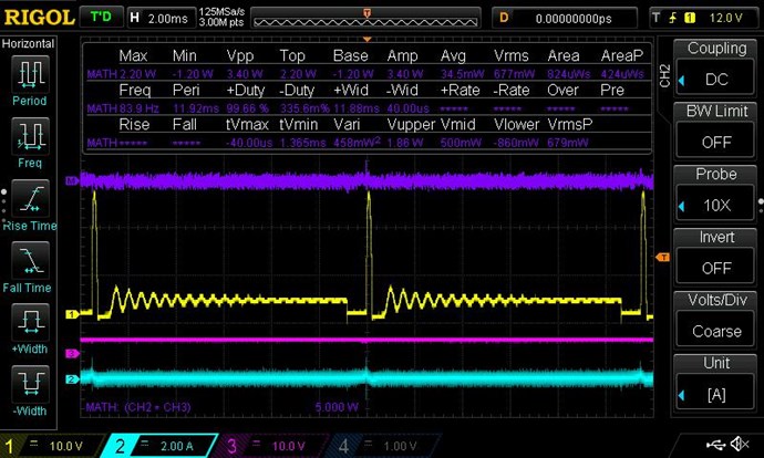

Today, I am going to replicate YoElMiCrO's circuit shared above, the same circuit Vidura and Jagau have also replicated:

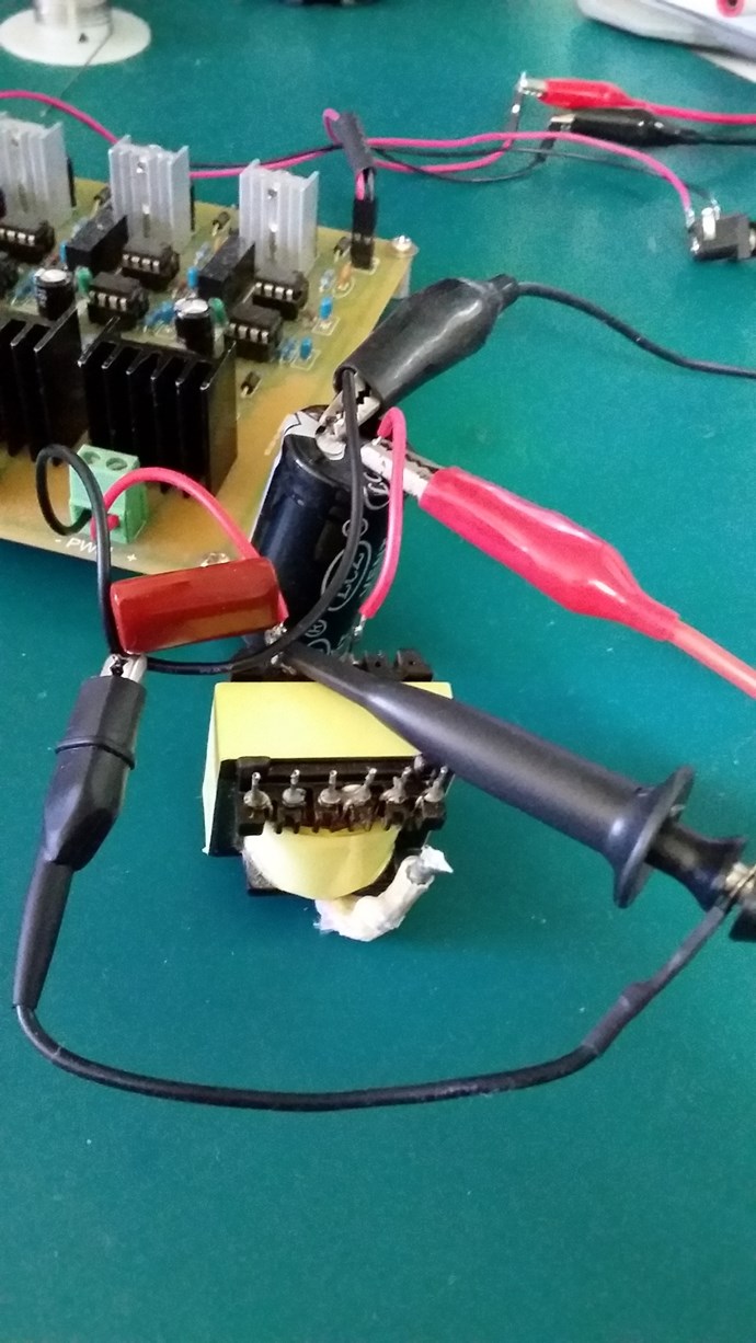

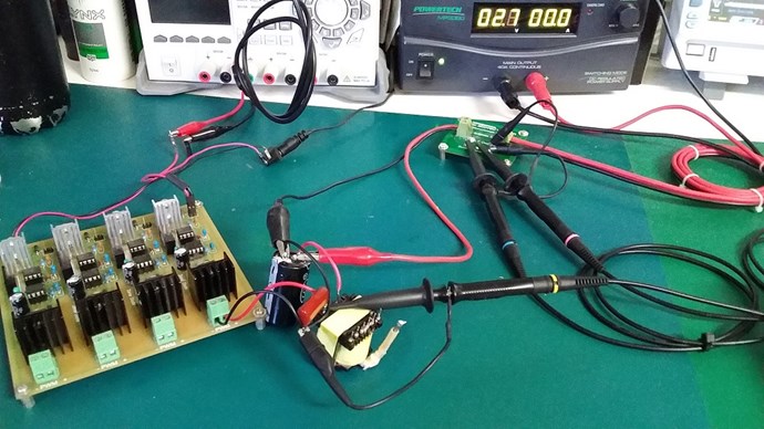

Here is my simple setup:

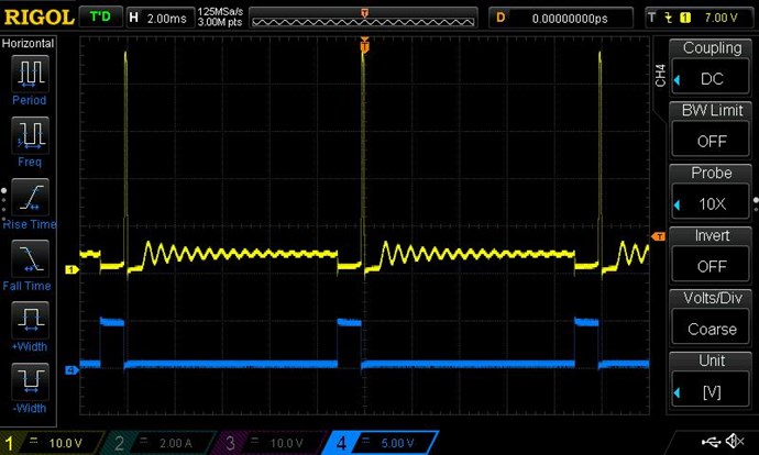

Here is a Scope Shot, with Input Measurements:
Where:
- Yellow is the probe on the top of the ferro-resonant cap.
- Teal is Input Current.
- Pink is Input Voltage.
- Purple is the Math Calculation V x I.
Frequency is 87Hz, Duty Cycle is 7%

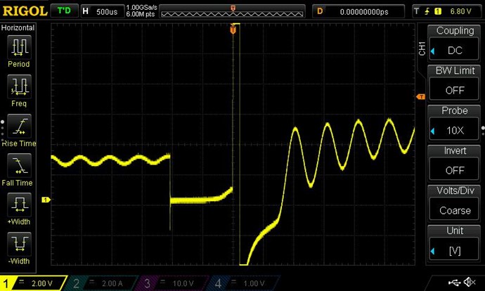

A Close up:

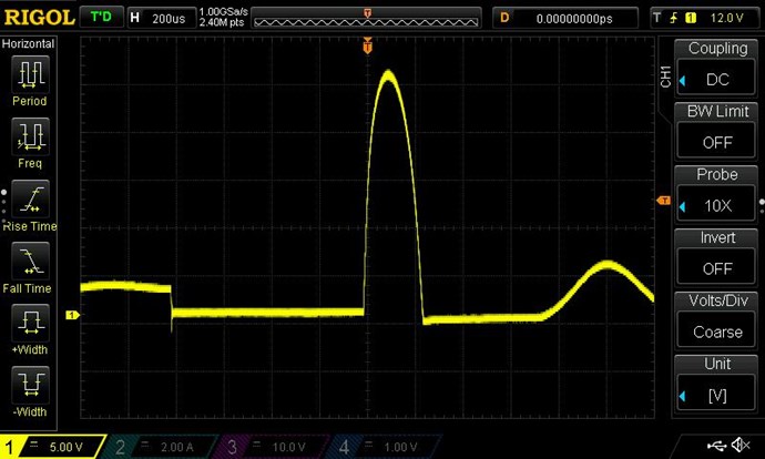

The pulse seen there is approximately 27 Volts, from a 2.7 Volt input. Whats "Generating" this big pulse? I cant help but think T = R x C, the Time Constant of the RLC Network!
I have adjusted the Duty Cycle from 7% to 10% a little and zoomed in some more:
Here, the Input Signal vs the Ferro-Resonant Cap or the Drain of the Mosfet:
I believe with some work, and adjusting the capacitors and Inductance, we can make this effect much better and much more pronounced!

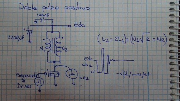

Hi all.
@Jagau.
Try this arrangement, you should see the double positive pulse
that you want to observe.
If you don't see you let me know.
Thank you all in advance.
