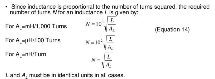

Jagau posted this 26 July 2020
Ok thanks Yo
This is what I wanted to be sure of.
For my part I use a Pot core with this formula that I am sure you know and about which I had already shared the info. However, you must know the inductance factor of your ferrite to use it
I have finished my work I resume my experiments where I had left
Thank you

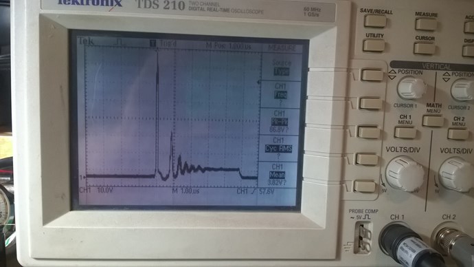

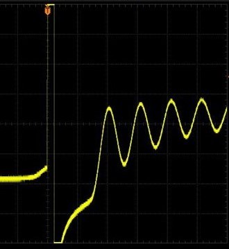

Jagau posted this 10 August 2020
Hi Yo
I didn't forget you, just missed of time.
Yes your circuit produced a double pulse see scope shot at 100khz
N1= 100t
N2=50t
Resonant freq is 1.25mhz but a perfect sinus
Hi UndisclosedMember
we have the same thing with a single coil with a second one we have a second pulse.
