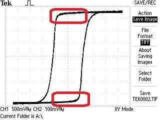

Hi yo
I'm trying to reproduce your demo circuit with the attached circuit
who is named '' Hysteresis measuring arrangement with a digital oscilloscope ''
for those interested there is also a circuit on the same site for analog oscilloscopes and other circuit.
https://meettechniek.info/passive/magnetic-hysteresis.html

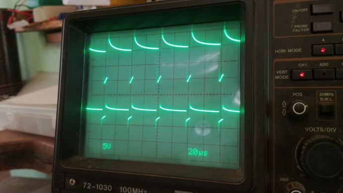

Hi, I have tried the ferroresonant test circuit with a silicon steel core, it works also, as the hysteresis is cuadratic. The wave forms are slightly different, but the effect is the same. Tomorrow I will upload some pictures for documentation. Thanks Vidura

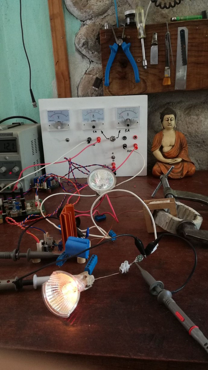

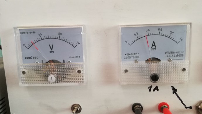

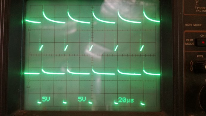

Hey friends,
find here the images from the ferro resonance test with a silicone steel core. It is a part recycled from a stator of a universal motor, a toroid in two halves. Unexpectedly the frequency for the best working point was much higher than in the previous test with the ferrite, around 25khz. Although the core remains cold all the time.
The upper trace is the voltage on the second lightbulb, the lower trace on the mosfet drain.
the last shot current thru the bulb(5A/div) vs. voltage(upper trace)
Regards VIDURA.

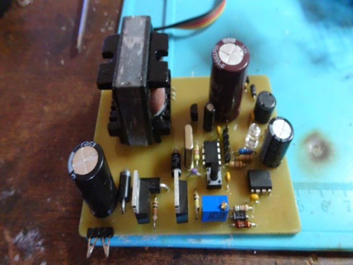

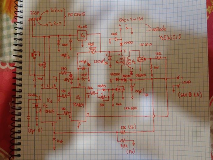

Hi yo
thank you for sharing your knowledge YO, it's very appreciated by everyone here
I would like to be able to replicate this circuit which contains a crystal with multiturn pot and 2 Ic.
Did I miss circuit somewhere?
No, the circuit is not on the NET.
I designed it just to start evaluating if it's how I theorize that
the circuit that owns two Akula TL494s works.
It is not the final circuit, use a PIC for calculation problems,
so I can solve the possible operating points.
Anyway here it is.
Thank you all in advance.
YoElMiCrO
